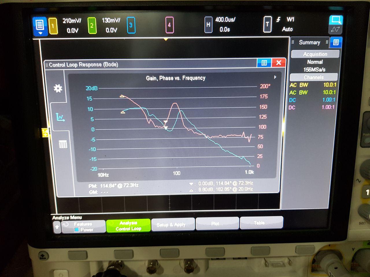

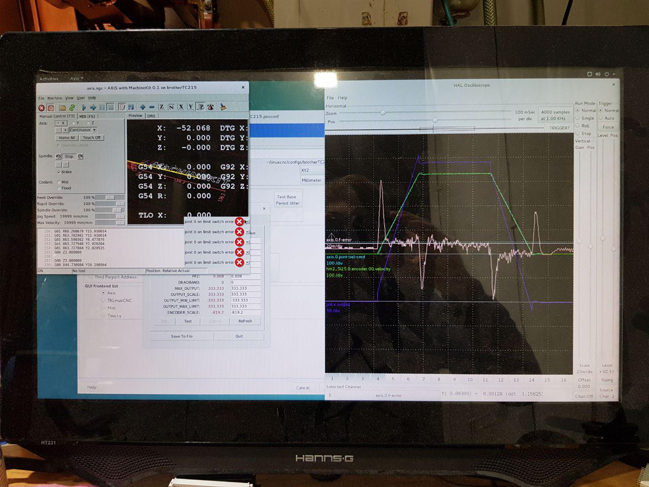

I did further tuning, scaling is now correct and I get values of order unity for FF1. P on the servo amp is 50% and I at 100% of the potentiometer scale. There are however still some peaks in ferror. The are always ~60µm no matter how much D or FF2.
I wanted to know the frequency response of the system, so I hooked up my oscilloscope and did some bode plots. The plots show servo motor velocity (or whatever else pin N on the servo amp is) vs. input velocity.

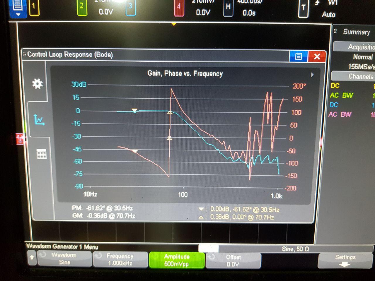

The second plot shows the y axis motor which was left unconnected (had a little less P and I on the amp).
From the plots I would say that there's a resonance between 100 and 150 Hz, maybe it's a good idea to turn P a little down so it's not that pronounced anymore. I am still asking myself whether there's a jerk limit that can be tuned. There is "UZ" and "WZ" as potentiometers. I haven't yet found out what they are good for. Would I be able to see such a limit in the bode plot for small wobble amplitudes and hence only small 2nd order derivatives?

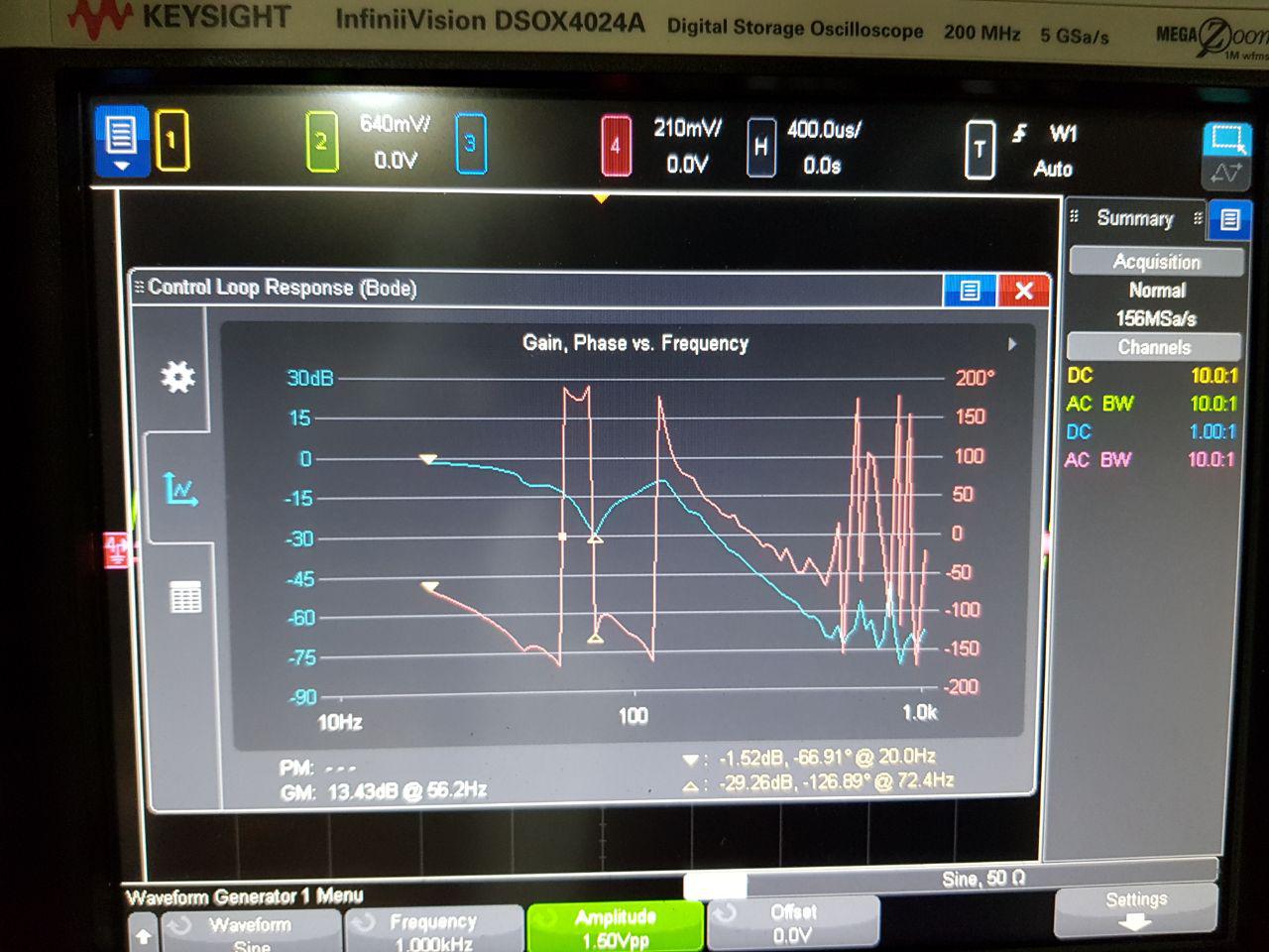

here's another picture of torque out vs. input velocity.

looks basically identical to mine. the cachunk at the start and stop of acceleration, then fairly smooth for linear motion.

The stiffness/backslash certainly does affect the tuning. I did some calculations and the first dip in the response curve corresponds to a stiffness of less then 20Nm/rad with the moment of inertia of my ball screws. So there is something in the chain between motor and load (table) that is not very rigid. Could be the coupler, could be backslash in the ball screw nut or something else.
For comparison: the Huco couplings I found in my machine have 200Nm/rad stiffness according to the datasheet.

Sure they run fine with backslash, but who knows what servo bandwidth they run with and what overshoot or oscillations they have. While tuning the motor you see just the motor encoder velocity but not the table movement. For example, in the bode plot above there is -30dB @ 72Hz i.e. ~1/30 of the amplitude compared to 20Hz (plots show power, divide by 2 for amplitudes). If you put your hand on the table you can feel, that it is vibrating as hell. Probably much more than at 20Hz.
