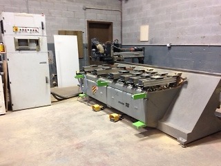

Lord have mercy on me......
Nice Biesse CNC Router
18 drill vertical and horizontal, one spindle.
The guy is asking 4000, I went and saw it, he will take 2500.
Oh my, what to do........ Great little machine, Could have this retrofitted in three weeks if not less I am sure.
Very clean and I saw it running......

I am in Montreal. I am really considering this purchase. It is like a baby next to the 346...lol
I have to think about this..... Head office Biesse is here in Mirabel, 30- minutes from me. These machines are all over here.
Hi, my name is Bob I am a linuxcnc-machine-aholic.
This machine has big DC servos. Probably driven with PWM, dont know. But I am sure it would be easy.

In 2 weeks I will pick up my Biesse Rover 18.
I bought the machine because it was very cheap.
I'm thinking of replacing the old NC481 controller.
But the challenge is to get the servo's running I guess.

I just found out what servo drivers are used :
X-axis: Driver: Soprel PWME 200x25/50 - Servo: Magnetic BR60L 30/13
Y-axis: Driver: Soprel PWME 200x14/28 - Servo: Magnetic BR60S 30/12
Z-axis: Driver: Soprel PWME 200x14/28 - Servo: Magnetic BR60S 30/12
Is there an easy way to keep the drivers/servo's in combination of a new CNC controller?

I did a quick search and could not find much info on the drives, but if they are -+10V analogue ones, it can be done as many of us here did many times on many different machines. See if you can find any manuals and schematics, that would help a lot.

Same here, difficult to find information about the drives .
But I read somewhere that the drives are -+10 analog.
The same person mentions that the drives are only responsible for the speed, not the position?
What hardware/software is used to let them do the job?
