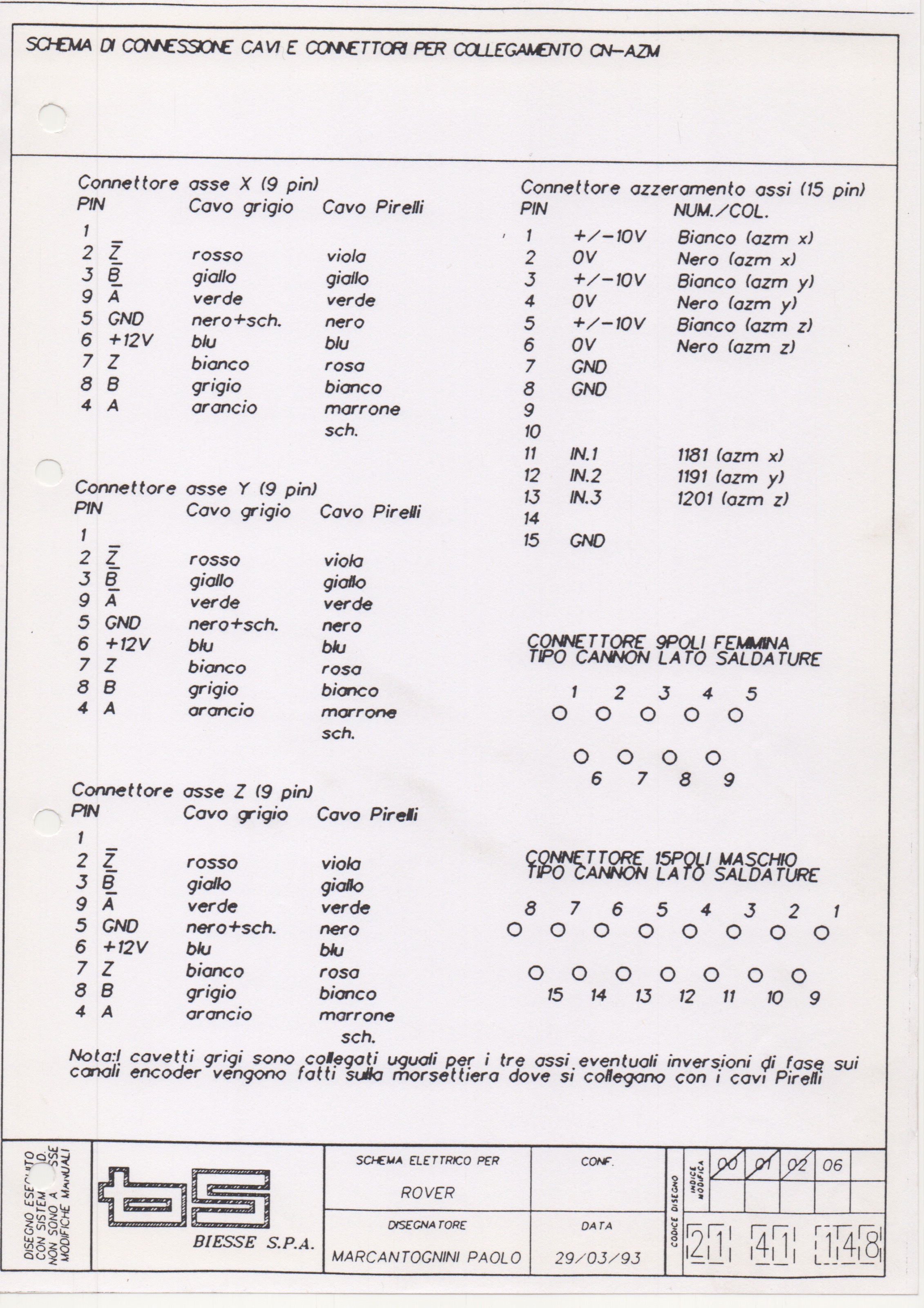

Hello, Bob,
I start to retrofit my old Rover. I tried to write you a message, but unsuccessfully. Could you write your contact email or write to me at..

Replied by Jonasza on topic Biesse Rover 18 CNC router
- bevins
- Posts: 1947
- Thank you received: 338
14 Nov 2018 19:48 - 14 Nov 2018 19:48 #120692
by bevins
I would say this is the back of the controller with the connectors. Those pins are more than likely enable pins out of the controller to the drives. You would have to check. Just trace them out.
Replied by bevins on topic Biesse Rover 18 CNC router
Maybe someone knows about these 1181, 1191 and 1201 pins? This is enable pins?
Last edit: 14 Nov 2018 19:48 by bevins.
