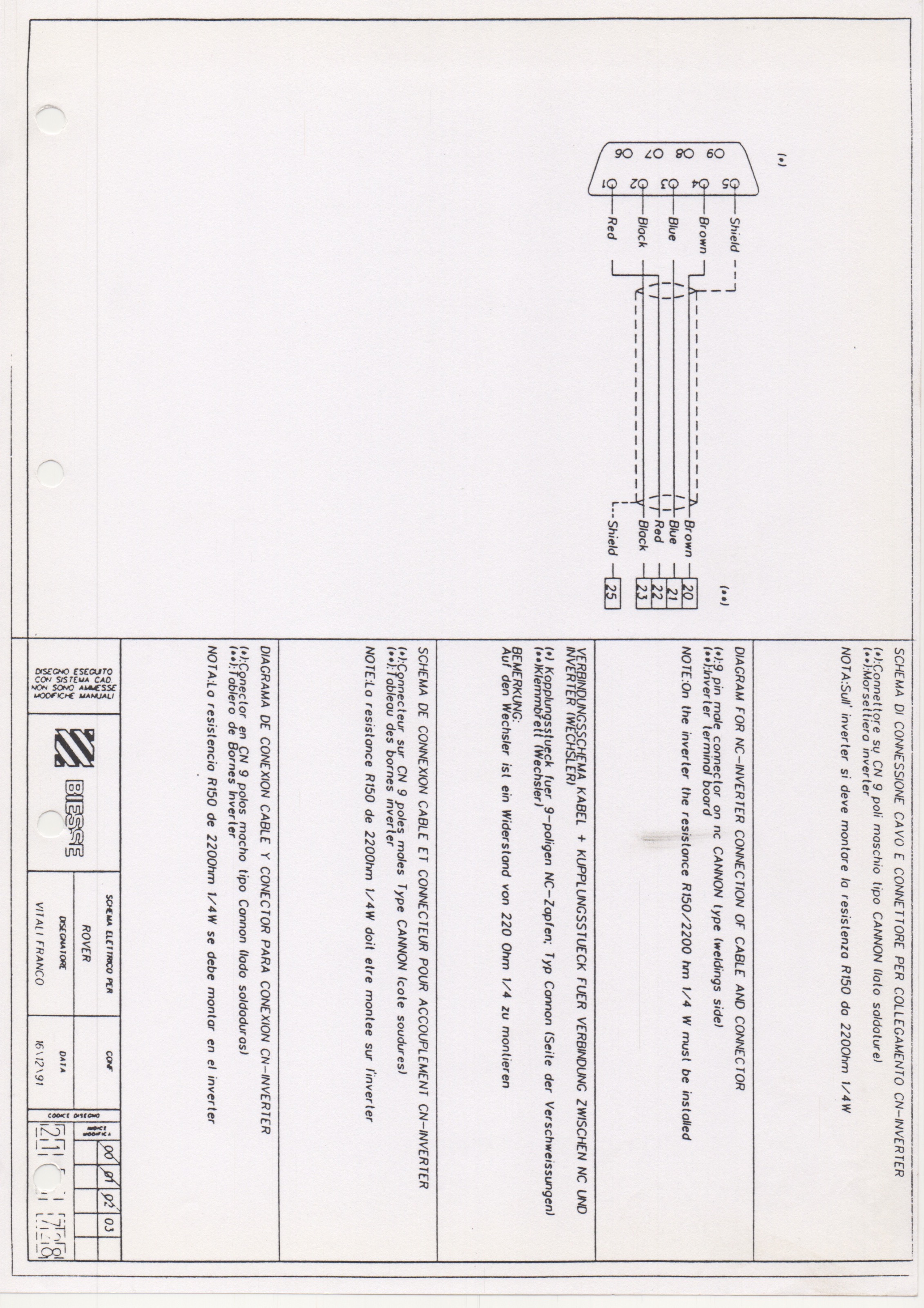

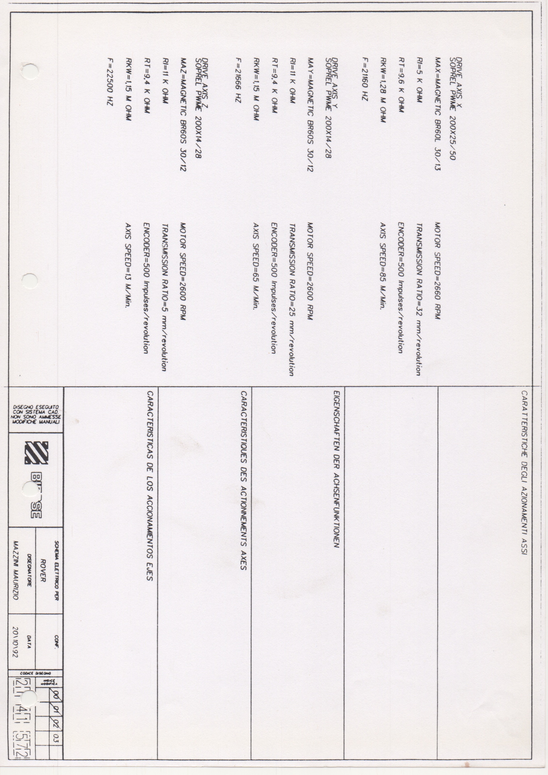

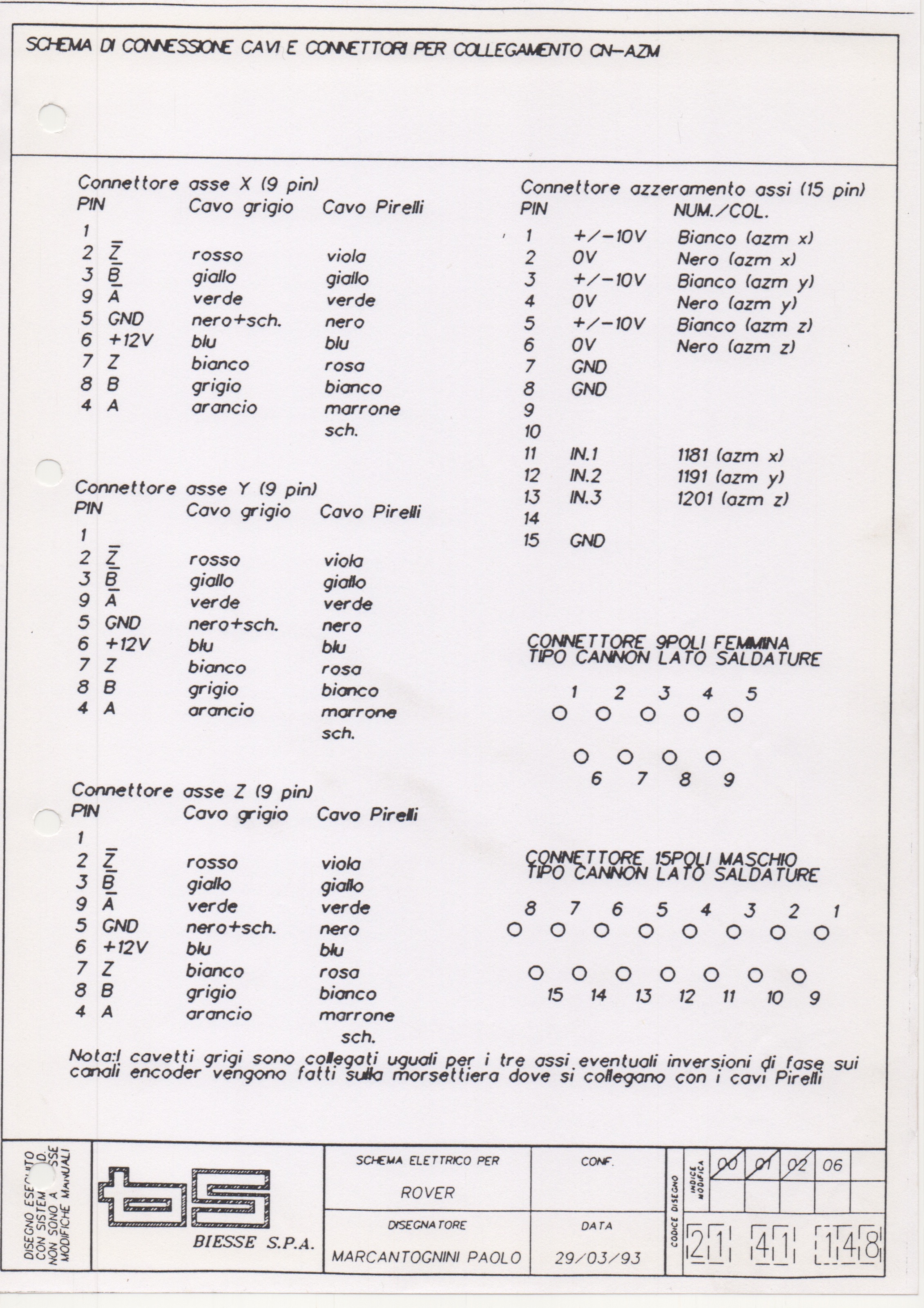

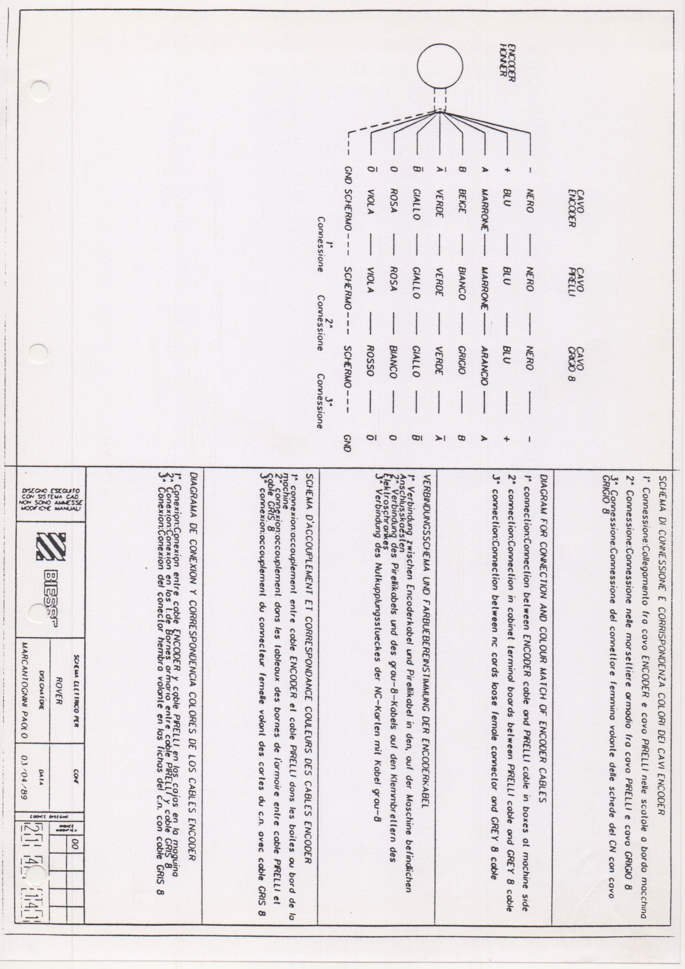

I've found some information in the manual.
In attach you can find the wiring diagrams

It looks like it would be a relatively straight forward servo conversion. A Mesa 7i77 + one of Mesa's DB25 FPGA cards woiuld be able to send analog velocity commands to the drives and read the encoder feedbacks.
- Posts: 22030
- Thank you received: 7504
29 Jan 2018 04:36 #105148
Replied by tommylight on topic Biesse Rover 18 CNC router
That looks all good and as far as i can see there is only the encoder voltage that has to be lowered to 5V level through voltage dividers. Your encoders are 12Volts, 7i77 has 5V envoder inputs.
That requires adding some resistors to encoder outputs before wiring them to 7i77 encoder inputs.
Can be done, it looks that you can keep the existing drives and motors.
