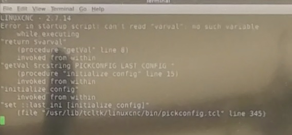

You might have to expand the config tree to pick a node that corresponds to an INI file rather than to a folder.

Bonehead move. I had plugged the ref inputs in 1 pin off, so the negative signal went to positive and there was no negative, which explains why the drive would run away only when commanded. I read more about tachometer mode and have elected to forget it and use current mode.
Andy, can you expand on your comment? I did some googling, but didn't find anything relevant. Thanks.
This is the error when opening LinuxCNC config picker.

I reinstalled Linux and am able to get EMC2 to run now.

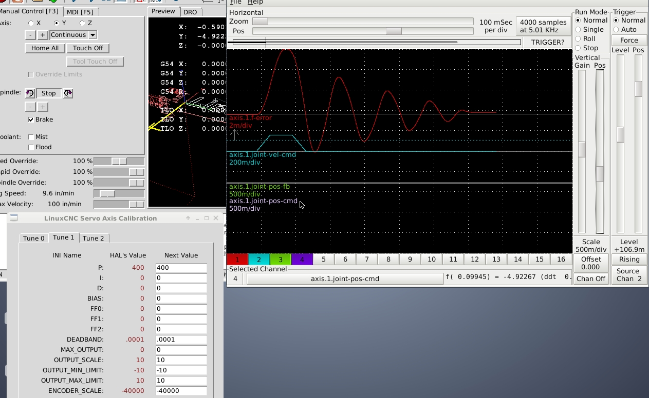

I have fixed the runaway issue in tachometer mode, and now have y axis setup in velocity mode. I'm attracted to running the amps in tach mode since it requires far less drive tuning; I have a scope, but no function meter nor current probe. If I can't get satisfactory tuning in velocity mode I'll try torque mode.
I've been doing lots of reading regarding tuning and I'm having a difficult time making sense of it all. Here is a screenshot of the y-axis as it is now:
On the drive I have the loop gain pot set to 1 turn less than what causes oscillation, and the reference gain set to max. For testing I'm doing a ~10in/min continuous jog. With P set to 500 the motor will oscillate after the jog, oscillation stops around P of 400. Referencing John Thornton's guide, FF1 should be 10/Velocity@10V. My machine's velocity at 10v is about 3in/s, so FF1 should be .3? Near the end of the guide he said that his FF1 ended up being .03% of P, which would be 12 in my case. Is my 'OUTPUT_SCALE' off? Stock value was 10, so I just left it as.
What is 'MAX_OUTPUT'? Should that be 0?
Stock value for FF0 was 1, but with the P value of 400 anything above .1 FF0 causes runaway.
I can't get joint-pos-fb or joint-pos-cmd to show anything but 0 in halscope, is this a problem with my config?
What is a reasonable number for max accleration? The stock value was 30in/sec which seems very high to me. I currently have it set at 4in/sec for all axes.
Thanks!
Thanks!

For a velocity mode servo, FF0 should be 0
FF1 should be 10/velocity @10V or 1 if you scale the analog out to machine velocity at 10V. You can fine tune FF1 by checking the following error at a constant speed (null this error by changing FF1)
P should be as high as you can get without oscillation minus maybe 30% for stability.
The acceleration number will determine the smallest radius you can do without slowing down (V^2/A), The acceleration for slower machine tools is typically 2X to 10X the max velocity (so max velocity is reached in 1/2 to 1/10 of a second) .
4in/s^2 is pretty slow (and would mean the tightest circle you could cut at 3 IPS would be about 4" in diameter).
4 in/sec^2 is also about 1/100g so unless you have very heavy axis 4 i/s^2 is not using much of your drives capacity.
maxoutput should be 0, also, if you used pncconf to create your hal file, you should set all axis PID maxerror values to 0

That depends on where you are looking for them, but possibly.
If the machine is moving under CNC control then joint.N.motor-position-cmd must be non-zero and getting through to the drives somehow, so it seems most likely that youa re just scoping the wrong HAL pins. (or are scoping signals that are not actually connected or used in the HAL)
Replied by andypugh on topic New Machine Build: Bridgeport R2E4 Series II

Also HALScope has a bug that causes newly added signals/pins to read as 0
until you set the run mode to stop and then back to normal/roll/single
