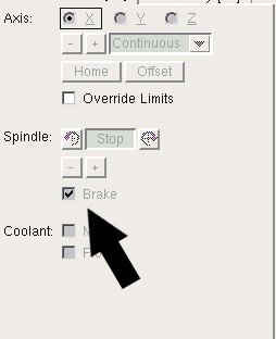

14 Sep 2018 12:30 #117547
by tightmopedman9
Are you referring to this check box?
If so, that's what my original question was referring to. When the spindle stops the brake is automatically applied (box is checked). I would like to disable this option so that I can apply the brake only when needed.
I think it might be easier to just integrate this into a glade panel.
Replied by tightmopedman9 on topic New Machine Build: Bridgeport R2E4 Series II

14 Sep 2018 13:01 #117549
Replied by andypugh on topic New Machine Build: Bridgeport R2E4 Series II
Un-check the box....
- tightmopedman9
- Posts: 74
- Thank you received: 8
14 Sep 2018 13:09 #117551
by tightmopedman9
The box is automatically checked when the spindle is turned off! I understand that checking the box toggles the brake, what I want to change is the brake toggling when the spindle is turned off via the control in AXIS.
- Posts: 19908
- Thank you received: 4657
14 Sep 2018 16:10 - 14 Sep 2018 16:10 #117557
So it is! I hadn't realised that.
Are you using mist coolant? You could recycle that toggle if not. use an and2 HAL component to combine iocontrol.0.coolant−mist and motion.spindle-on and then the brake would only apply if you had also toggled the mist button.
Alternatively, as you say, the same setup with a gladevcp / pyvcp button, but that takes up more screen space.
The box is automatically checked when the spindle is turned off! .
