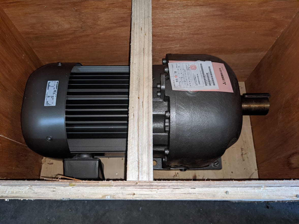

So before I knew it, I am about $2k into the project with orders in place for:
1. Unused/surplus Mitsubishi 5.5 kW 3 phase motor with 5:1 reduction gear box (300 rpm) About 180 kg of gear I'm told

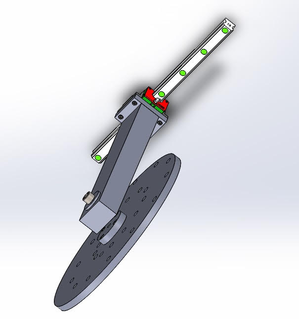

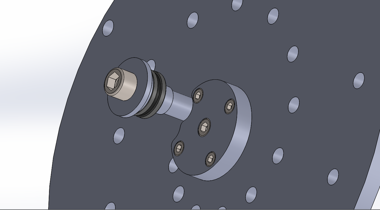

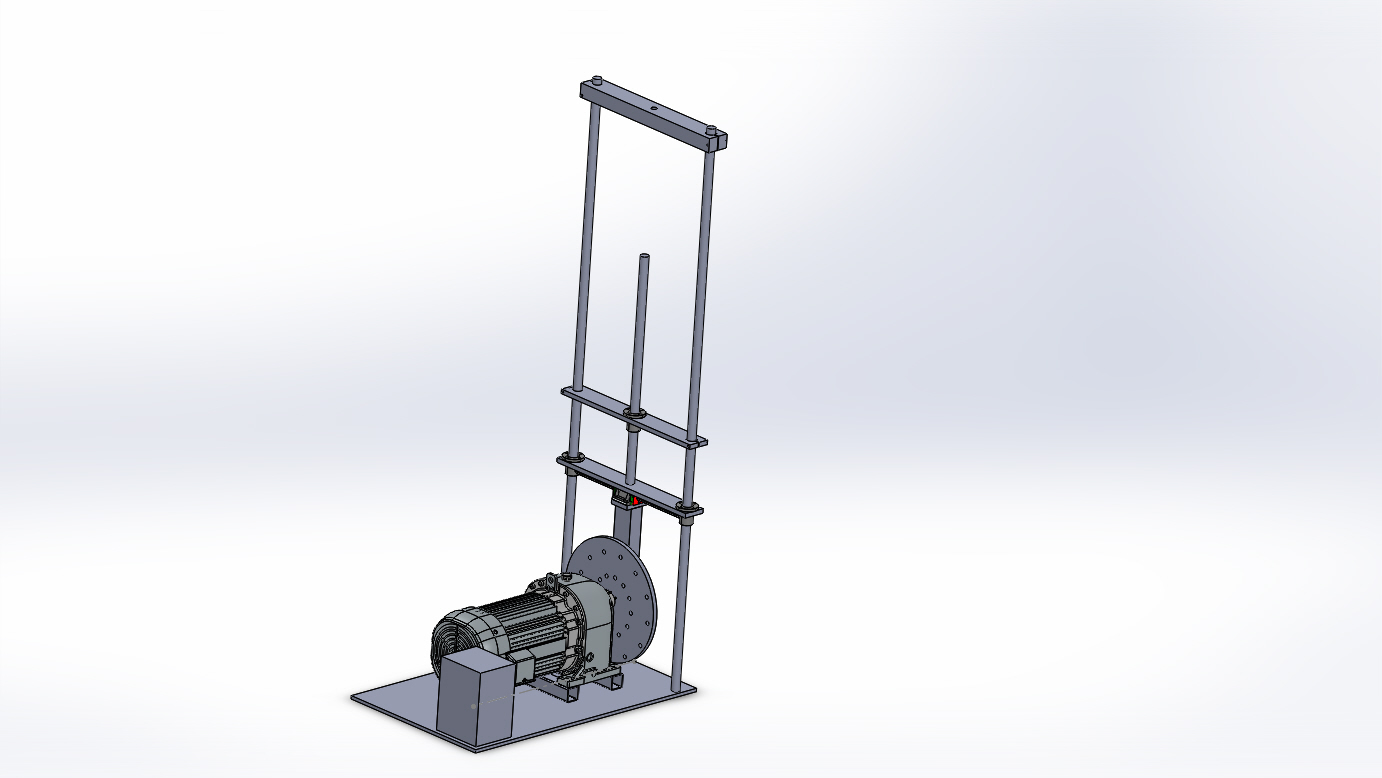

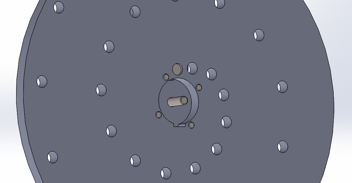

I found a bit of time to design some parts. The plan is to get some parts laser cut out of 16mm steel and use a linear rail for the scotch yoke.
I nearly bought some HGR25 rails for this but decided I better wait and make sure. I'm glad I did because I had to upgrade to HGR30 and a wide carriage to be able to bolt things together.
So the pin that attaches the crank to the flywheel is 20mm diameter and is secured by a 16mm bolt. I think I need to rework this a bit but its a start. The cap needed a bit of a scallop out of it to gain clearance for a couple of pin positions at the short end of the throw. The larger flywheel is keyed to the shaft and the cap is secured to the M10 bolt in the centre of the shaft and the 4 bolts are there to stop the flywheel from sliding backwards. The throw is determined by which hole the pin is mounted to (there are a lot of holes to tap!)
The bearing is a simple deep groove thrust bearing 20mm ID and 40mm OD. It cost all of $12 and is good for about 2300 kg of thrust which should be enough!. Its not shown in the render but I've added a grease nipple to the bottom face of the crank.
And the part I'm not looking forward to is sorting out the 16mm wide keyway. I thought this would be easy but I found my broaches only go up to a 30mm shaft and 10mm wide keyway. I think we will try to get the keyway cut in with the laser cutter and file it to size unless someone has an idea. I did ask a guy at the machine shop next door. They do some pretty big stuff for cranes and even he baulked at a 16mm keyway!
So the minimum movement will be around 75mm and the maximum about 400mm and the throw can be selected in 12.5mm increments. I think will fit in my lathe if I remove the bed.
Sorry about the model being upside down but the linear rail will be fixed to a cross member that slides up and down on two 30mm uprights. I will use 30mm linear bearings for this slider. In the centre of this cross member there will be a 30mm post that slides up through a linear bearing fixed higher up. The advantage of the scotch yoke design is that the motion becomes perfectly sinusoidal which is not the case if a crank is used.

It looks like you will be changing the amplitude by moving the pin on the flywheel, so that would mean having a set amplitude to test, if i remember correctly from servicing some car checking equipment they have a changing amplitude, they start low and gradually raise the amplitude then it lowers again while the frequency is changed at the same time. Just a thought, since you are much more experienced in this field, i will now shut up.

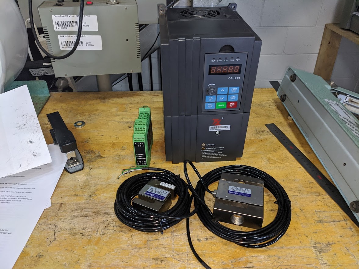

Fogot to mention, the VFD and Loadcells turned up today.
I bought 2 load cells. one with 1 tonne capacity and the other 2.5 tonnes. I'm not sure what I will use yet. The 2.5 t one looks like it uses a M20 bolt, the smaller one uses a M12.
The Din Rail module will output a 0-5 volt signal which I plan to read with a THCAD-5

In all honesty, tommy I know nothing about this subject. But yes you are right, changing the location of the lower crank pin will allow the travel (Amplitude) to vary from about 75mm to 400m. I see some use a shaft encoder to monitor position but I had in mind to use a linear scale for the encoder and that should resolve to an exact position. Hopefully, the machine can learn the travel without needing to change a setting every time you change the diameter of the crank (which is what you would have to do if you were using a rotary shaft encoder).
