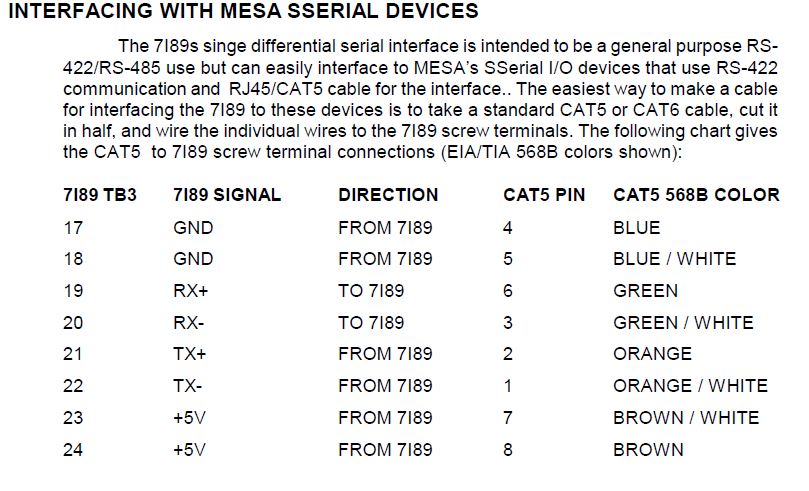

Now I have another problem:
I connected the Mesa 7i89 via Sub-D25 (EPX1) to 7i76e and the 7i66-24 via RS422 to 7i89 because the RS422 on 7i76e is already used by 7i70.
As you already mentioned the 7i66-24 and 7i70 should be "self configuring" So there shouldn't be anything special to do to get these cards to work. The 7i70 works perfectly and is also visibile in the Hal-Konfiguration pins in the LinuxCNC software.
The 7i66-24 is not visible and the LED on the card is red --> not green. If I connect the 7i66-24 directly to the 7i76e via RS422 the the card is also visible in Hal-Konfiguration Pins and works. But it doesn't work with the 7i89 between.
To connect the 7i66-24 to 7i89 RS422 I used a standard CAT5 cable and connected it to 7i89TB3 (see picture).
Do you have any idea what's the problem?

- Posts: 18079
- Thank you received: 5316
13 Mar 2020 17:16 #160055
Replied by PCW on topic Luxmill CNC retrofit project
1. Is the 7I89 jumpered for RS-485?
2. you would need
net toolclamp <= hm2_7i70e.0.7i66.0.1.input22
net toolclamp => hm2_7i76e.0.7i66.0.1.output-06
or
net toolclamp <= hm2_7i70e.0.7i66.0.1.input22 => hm2_7i76e.0.7i66.0.1.output-06
(you cannot connect pins without a signal, the signal is "toolclamp" in this instance)

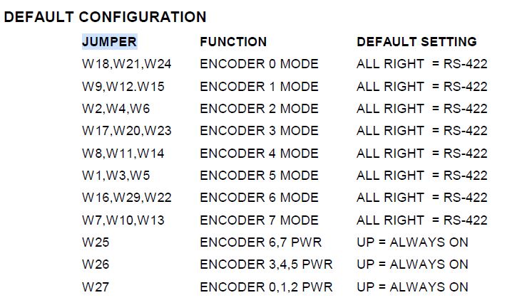

- Oehli
- Posts: 20
13 Mar 2020 17:31 - 13 Mar 2020 17:34 #160058
by Oehli
Replied by Oehli on topic Luxmill CNC retrofit project
Thank you again for your help.
1. I couldn't find a jumper setup for RS485 on 7i89? --> see picture
But is it in general possible to use the 7i66e in the discribed configuration:
Mesa 7i89 via Sub-D25 (EPX1) to 7i76e and the 7i66-24 via RS422 to 7i89.
regards,
