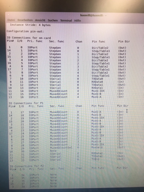

Sorry I was thinking 7I88
Do you have the plug in correctly?
(the 6 pin 7I76e plug will work in the 7I89 if you skip the top pin = one pin above and below the 6 pin plug empty)
Also verify the the 7I89 has 5V power

Yes I think I have the plug in correctly. I can measure 5V between 7i89 TB3 Pin 17/23 and Pin 18/24.
The 7i89 also is connected to 5V at P1.
The 7i89 generally works if i connect an encoder to one of the encoder inputs.
The 7i76e jumpers W7 and W12 are in up position --> Pins 22, 23, 24 and 25 are 5V (required in 7i89 manual).
The 7i66-24 works connected directly to 7i76e via RS-422/485 SSerial.
The 7i66-24 doesn't work if i use the cable and pin configuration mentioned in 7i89 manual.
The 7i66-24 also doesn't work if I use the 6 pin 7I76e plug and cable and skip the top pin (= one pin above and below the 6 pin plug empty) although the cable worked between 7i76e - 7i70 and 7i76e - 7i89.
I added a picture of the bitfile readout (generated from you). Is there everything fine with the RS-422/485 SSerial configuration?
Do you have further ideas?

Uhhhhh I got a solution:
I opended the HAL Configuration and changed:
sserial_port_0=00XXXX to sserial_port_0=000XXX and it worked!
In the bitfile readout (I posted above) RXData2 / TXData2 is shown. So just for me to anderstand is this the third port (--> 0,1, 2) or how do I know which sserial port is used?

Yes, sserial_port_0=00XXXX only enables the first 2 sserial channels (0 and 1) on port 0
(and sets them both to mode 0)
This is described in the hostmot2 manual page
