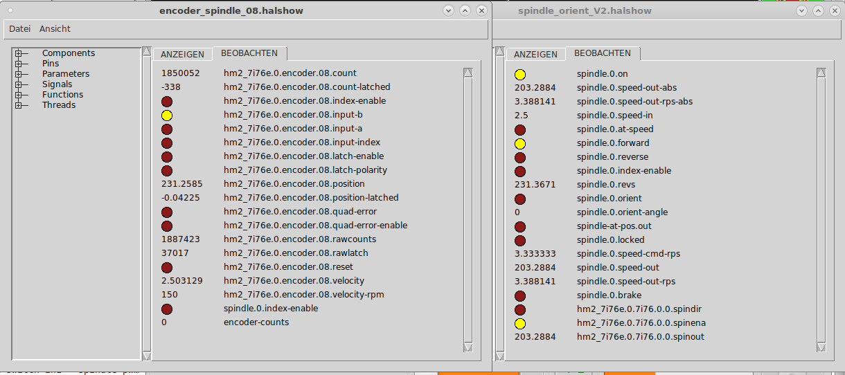

I tried a lot of things and googled for hours without success. I do not get it running right. Here some problems I found:
1) The closed loop spindle speed control doesn't work. If I set M3 S200 I get the following things:
--> The spindle encoder velocity (hm2_7i76e.0.encoder.08.velocity-rpm) is not equal to the spindle velocity (spindle.0.speed-out-abs), so I guess the pid.s (spindle pid) does't work right - but why?
In this case I also do not get an "spindle.0.at-speed" signal. So the G33.1 also doesn't work too.
When I increase the "MAX_ERROR = 0.2" to about 50 the G33.1 works. But this is not a solution....

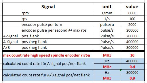

2) I already mentioned I added a 2000ppr quadrature encoder to the high speed encoder input (10MHz) of my 7i76e in differential (RS-422) mode with A/A-, B/B-, Z/Z-. I have a stable but not equal (see 1) encoder velocity signal (hm2_7i76e.0.encoder.08.velocity-rpm) up to 5000 rpm. If I go further (max rpm is 6000) I loos the signal completely.
According to my Calculation the max count rate of my encoder at max spindle rpm is much lower than the possible 10MHz:
Is my calculation wrong or do I have to modify something?

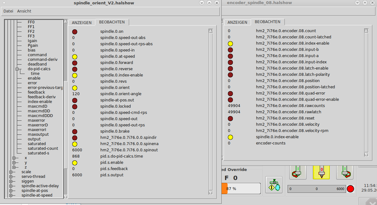

3) When I use the M19 R120 the spindle doesn't even turn. I get the following :
But for spindle movement my spindle servo driver needs an spindle direction signal (CW / CCW) on
net spindle-cw => hm2_7i76e.0.7i76.0.0.output-01
net spindle-ccw => hm2_7i76e.0.7i76.0.0.output-00
but there is no spindle direction signal via M19. How can I integrate such an signal?

29 May 2020 11:25 - 29 May 2020 13:49 #169325
by Oehli
Replied by Oehli on topic Luxmill CNC retrofit project
@Henk: Sorry my fault it's a SEW not Siemens drive.
I added my Hal and Ini Files.
What do you mean with "you need to setup the Orient component"? Do I have to modify the orient code?
Short update Hal File Z402 (just for testing):
net orient-active => pid.s.enable => spindle-orient.enable => hm2_7i76e.0.7i76.0.0.output-01
If I set the CW Signal => hm2_7i76e.0.7i76.0.0.output-01 in combination with the spindle-orient.enable the spindle starts turning but doesn't stop anymore --> spindle-at-pos.out does't become "true".
Edit: I think the SEW spindle Servo drive can also work with +/-10V. But the 7i76e (on TB4) can only deliver 0...+10V due to the potentiometer functionality on TB4. Please correct me if I'm wrong.
