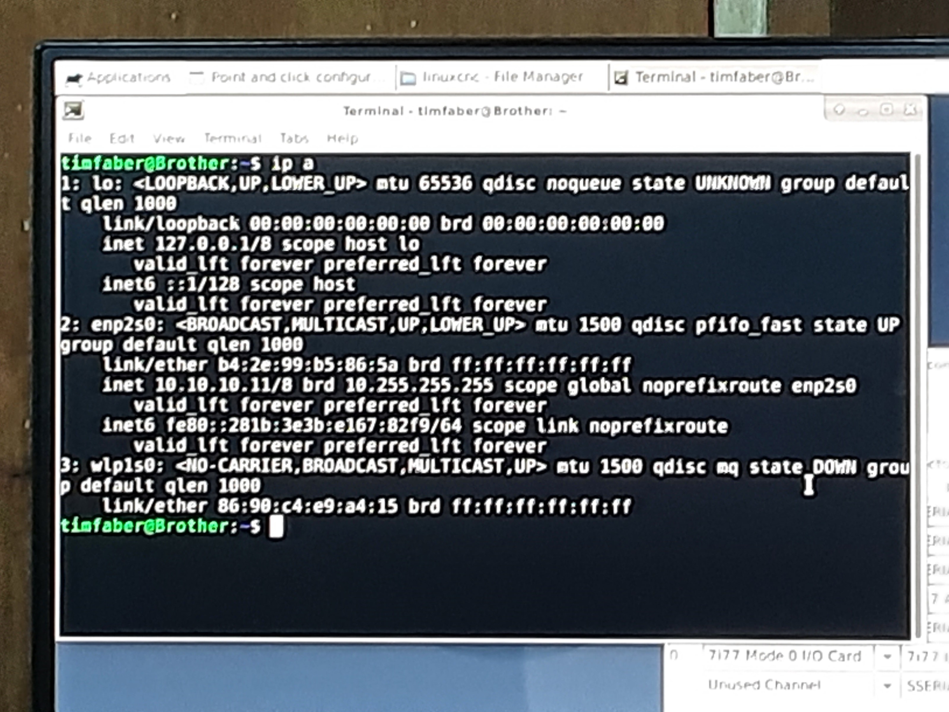

02 Apr 2021 10:50 #204518
Replied by PCW on topic Brother TC-225 Retrofit and Robot integration
What does the command
ip a
report?
ip a
report?
- timfaber
- Posts: 64
- Thank you received: 3
02 Apr 2021 10:57 #204519
by timfaber
Replied by timfaber on topic Brother TC-225 Retrofit and Robot integration
Ip a reports the following
- Posts: 18120
- Thank you received: 5337
02 Apr 2021 11:02 - 02 Apr 2021 11:03 #204520

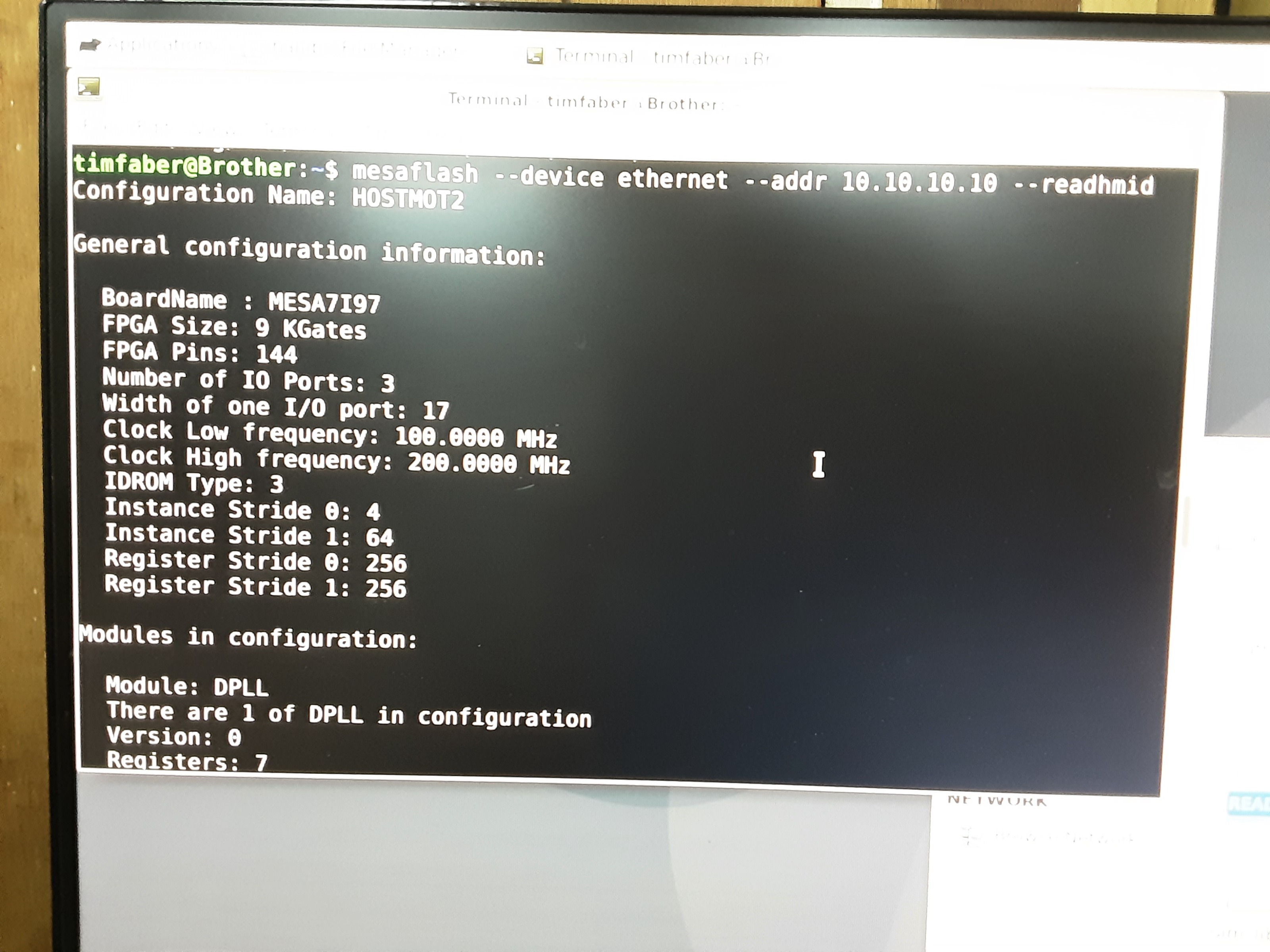

Did you set mesanflash's address?
mesaflash --device ethernet --addr 10.10.10.10 --readhmid
Last edit: 02 Apr 2021 11:03 by PCW.
- timfaber
- Posts: 64
02 Apr 2021 11:08 - 02 Apr 2021 11:09 #204521
by timfaber
I did now, but $ mesaflash --device 7i97 still gave board not found
Last edit: 02 Apr 2021 11:09 by timfaber.

02 Apr 2021 11:12 - 02 Apr 2021 11:13 #204522
Is that the latest mesaflash?, there was a version that had the 7I97 missing
(and you can always use --ethernet)
