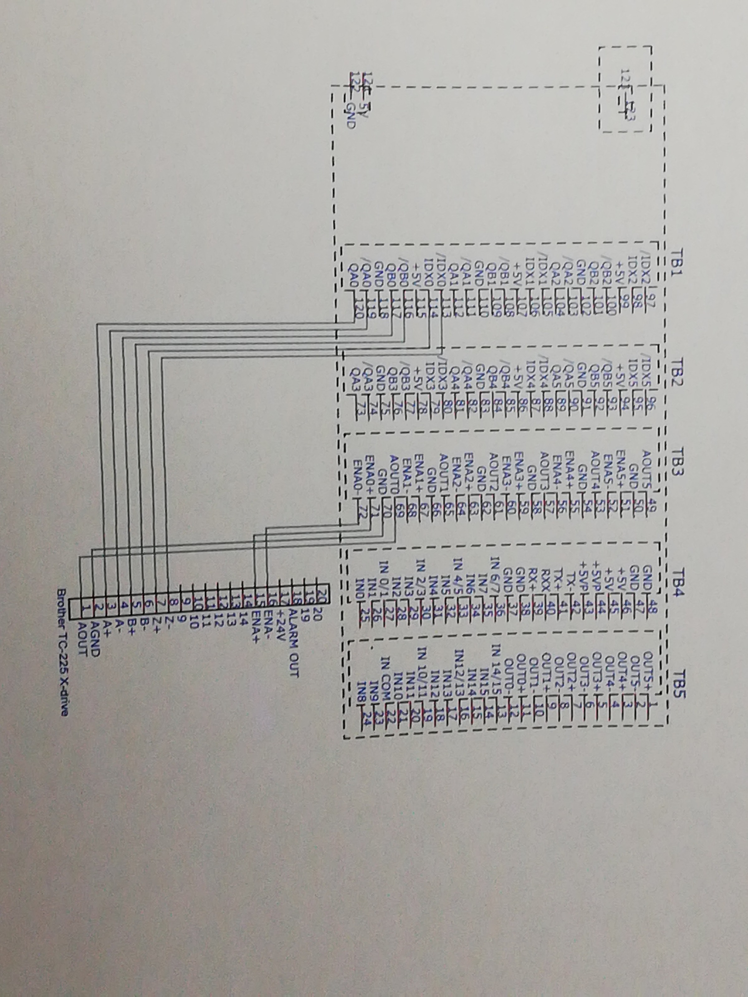

I've managed to connect some limit switches and got them working with linuxcnc, so that really boosted moral
Also starting to understand HAL a bit better, so i also wired up the x axis motor after disconnecting it from the ballscrew. now i've wired it up but when i enable the machine the motor spins and ofcourse i get "axis following error". Now could this be due to some servo setting in the ini file?

09 Apr 2021 17:03 #205445
by timfaber
Replied by timfaber on topic Brother TC-225 Retrofit and Robot integration
Here's how I wired the motor

Replied by PCW on topic Brother TC-225 Retrofit and Robot integration
You seem to have lost all the "setp [HMOT](CARD0).pwmgen.XX.offset-mode 1"
statements in the hal file, these are needed for the 7I97.
You can get following errors from tuning. At the minimum I would say the FF1 value is way off
( a value of 1 and an output scale of 10 means its set to give 10V at a commanded velocity of 10mm/second)
A good way to setup the PID is to set the output scale to the maximum velocity at 10V
then a FF1 of 1.0 makes sense

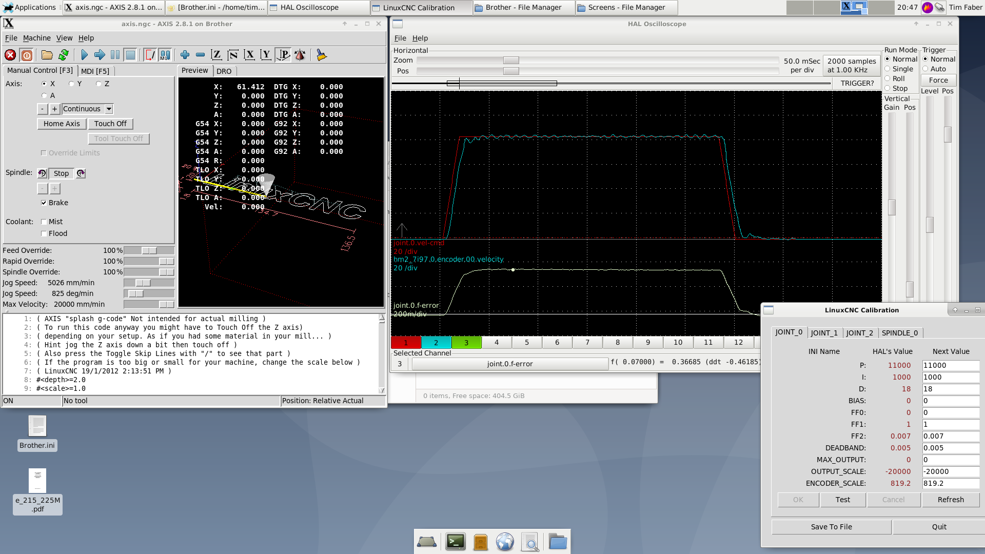

25 Apr 2021 07:02 - 25 Apr 2021 07:10 #206994
by timfaber
So I managed to reasonably tune the x axis. At least its a starting point
Maybe the tuning gods;) have some comments on these initial value. I'll be reading up on the details of tuning the following week.
And made a short video about it!

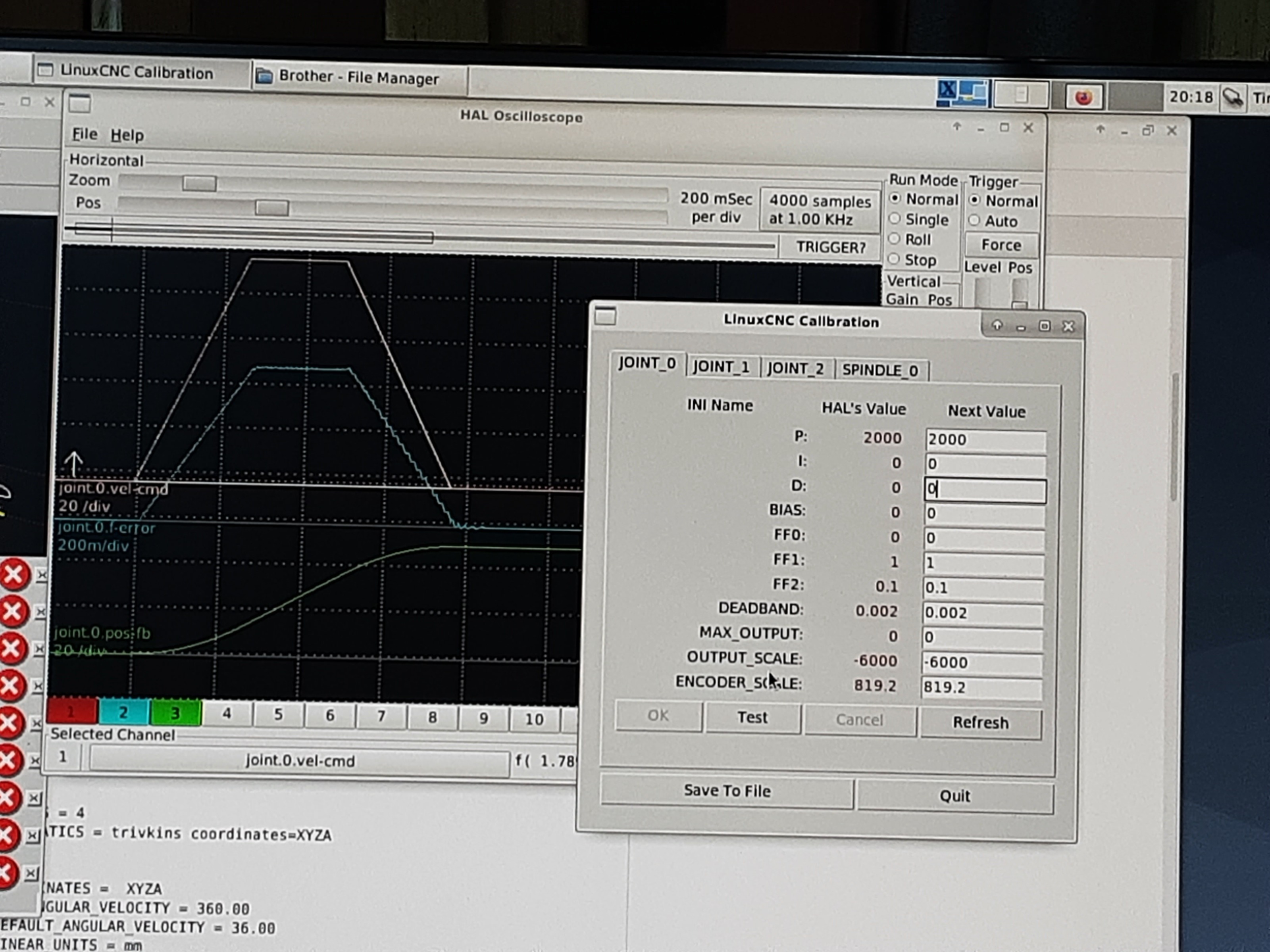

01 May 2021 18:57 #207565
by timfaber

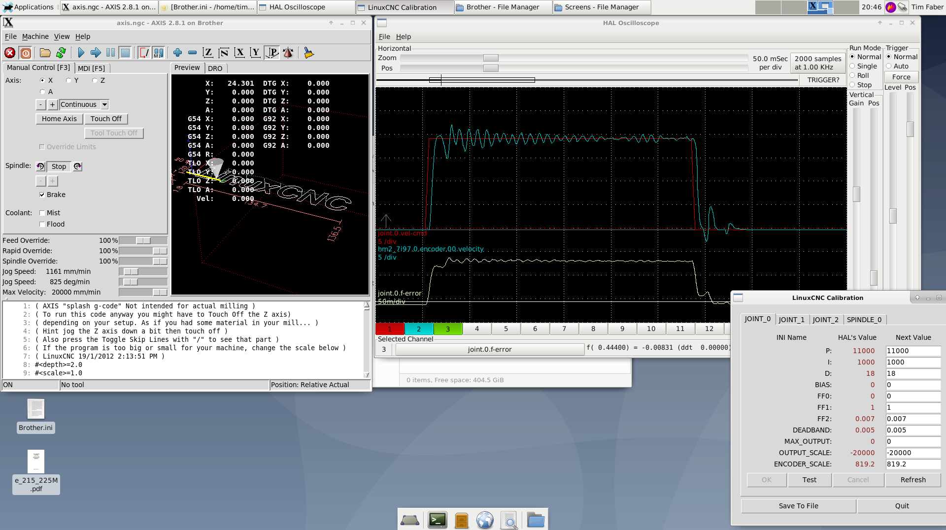

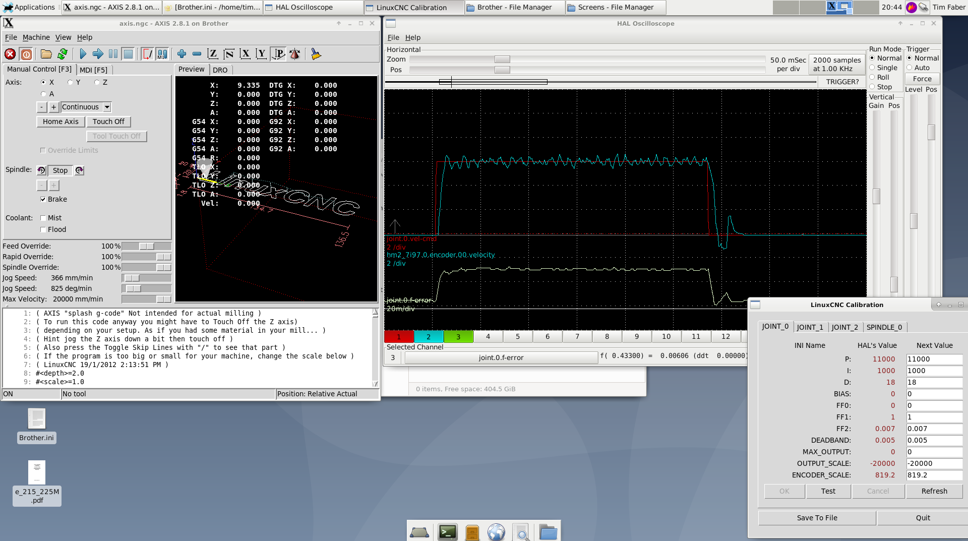

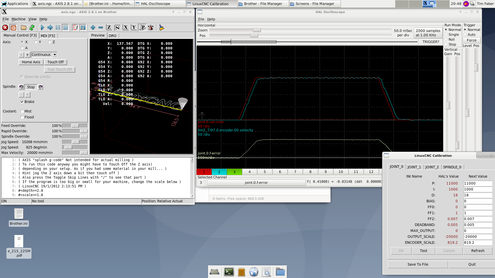

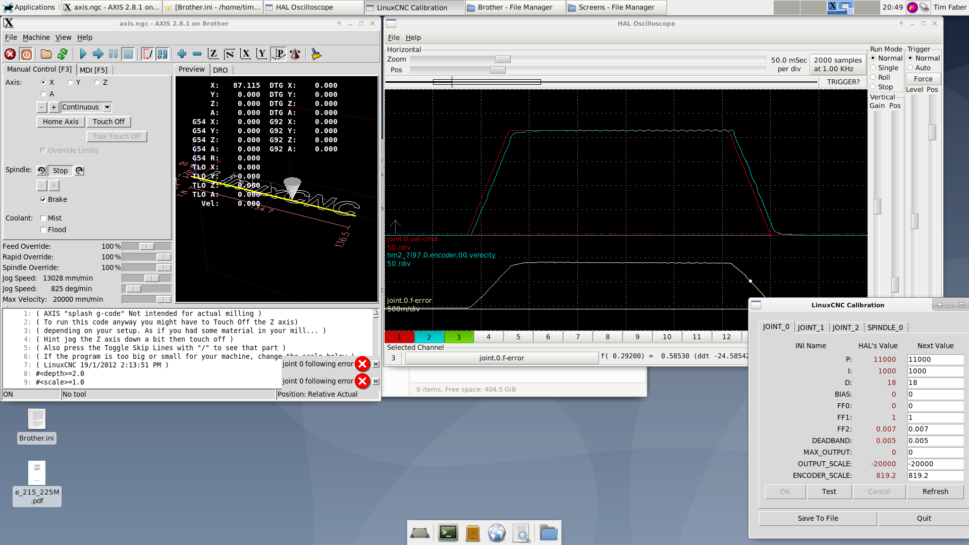

So I've connected the limit switches and had a go at tuning the x-axis with the table load on it. It sound pretty clunky at the start and stop of the acceleration. Also i think the following error could be a bit better.
In the pictures the following information can be found: Jog feed, vel-cmd, encoder-vel, f-error(plus value), pid setting.
Any one got some advice on how to get the following error a bit better, increasing P results in oscillations.
And what could be done about the clunky acceleration?
- Thank you received: 4654
03 May 2021 09:58 #207713
You could try reducing the max_accel number.
Or try putting some numbers in the max_error parameters of the PID to limit the pid output at large errors.
Replied by andypugh on topic Brother TC-225 Retrofit and Robot integration

03 May 2021 19:24 #207743
by timfaber
Now would you say this is reasonably tuned? Don't have enough experience to judge if this will result in decent machining performance.
