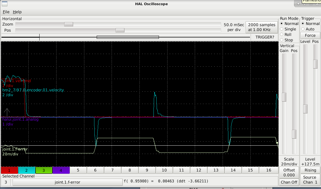

Assuming a metric machine based on the 136 in the preview, and the suggestion that this isn't a room-sized machine..
In one of the Halscope traces you have have an error of 0.015mm during a move. That's pretty good. But in others it is more like 0.5mm, which is terrible.

Ahh was wondering why my numbers where that high, thought ff1 was in mm/min.
What do you mean by 136 in the preview? The 0.015mm is my bad had the mouse hovering over a lower error value. Basically it is pretty bad. Will post some beter examples of f.error and feed later.
Now in my understanding the way to reduce the f.error is by increasing P, or are there other parameters that infuence it?

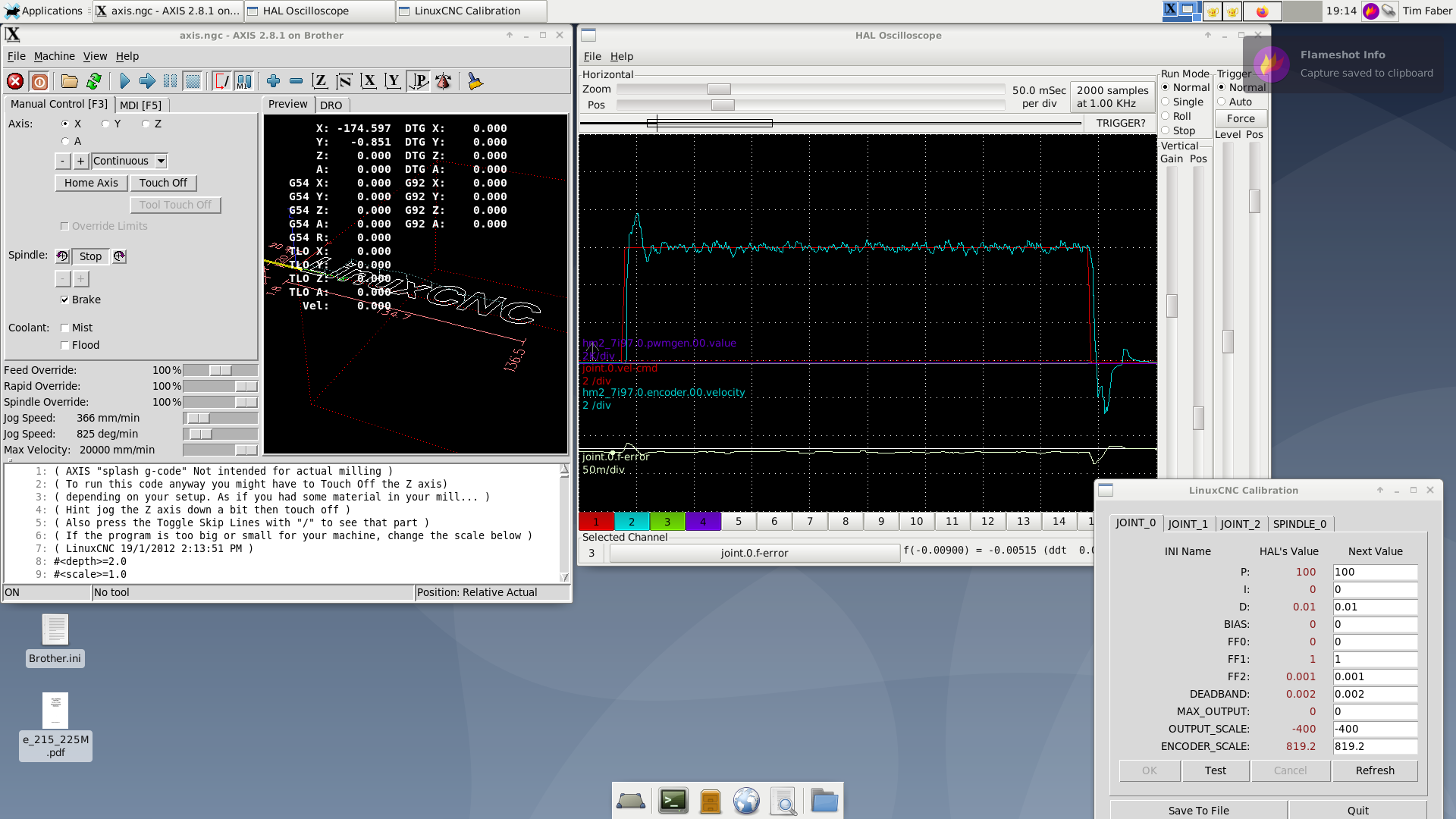

08 May 2021 12:00 #208316 by timfaber
Replied by timfaber on topic Brother TC-225 Retrofit and Robot integration
Getting FF1 right is the first thing,
if FF1 is wrong no amount of fussing with P,I,D will fix it
Currently i'm working on tuning the axis, set the right ff1/output scale and am pretty happy with the behavior of the x axis, will post a plot later. now for the y-axis, came across what appear to be hunting but it's in the tuning of the drive. since it also did that with the original control. now there is no documentation to be found on the original drive, so maybe trail en error will be the only way? in the attachments is a plot the y-axis.

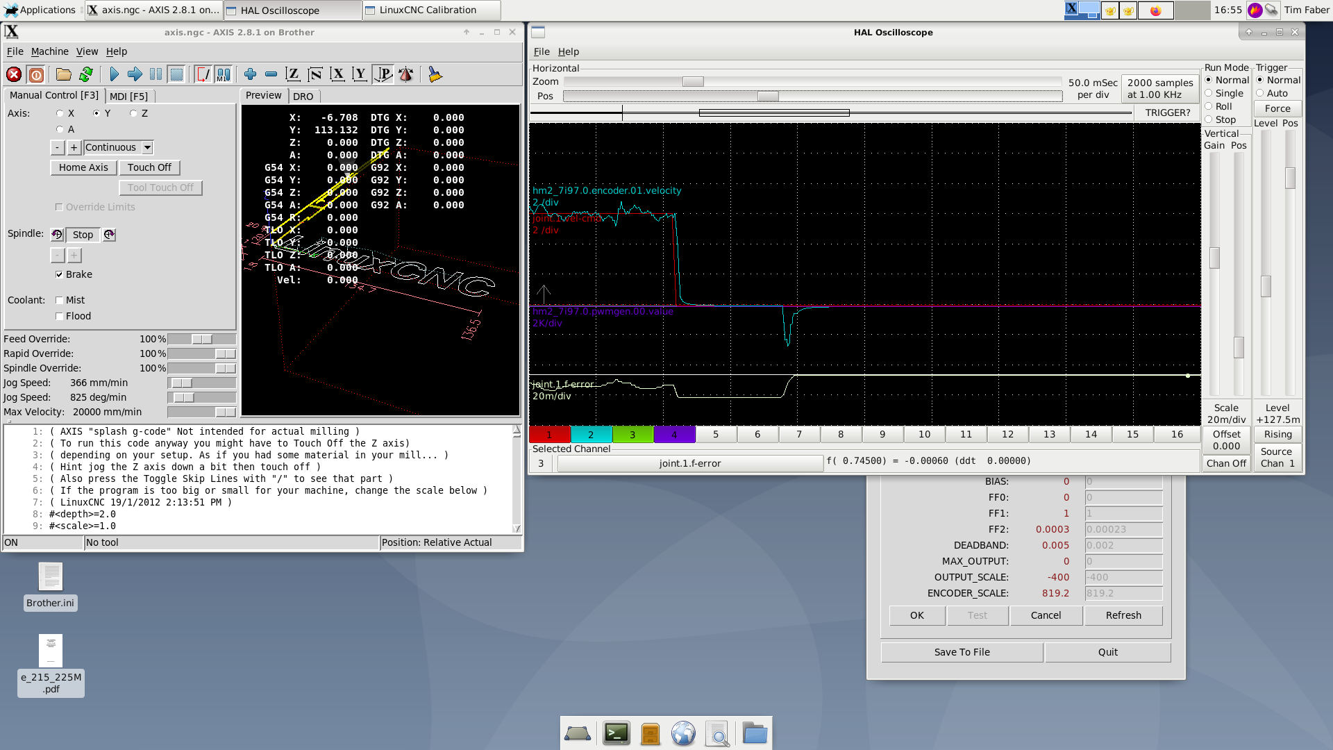

08 May 2021 12:10 - 08 May 2021 12:16 #208317 by timfaber
And here is the x axis plot, cant seem to get the start/stop overshoot out with ff2. but the max f.error is around 0.006mm which seems okay i think...

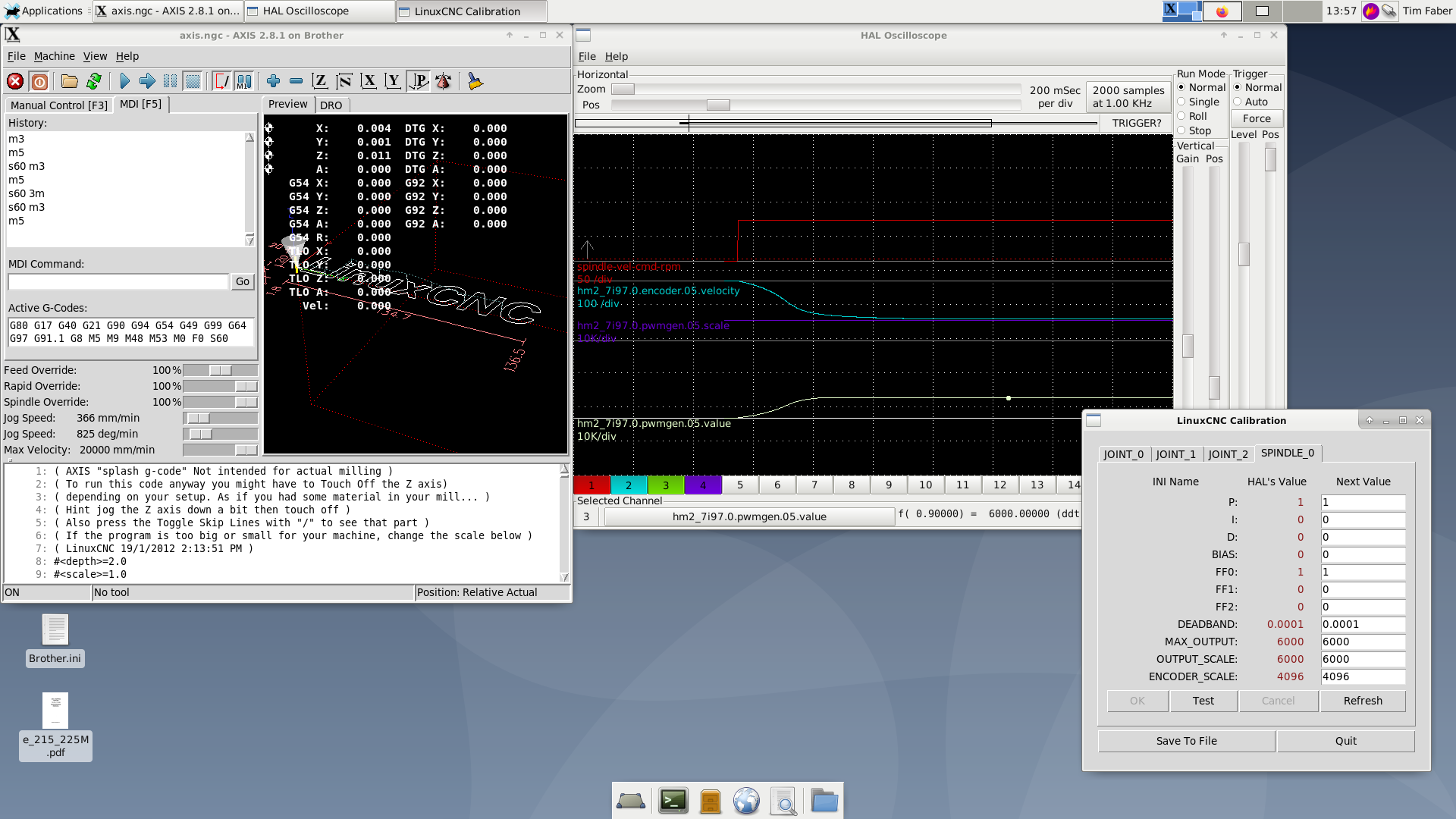

22 May 2021 07:06 #209832 by timfaber
I've got some time this weekend to work on the machine, which means new problems :dry:
Now i can't seem to control the rpm of the spindle, it always spins at max rpm. In the attachment pwmgen is 6000, encoder vel is -110 and spindle vel cmd is 60. now there seems to be some scaling error? Why does it translate vel-cmd of 60 to 6000 for pwmgen?
Furthermore, i would like to be able to orient the spindle. Now LaserK3000 has a rather complicated looking hal file for his tc215 to allow orient. I only want to be able the orient the spindle when doing a tool change.
BTW my spindle is a servo with a +-10v drive
also, is there a good way to test parts of my tool change script?
22 May 2021 08:10 #209835 by PCW
1. If you have forward spindle motion and the velocity is -110 you have the encoder
scale backwards. If you have any feedback (P or I or D terms not 0) you will have a runaway.
2. Encoder velocity is in RPS so -110 RPS is -6600 RPM (there is a encoder RPM velocity pin as well)
3. Can you post your current hal/ini files
The following user(s) said Thank You: timfaber

22 May 2021 08:26 - 22 May 2021 08:26 #209836 by timfaber
Ahh cheers, the P=1 was the problem. Now the spindle works propperly, next up try to orient it.
Any advice on a good example setup or where to read up on orient?
Couldn't make much sense of the linuxcnc.org/docs/2.8/html/man/man9/orient.9.html
INI and HAL files in attachments
