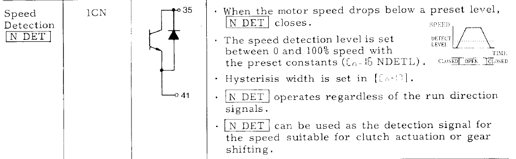

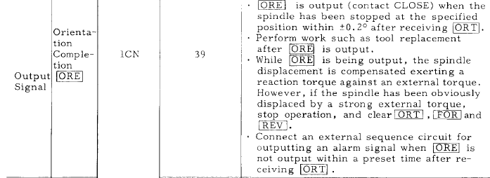

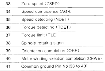

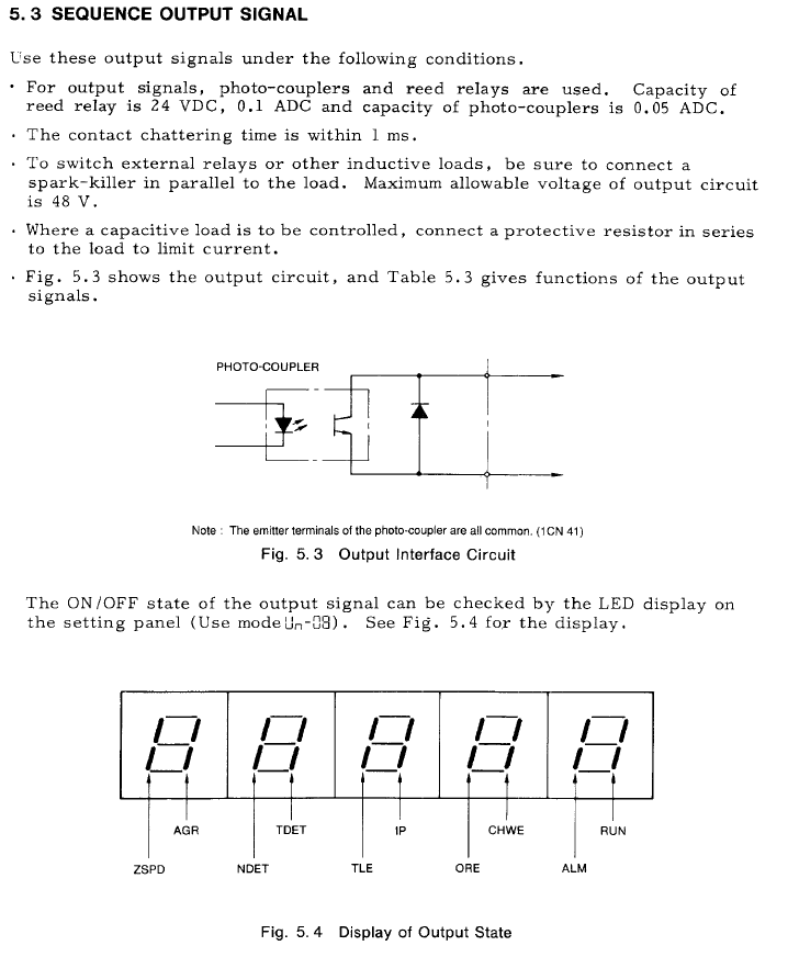

Right now, the Yaskawa spindle inverter is giving me a bit of a headache. Perhaps there is someone here who can tell me how to connect the output signals—as shown in the pictures—within the Mesa card.
As an example: the spindle orientation function uses signal contact 39, while contact 41 serves as the common (COM). As soon as I initiate the spindle orientation and the process is complete, the VFD outputs the signal via contact 39. To verify this, I can see on the VFD's display that the signal is being generated internally; however, I am having trouble reading this signal with the Mesa card.
Another example would be speed detection. How is the signal processed?
What is the difference between Signal 34 and 35?

Since the VFDs outputs are sinking you would connect (for example):
PIN 41 --> 24V common
PIN 39 (ORE) --> 7I97T INPUT8 (TB5 PIN 1)
PIN 35 (NDET) --> 7I97T INPUT9 (TB5 PIN 2)
+24V --> 7I97T INCOM 8,9 (TB5 PIN 3)
Be very careful that you do not accidentally connect +24V to
any VFD output, as that will instantly destroy the VFDs optocoupler.

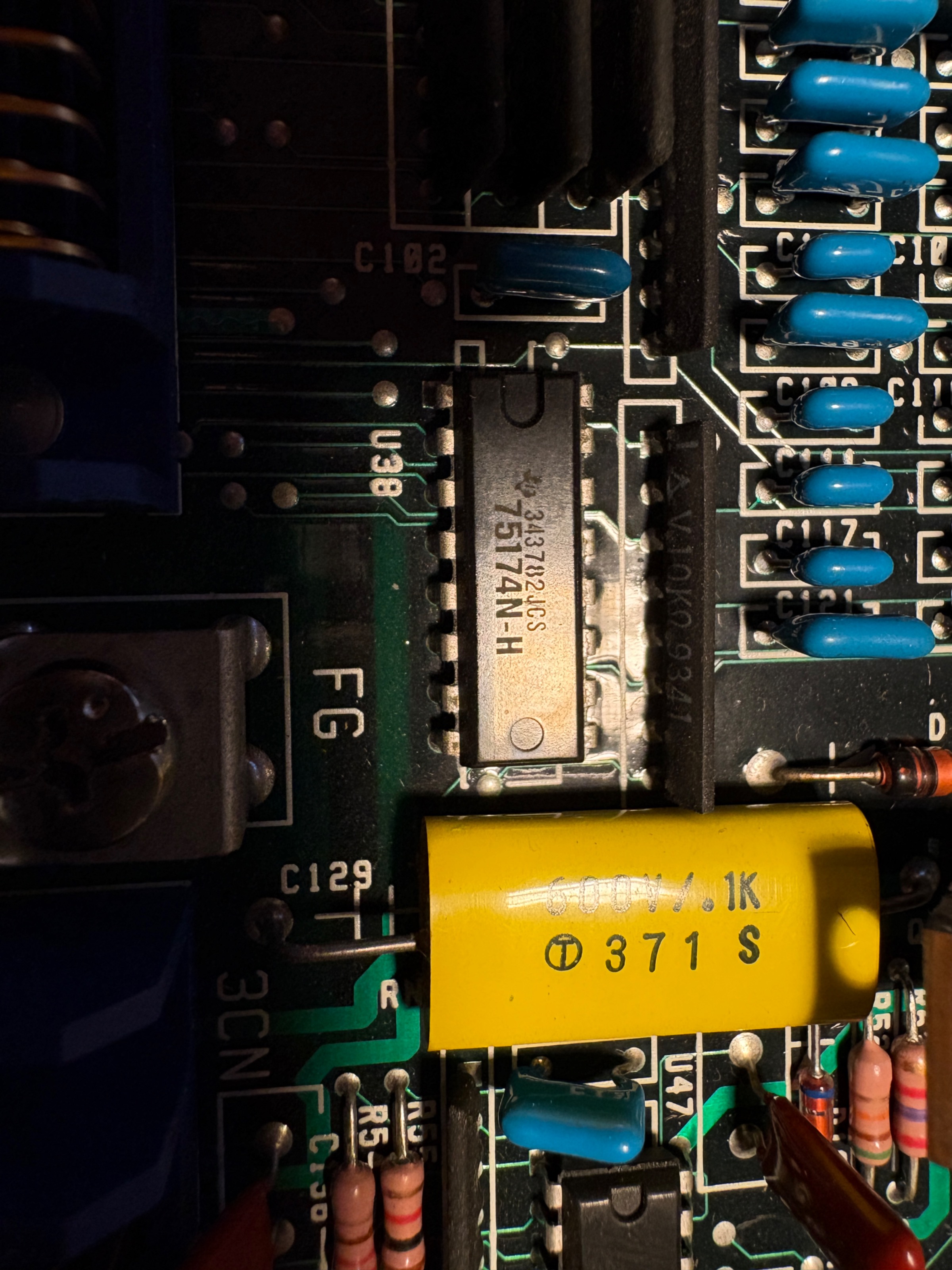

Thank you very much for your help. Your description provided the solution!

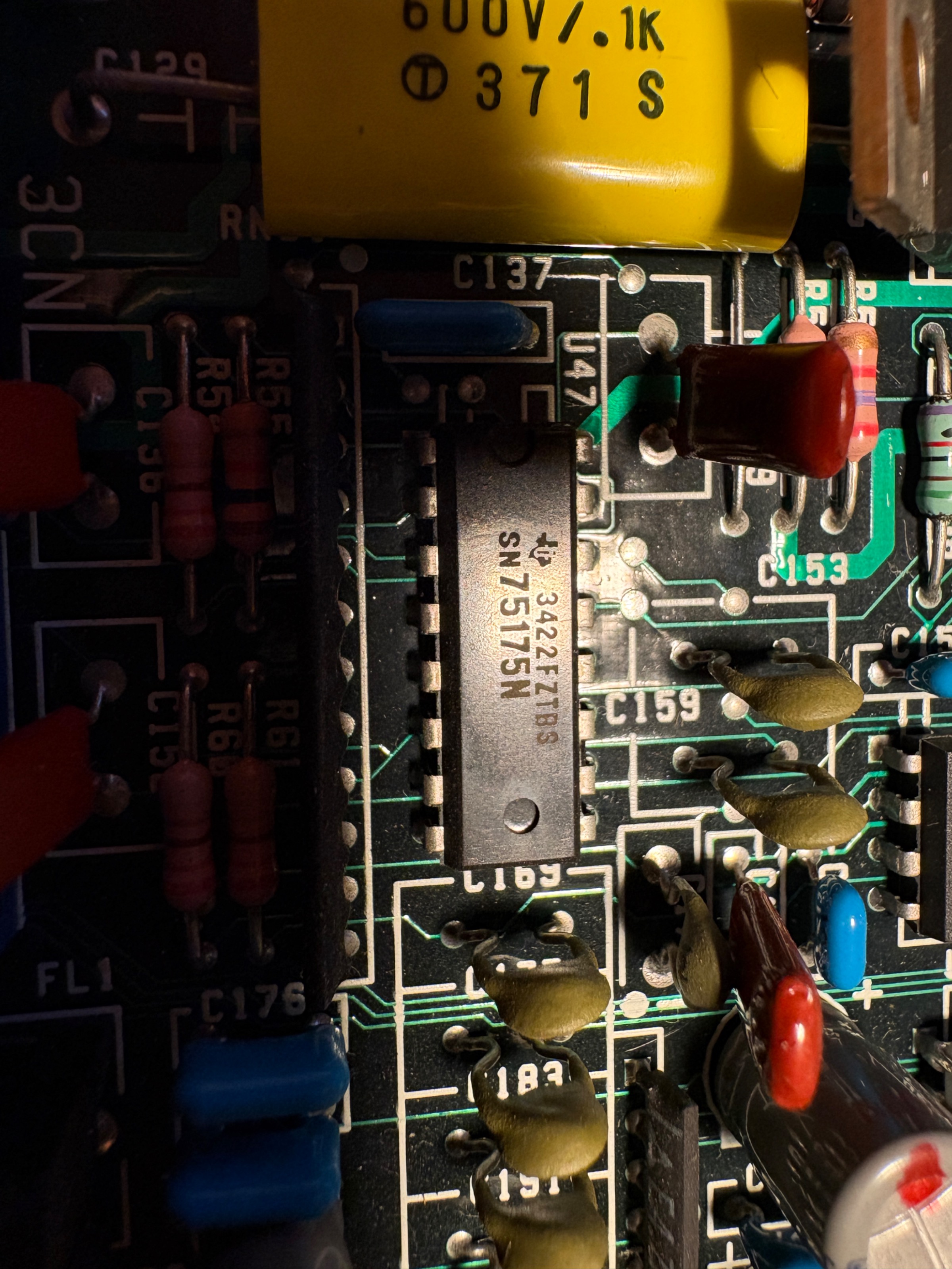

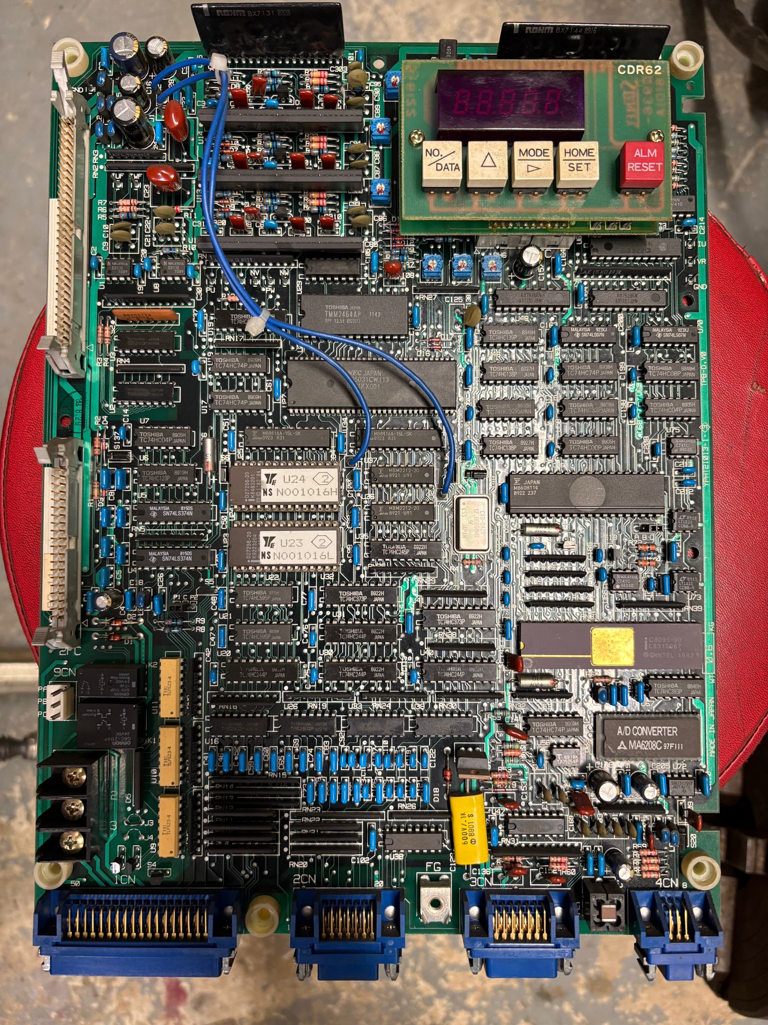

Unfortunately, during testing yesterday, we blew out one of the outputs. I have already ordered a new optocoupler. I also have a second inverter, but it has a fault at the encoder input, as the signal is not being detected. I installed this circuit board and on that board, the output switches correctly as well.
Perhaps someone here is familiar with the Yaskawa board. There must be a defective component somewhere on the board preventing the encoder signal from being processed. The encoder input is connector 2CN.

07 May 2026 21:52 #346261
Replied by PCW on topic Hurco BMC 30 AP
Ouch!
A bit late, but one trick is when testing, to have a say 470 Ohm resistor in series with the +24V used for
sensing the output, that way the current is limited to ~50 mA in the event of a wrong connection.
What chip does the encoder input use? If it's differential it may be something common like a 26LS32
Ouch!

07 May 2026 22:02 - 07 May 2026 22:05 #346262
by 5_Zylinder
Replied by 5_Zylinder on topic Hurco BMC 30 AP
I traced the path on the circuit board a bit and came across the following two components: 75174N-H and SN75175N.
Last edit: 07 May 2026 22:05 by 5_Zylinder.
- Posts: 18100
- Thank you received: 5326
07 May 2026 22:13 #346263
That makes sense, the 75175 is likely the differential encoder input circuit
and the 75174 is used for an emulated encoder output or some such...
