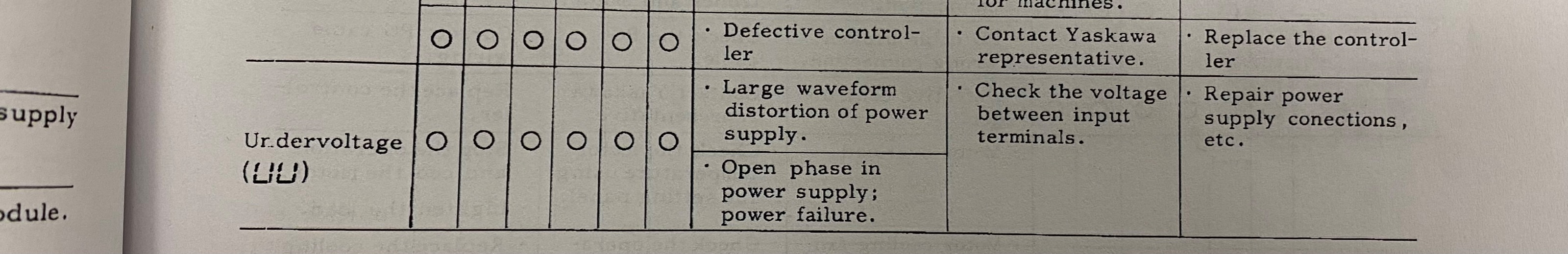

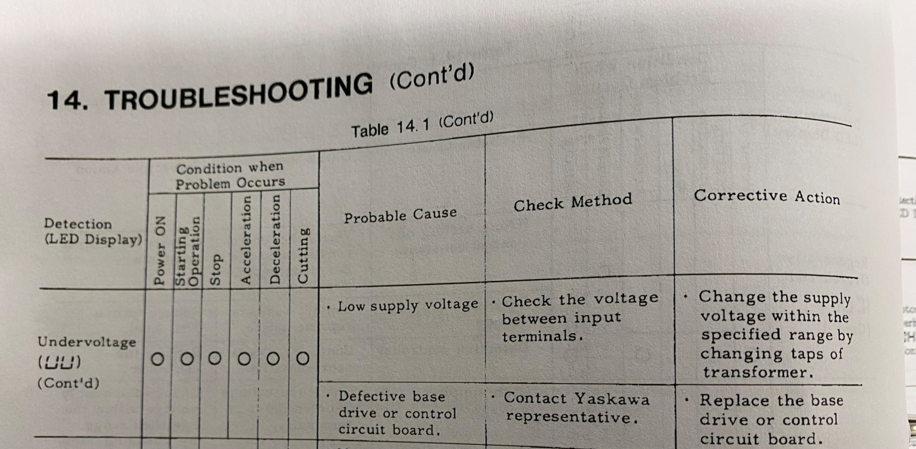

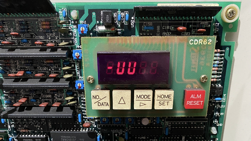

Today we went further and tried different things. In the meantime I bought a used converter.1. Replaced the broken transistor module on the old spindle driver, the error message UU is now present, but there is still no encoder signal on the Mesa card.2. Connected the "new" spindle driver dry, determined that the fan on the "old" spindle driver is broken, but also because the error message UU is present.3. Spindle driver „old“ exchanged for new spindle driver and the encoder signal can be properly evaluated via the Mesa card.Conclusion, spindle driver must have several defects, now it has to be clarified why the error UU occurs, possibly another problem with the wiring.

Some rectifiers and some capacitors make the input of the drive, so if there are 3 phases present, those should be checked. Easy to spot, find the biggest capacitor/s and trace backward towards the power input, the rectifiers should be in between.

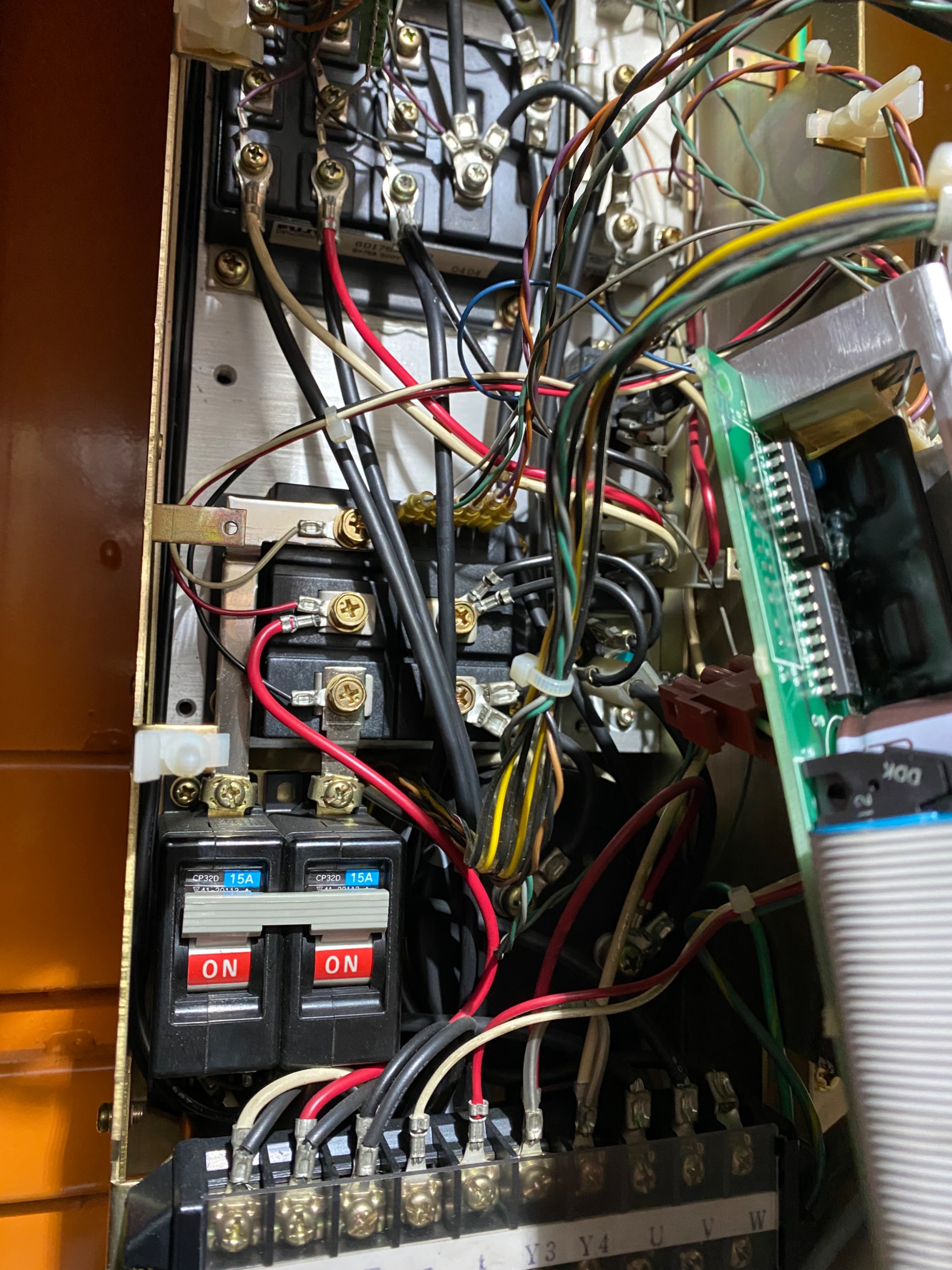

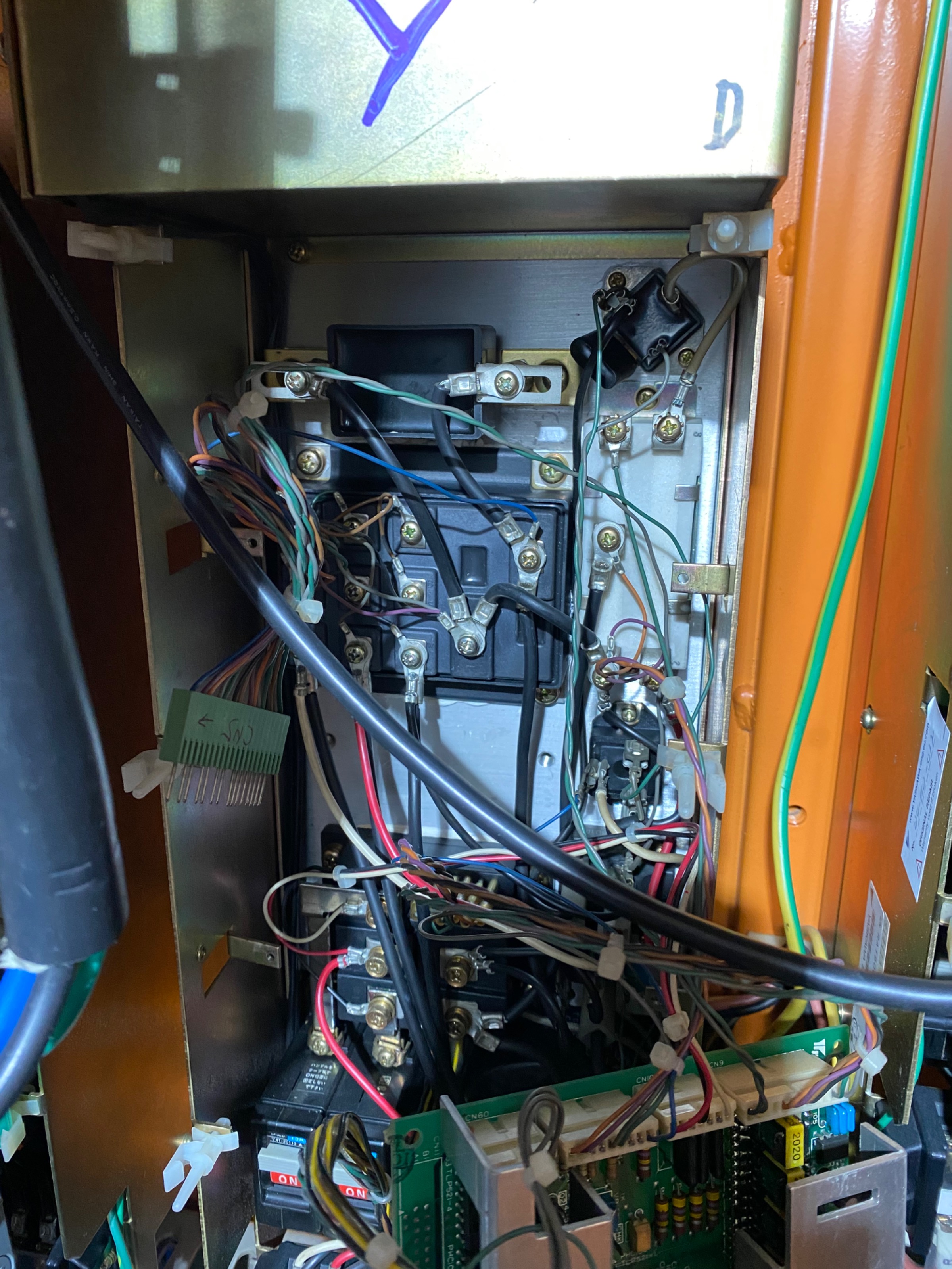

Today I compared both converters and started to check and measure component by component.
I noticed that there was a problem with the main switch on the "new" spindle driver.
If I switch it on, I can measure continuity under the individual phases at the output to the small transformer, which should mean that there is a short circuit.
The large fuse in the converter itself is ok.
We will continue to examine the converter over the next few days.

we have found the error why the spindle driver always displayed undervoltage as an error. Since we don't have an inrush current limit yet, we always switched on the fuses one after the other. However, when you switched it on, you had a different voltage on the phases for a short time. The converter noted this condition and it was not possible to delete the error. If I switch on all 3 phases at the same time, no error appears and the spindle driver works.
