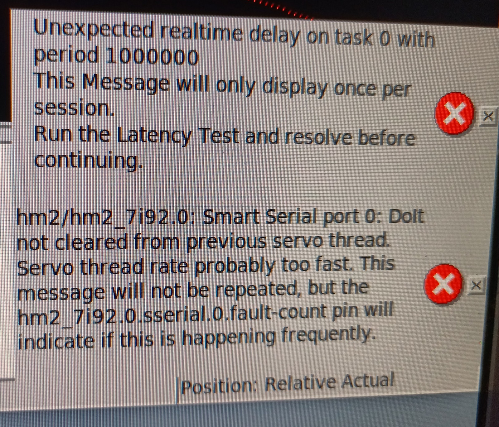

26 Feb 2022 11:16 #235854
by radom
Replied by radom on topic Chiron FZ 18 S retrofit
thank you for the scans,
I get rid of of all the old air valves and installed one single 5/2 valve for manual toolchange
I need to regrease the spindle bearings because they are incredibly loud, or maybe even change them but I keep putting it off, I don't know if I'd be able to disassembly the spindle
another issue is my pc is not up to par, I'm getting errors:
Unexpected realtime delay on task 0 with period 100000
hm2/hm2_7i92.0: Smart serial port 0: dolt not cleared from previous servo thread
hm2/hm2_7i92.0: error finishing read!
latency is around 110.000 is that too much or could it be ethernet problem?Fujitsu S720 AMD GX-217GA with RTL8111/8168/8411 PCI Express Gigabit Ethernet Controller Linux fuji 4.19.0-17-rt-amd64 #1 SMP PREEMPT RT Debian 4.19.194-2 (2021-06-21) x86_64 GNU/Linuxradom@fuji:~$ halcmd show param *.tmax
Parameters:
Owner Type Dir Value Name
26 s32 RW 0 hm2_7i92.0.read-request.tmax
26 s32 RW 1562510 hm2_7i92.0.read.tmax
26 s32 RW 342526 hm2_7i92.0.write.tmax
42 s32 RW 121449 ilowpass.0.tmax
19 s32 RW 44974 motion-command-handler.tmax
19 s32 RW 261740 motion-controller.tmax
39 s32 RW 67324 mux4.0.tmax
29 s32 RW 85587 pid.a.do-pid-calcs.tmax
29 s32 RW 65697 pid.s.do-pid-calcs.tmax
29 s32 RW 80970 pid.x.do-pid-calcs.tmax
29 s32 RW 63853 pid.y.do-pid-calcs.tmax
29 s32 RW 75640 pid.z.do-pid-calcs.tmax
20 s32 RW 1991729 servo-thread.tmax
32 s32 RW 65582 timedelay.0.tmax
32 s32 RW 67835 timedelay.1.tmax

- Posts: 22037
- Thank you received: 7505
26 Feb 2022 16:00 #235879
Replied by tommylight on topic Chiron FZ 18 S retrofit
In the .ini file, put back the servo period to 1000000 where it was, it will not work at 100000.

27 Feb 2022 00:35 #235894
by radom
thats my mistake, I was rewriting the errors from memory,
servo thread is of course 1000000 in .ini
