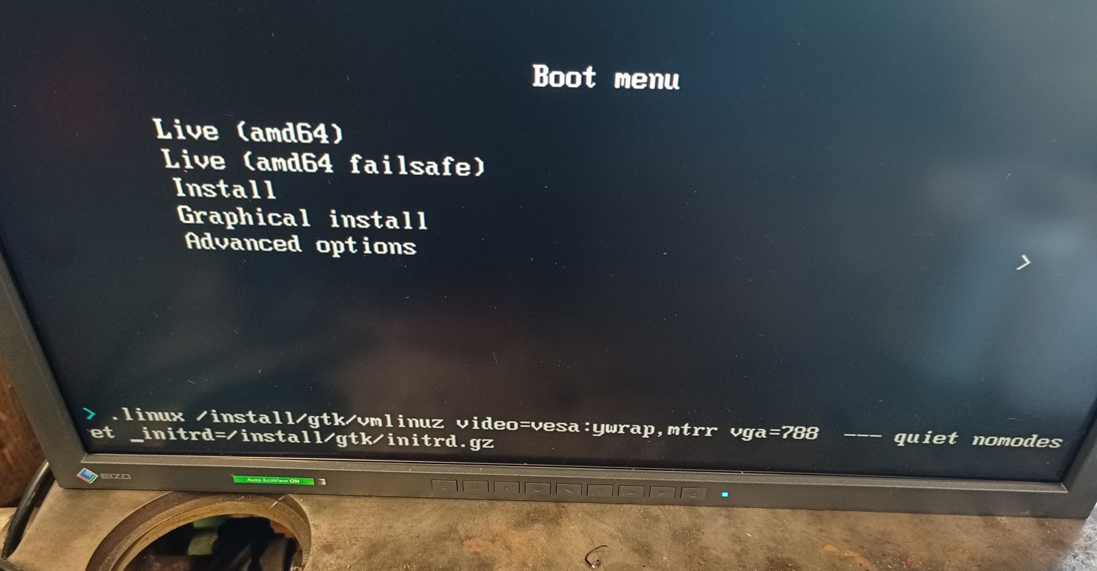

03 Mar 2022 15:41 #236269
by radom
Replied by radom on topic Chiron FZ 18 S retrofit
I bought used dell optiplex 780 and can't even start the installer, screen turns black and that's it
md5sum is ok, windows7 boots and works ok, but no matter what I choose, install, graphic install or live cd it just turns to black screen

03 Mar 2022 15:44 #236270
Replied by tommylight on topic Chiron FZ 18 S retrofit
Boot, hold down "shift" button, when you get the grub screen press "E", then add:
nomodeset
after "quiet splash"
nomodeset

03 Mar 2022 16:06 - 03 Mar 2022 16:07 #236273
by radom
Last edit: 03 Mar 2022 16:07 by radom.

03 Mar 2022 17:17 #236279
Optiplex 780 normally came with an add on graphic card, is it still there?
If yes, shut the PC down and remove the graphic card.
