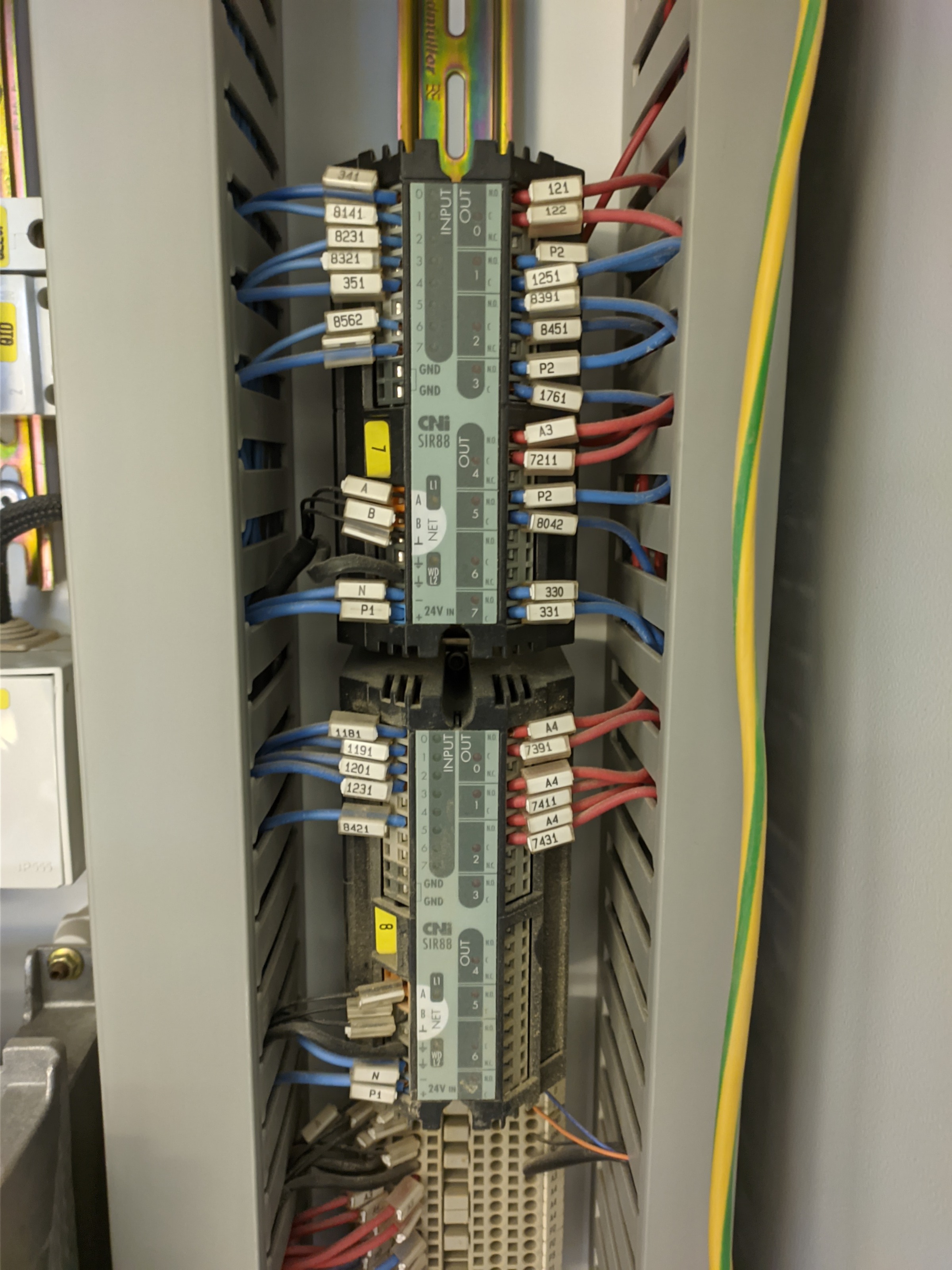

Regarding modules: As I said, CNi did not have any documentation about the communication protocol, but they sent me two-page brochures of SI816N, SIR88N, SI24N, SO24N and SO816. I've attached the PDF for SIR88N. My modules only say SIR88, without the N, so I'm not sure if they just omitted the N on the front lable or if they're two different things.
If my Biesse indeed has the SIR88N, then according to the PDF, the inputs should be sinking, which contradicts what the Biesse schematics and Yaskawa manual say.
About field voltages: Some of the Mesa cards have VIN and VFIELD separate. I was thinking about putting P1 on VIN and P2/P3 (depending on the module position) to VFIELD. Did you do the same?

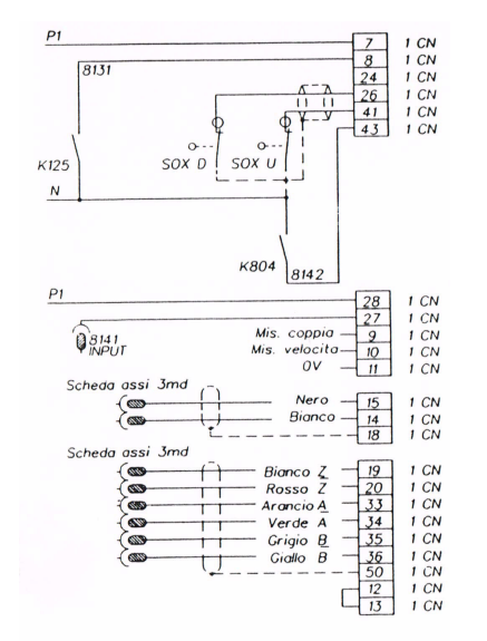

This is page 72 from the Biesse schematics. On the left side, we see input 8141 going to pin 27 on the Yaskawa drive connector (X) in this case).
And this the connector pinout from the Yaskawa manual.
In fact, I now see P1 is connected to pin 28 - so I guess it's an isolated output which sources whatever is connected on pin 28 to pin 27. Which would indeed make the inputs sinking, which also means I was on the wrong track for a whole while and I can just hook this cable (pin 27, formerly going to input 8141) up to a 7i77 input.
I think I see clearly now, or am I wrong again?

03 Feb 2022 12:42 #233869
by bevins
Replied by bevins on topic Another Biesse Rover 322
P1 is 24vdc.
You can see that in the beginning of the schematics and on the modules. That is what Biesse labels the first iteration of 24vdc.
The P1 is what ios powering the digital side of the drive.
Those modules are the RS485 modules that you cannot use. Those are inputs and outputs.
You need to provide a relay for each of those outputs and the inputs you can take directly into 7i77 if you are using the 24vdc from tyhe 3 phase rectifier in the machine. You need to watch which voltage you are using.

- bevins
- Posts: 1947
- Thank you received: 338
03 Feb 2022 12:45 #233870
by bevins
The N and P1 is the 24VDC for your drive logic. The inputs in the drive needs the 24vdc common to see an input.
P1 - +24vdc
N - com
P1 - +24vdc
N - com
The following user(s) said Thank You: ehb

03 Feb 2022 13:01 #233875
by bevins
Your ideas on VIN and field power are not ok. I just went back and read them. VIN is logic power and P1,P2,P3 is the same power but different iterations. You get get P2 and P3 after some logic or when it passes through a relay. Would have to look in your schematics but you really need to look at this setup carefully.

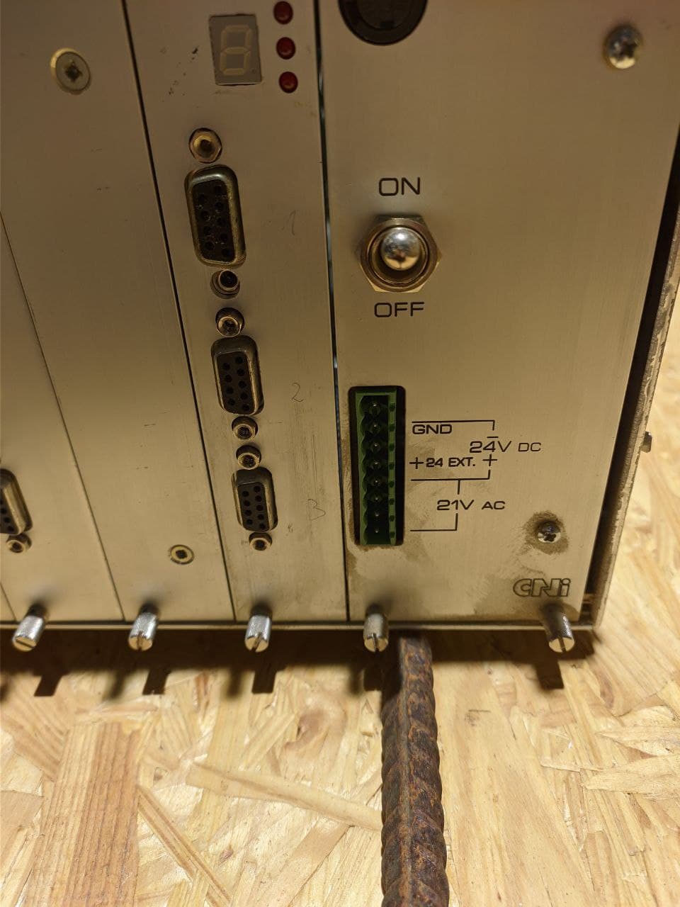

I too have a 322 building in MESA 7I76 and 7I77 to replace the controller
Did you conclude what the 21V AC was for?

My understanding is
P1 is 24V when machine is powered on.
P2, P3, P4 are on based on the condition of the Emergency Device E22 (see columns 14-16 of the drawings)
The Mesa manuals advise not to use power through switching devices.
- Posts: 21980
- Thank you received: 7480
09 Sep 2022 10:10 #251540
Replied by tommylight on topic Another Biesse Rover 322
What drawing?
