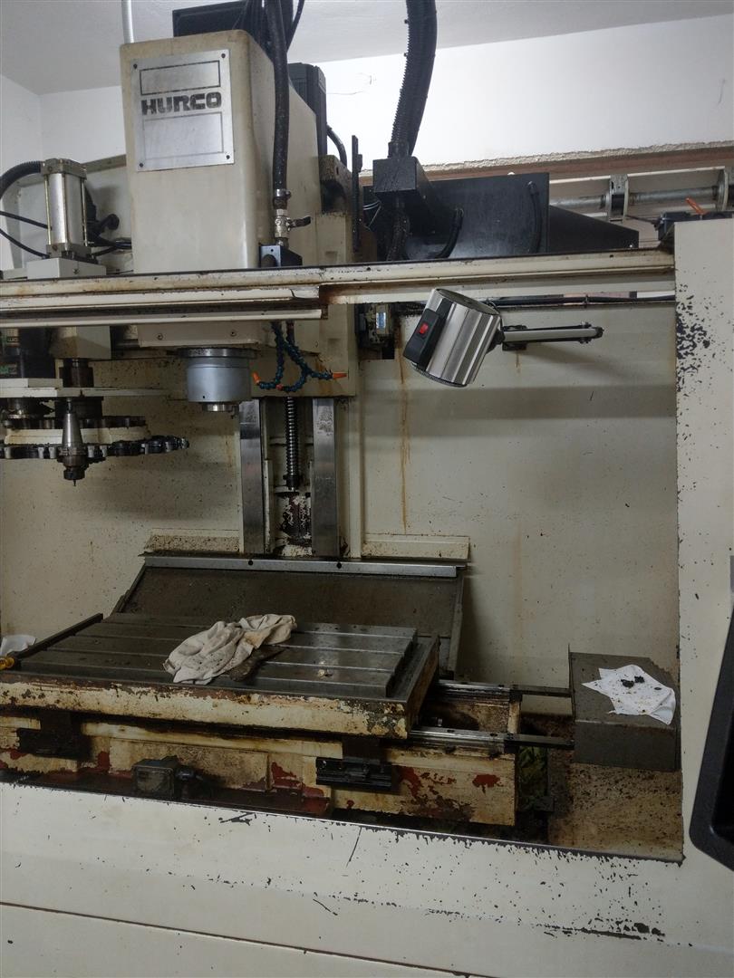

Greetings to Everyone!
I have been reading and examining the LinuxCnC community for quite some years now. Almost five years ago (when my knowledge on electronics/programming was fairly limited) I have decided and made from scratch a 3-axis CnC machine using Mach3. Now, after some fails and successes, and having become an owner of a Hurco BMC 20P (for the past 8 months), I believe the time has come to start reverting everything to LinuxCnC rather than trying to upgrade more “closed” systems/software as mach3 or reusing them to another machine.
I have seen some excellent posts with ideas/files/photos about retrofitting the Hurco BMC 20 (from tommylight, bruno2626, and many others) and decided that I have to give it a go! The machine currently is in a working state but its old electronics (mid ’90) are keep reminding me their age and giving me a hard time trying to solve errors codes (which nobody knows anything about them), replace parts which are very difficult to find (and with unbelievable long lead times) and load cutting programs to start making some metal chips (only by a serial cable or with a floppy disk…)
So, in plain words, I’m prepared to get really busy the coming months, give life again to this machine, and any help will be honestly and greatly appreciated!
Apologies in advance if in the process of this retrofit I become an “askhole” but sometimes I’m interested learning “why” doing something rather than “how” to do it.
 At the moment my Hurco BMC 20P has the following features/modules

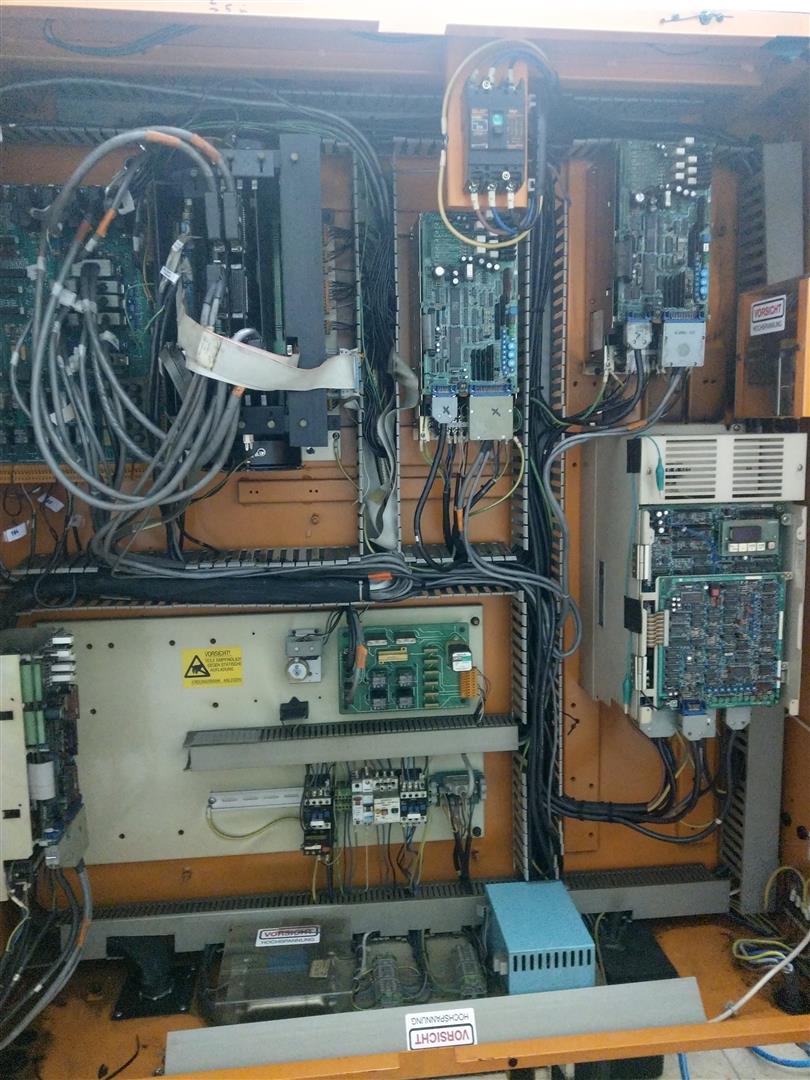

Servo Drivers: Yaskawa servopacks CARC-SR10BB1BF.
Servo Motors: Yaskawa USAFED -09FB1S with UTOPI-500UA Encoders.
Spindle Drive: Yaskawa CIMR-MT III – 7.5K (Transistor Inverter)

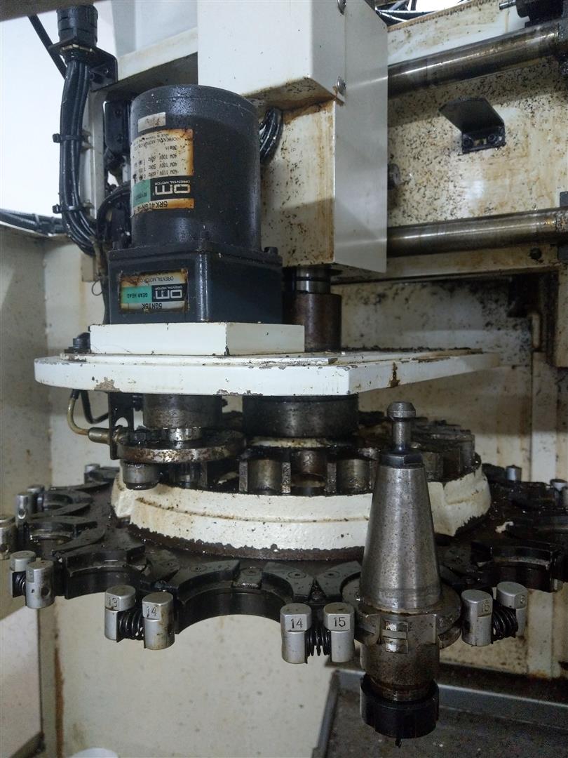

Tool changer: 16 Tools, Carousel type (two pneumatic pistons for up/down/left/right and one AC motor for rotation)

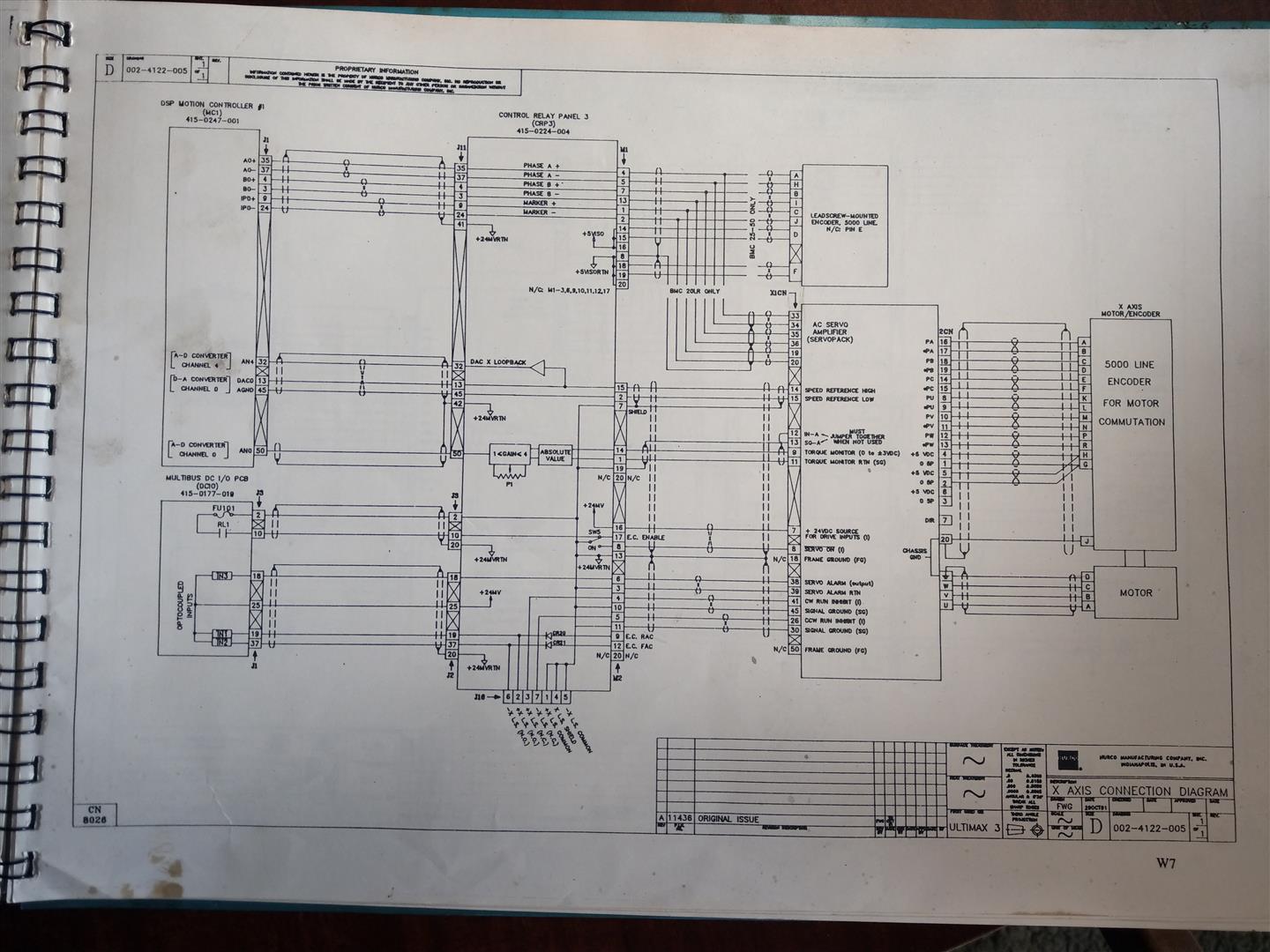

The machine has all its original documents including wiring diagrams which is always a good starting point
Some photos are attached, some parts are removed since we have entered the cleaning/modifying/replacing process.
Some initial questions before start gathering all necessary hardware…

7i70-> Connect receiving signal from limit switches from Carousel Tool changer (up, down, left right), receiving signal from limit switches from moving table (X-+,Y-+) and moving column (Z-+)
7i71 -> Connect to coolant pump, connect tool changer turning motor.

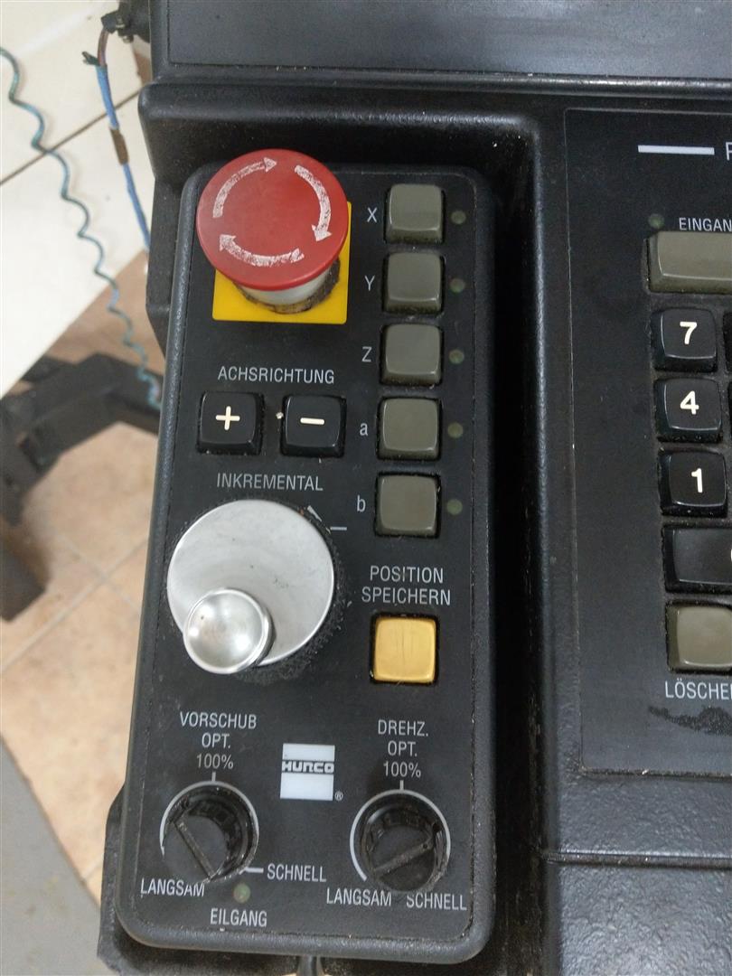

Query 2: Pedant
I have seen that it might be possible to use the Hurco’s Pedant control to the LinuxCnC, will a 7i73 mesa card connected directly to the 7i74 work?
If yes, how the rest of the signals (like position marking, spindle speed) will have to be connected through this card? Will I have to use an extra card to perform these operations? (Something like 7i84D)

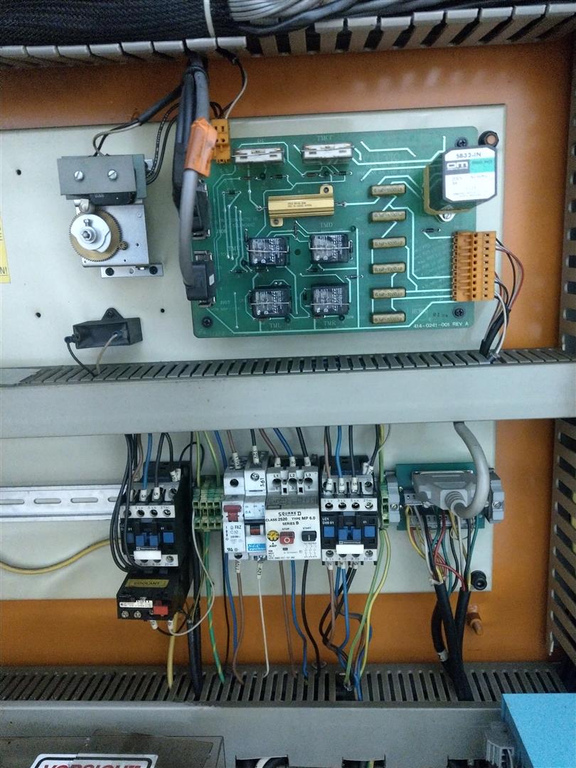

Remove the console stuff and put a PC with a 24 inch screen, remove the upper left side with the controller, leave everything else as is, yeah, do not remove the toolchanger board!!!
Yes
Some things can connect to the 7i73, where the wiring is convenient (though it's only good for 5V signals)
Make a list of all the inputs and outputs, and where they can be conveniently wired to, then choose cards to suit.

Pretty sure i wrote somewhere that i connect e-stop to 7i70 and enable relays from 7i71, this way every card must be working for the machine to enable, any issue in between will render the machine useless.

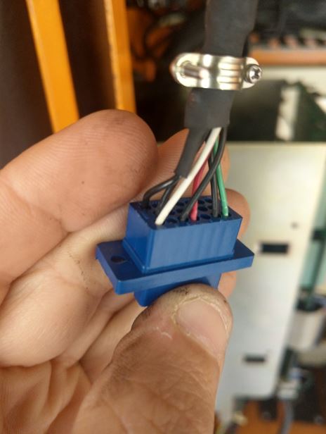

As my biggest concerns are the encoders, I forgot the list of the i/o and started with them… At the existing machine the “control relay panel” has 3 connectors (X,Y, and Z) “From encoders”, opened up one and found 7 cables… (I could say without really knowing that 6 cables are A/A, B/B, Z/Z, what is the 7th?) I’m trying to figure out which ones I have to connect to the 7i77, any help is appreciated, photos are attached (wiring diagram, connector photo).Edit:… Rewriting my query, I’m most probably missing combined information how servos are controlled through the 7i77, or how the “loop” is controlled and closed with or within the Yaskawa servopacks…
Beware that coming from a stepper motor system, still trying to close the loop in my head first how things should be working… Reading around, I have seen that there are several “modes” for configuring the machine, most probably I should be looking to get “velocity mode” instead of “position mode” but don’t know their differences (also there is “torque mode”?). Could someone point me to a direction where to look?
@smc.collins -> All diagrams have been scanned, unfortunately my phone wasn’t doing the job right, so scanned everything from photos. Let me know how I could post/send them to you (due to size of these drawings and for being able to read them total pdf size is about 240Mb).

Question C. (I could say without really knowing that 6 cables are A/A, B/B, Z/Z, what is the 7th?)
Shield or ground or neutral, in the schematics labeled +24VRTN, wired to the drive side, not the controller/7i77 side.
Use google if you do have an account.
