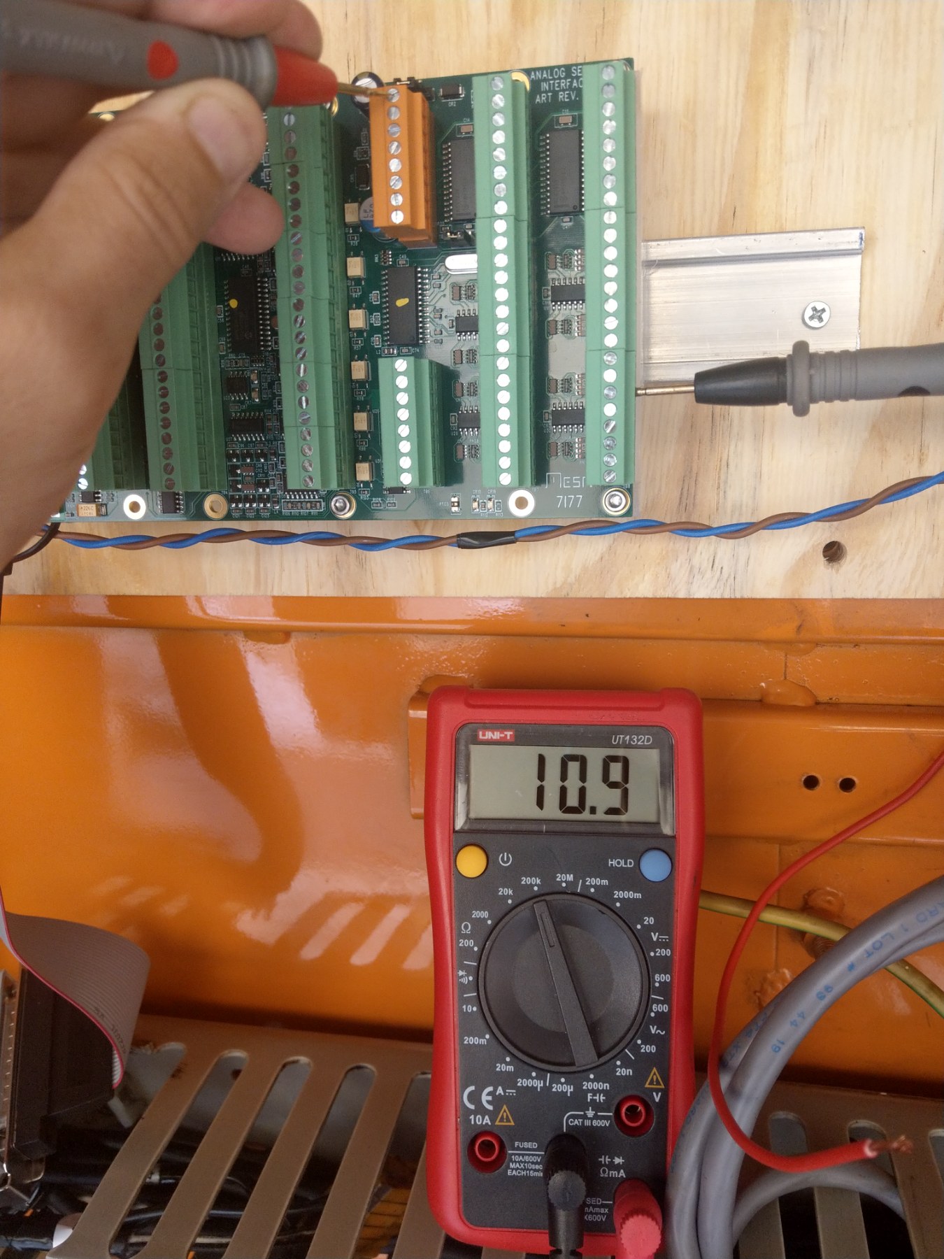

Now, I have a different question. As you have noticed correctly, the 7i77 has a 20kΩ input resistance, but when I have checked the resistance using a digital multimeter, I’m getting a different result (with no power anywhere).
Attached a photo, why am I getting 10.9kΩ? Do I have a different version of a 7i77?
Thanks for putting up with me.
As my level of electronics is obviously lower than the one needed to get everything wired up fast, I decided to start a wiring diagram so I could evaluate all connections beforehand. I will share it with you when it comes to a “readable” state.

26 Aug 2022 09:19 - 26 Aug 2022 09:21 #250498
Impedance and resistance are not the same thing, although pretty close.
So 11Kohm would be roughy 2.5mA or 0.0025A.
Short explanation, impedance is resistance that changes depending on voltage or current, so it is used for inductive loads, like speakers.
Replied by tommylight on topic One more HURCO BMC 20P Retrofit
From the 7i77 manual, the inputs have a nominal 20 kΩ input impedance
Last edit: 26 Aug 2022 09:21 by tommylight.
The following user(s) said Thank You: smc.collins, christos

26 Aug 2022 12:37 #250508
by smc.collins
Replied by smc.collins on topic One more HURCO BMC 20P Retrofit
id6 not be worried about it the difference between 11k and 20k in terms of current is inconsequential amd maybe be a result of your meter not being accurate. many meters are not accurate. if you are measuring resistance check from the 7i77 ground terminal on the tb connectors to your input.
The following user(s) said Thank You: christos

27 Aug 2022 09:29 #250565
by arvidb
Replied by arvidb on topic One more HURCO BMC 20P Retrofit
You cannot measure resistance of semiconductor circuitry like that. The DMM applies a small, known current between its test leads, measures the resulting voltage, and calculates the resistance using Ohm's law (U=R*I). This only works with purely resistive elements, not with semiconductor parts. The result will be nonsense - for example, you are likely to get a different value by simply switching the test leads around.Attached a photo, why am I getting 10.9kΩ? Do I have a different version of a 7i77?
The following user(s) said Thank You: tommylight, christos
