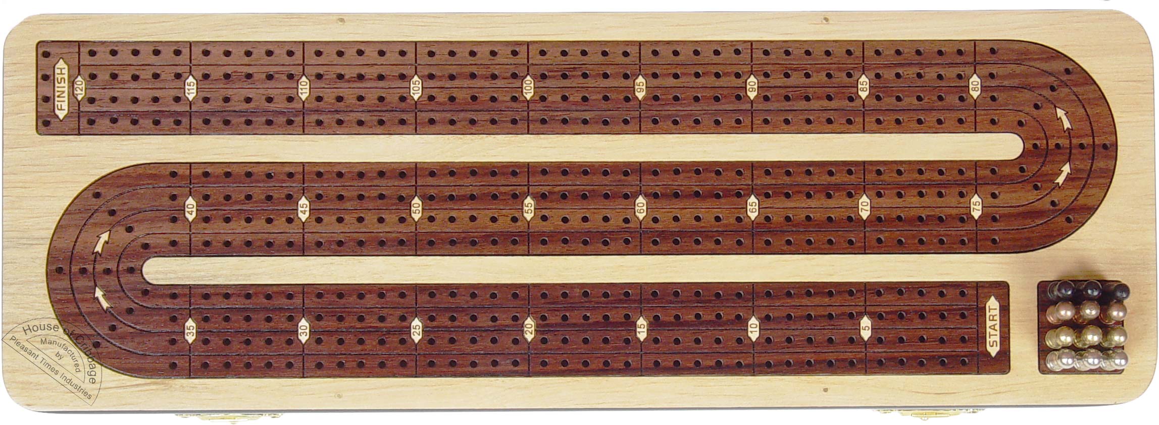

That does sound like a lot of trial and error over and over. If you know the dimensions and the layout you can create it in QCad. The reason you use vector CAD for machining is each line and point is exactly where you want it. Any time you try and use bit map you will have errors.
Even a board like this one would be simple (for me cause I know how) to lay out in QCad.
Draw the lines then split the lines by how many points you want then add the points to end of each line. Just make sure you put each separate operation on different layers. Even with the curves being a different radius you split them all the same number of times and you end up with the board above. I can make a screencast if you are having trouble following what I'm talking about.
JT
