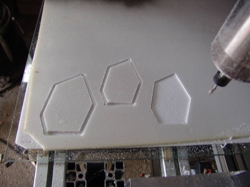

Okay...this is a new one;
I am attempting to make a POCKET. I have drawn out the outline in QCAD, loaded it into LinuxCNC and it looks just swell!
So then I draw in the pocket. Making each line approximately .125 apart (using a .25" bit) until I reach the middle.
One end is a semi-circle, and to make that I selected from the menu=
[Arc Tools], then [2 points and Angle]. I clicked one end, and brought it to the other end, enclosing the shape. = it worked just swell.
HOWEVER -
When I do this with the pocket operation, I'm getting an error that "radius to end of arc differs from radius to start"
I don't know how that can be. I used the 'snap-to-grid' and in the Properties window everything checks out~!
The first one worked just fine...In the event that there are too many for Qcad to understand/process, I will delete every other one and try it again.
Suggestions? Ideas?
Thanx -

How many digits is the CAM using? LinuxCNC is rather finicky about arc numbers, and might need more precision in the numbers (if you can change that in the CAM)

27 Mar 2014 15:19 #45305
by ArcEye
I recently used LibreCAD, which is a debian fork of QCad, using Qt4 instead of Qt3
I had endless problems with joining arcs. No matter how much you enlarged the view the lines seemed to meet, but the gcode paths did not.
I discovered this when deleting part of an entity to find it was comprised of far more sections than it should have done.
I then used 'snap to entity' which gave apparantly the same result, but in fact ensured that the paths met at a precise point.
May not be your actual problem, but worth bearing in mind
regards
Replied by ArcEye on topic QCad CAM
regards

I beleave your error may have to do with relative-absolute I and J values. Standard Qcad-CAM , Linuxcnc and my Geko 540 uses relative.
I have noticed Andrew has written a absolute config file.
srl
