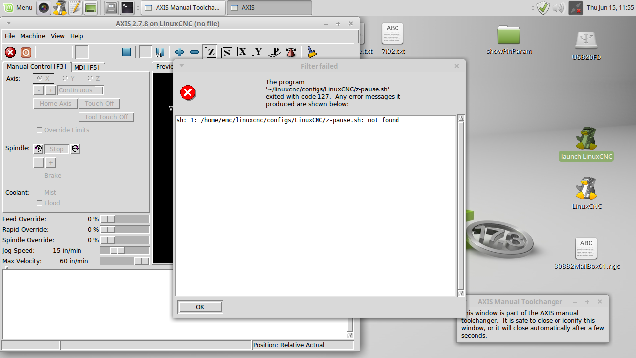

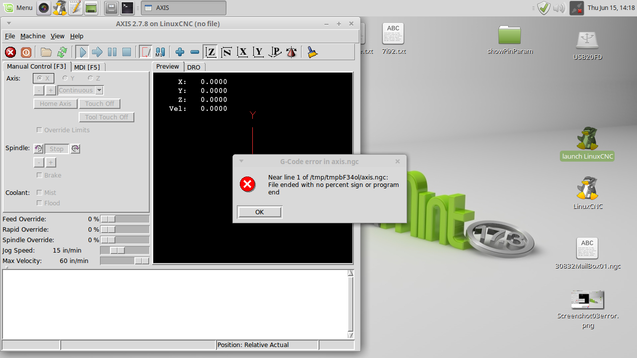

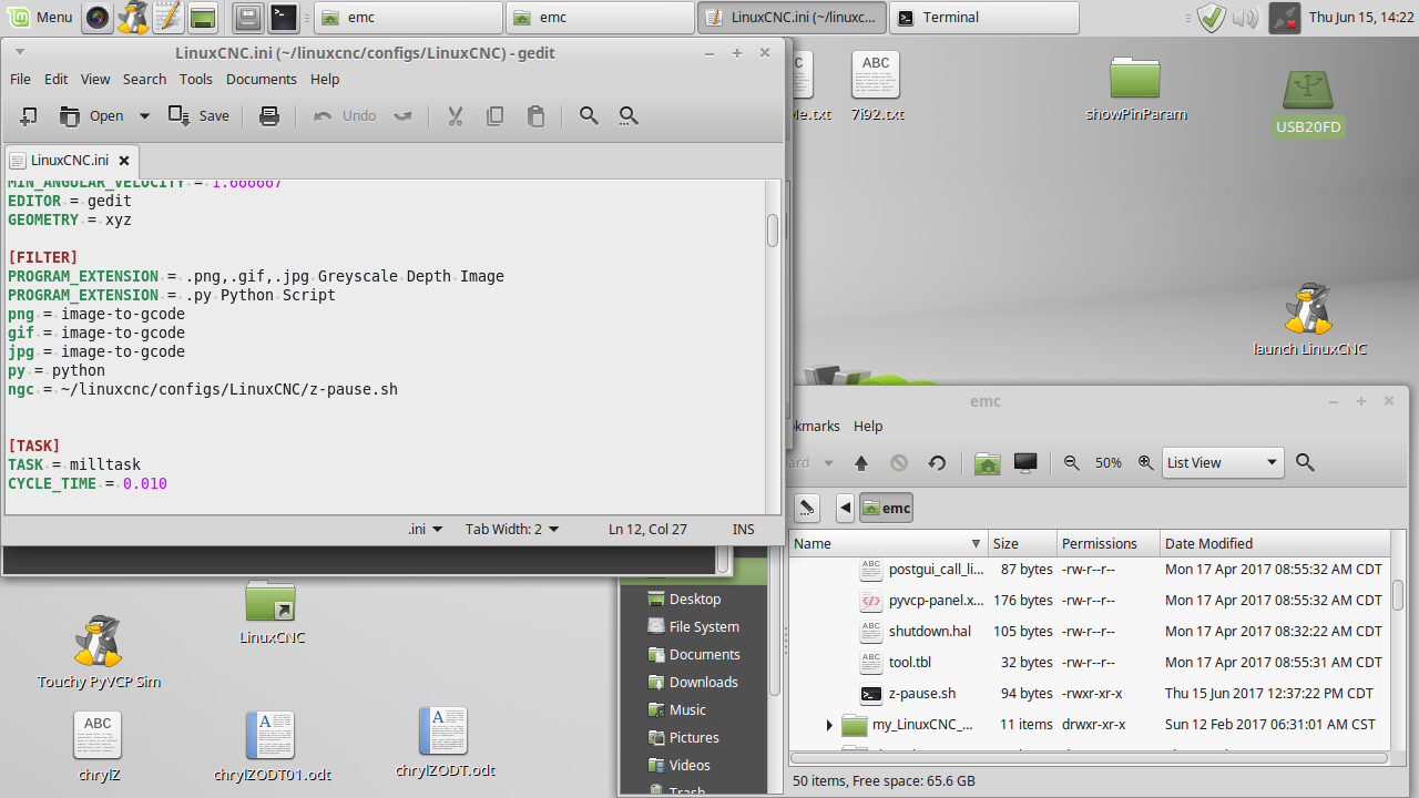

15 Jun 2017 13:22 - 15 Jun 2017 13:35 #94535
by new2linux
Replied by new2linux on topic PostProcessor or ISO a script to insert M0 for "Z" (Linuxcnc & BobCad v23)
Many thanks, Todd!
I have the following screenshot of my current progress.
The permissions were granted by rt click on "z-pause.sh".
The .ini file is below, but will cut and paste "FILTER" section here:
[FILTER]
png = image-to-gcode
gif = image-to-gcode
jpg = image-to-gcode
py = python
ngc = ~/linuxcnc/configs/LinuxCNC/z-pause.sh
Many thanks

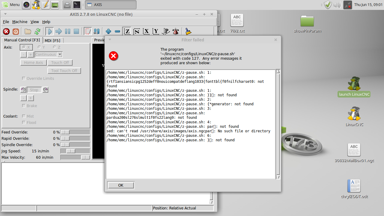

- Todd Zuercher
- Posts: 4785
- Thank you received: 1476
15 Jun 2017 14:42 #94540
Replied by Todd Zuercher on topic PostProcessor or ISO a script to insert M0 for "Z" (Linuxcnc & BobCad v23)
That is odd, the same script file works for me. Aside from some messing up the find and replace in some comments and other such things.
Not sure where your errors are coming from. But the problem is not in your ini file or the path to the script. it is being found and ran. The problem is in the script file it's self.
What did you use to create/edit the script file?
You can't use a word processor, you have to use just a plain text editor.
- new2linux
- Posts: 711
- Thank you received: 9
15 Jun 2017 15:03 #94541
by new2linux
Todd, I must confess I copied (from your example) and pasted to create new file, that I renamed to the .sh extenstion. I will review and start from scratch if necessary. The script file is the one that needs attention, I will work on it.
many thanks!!

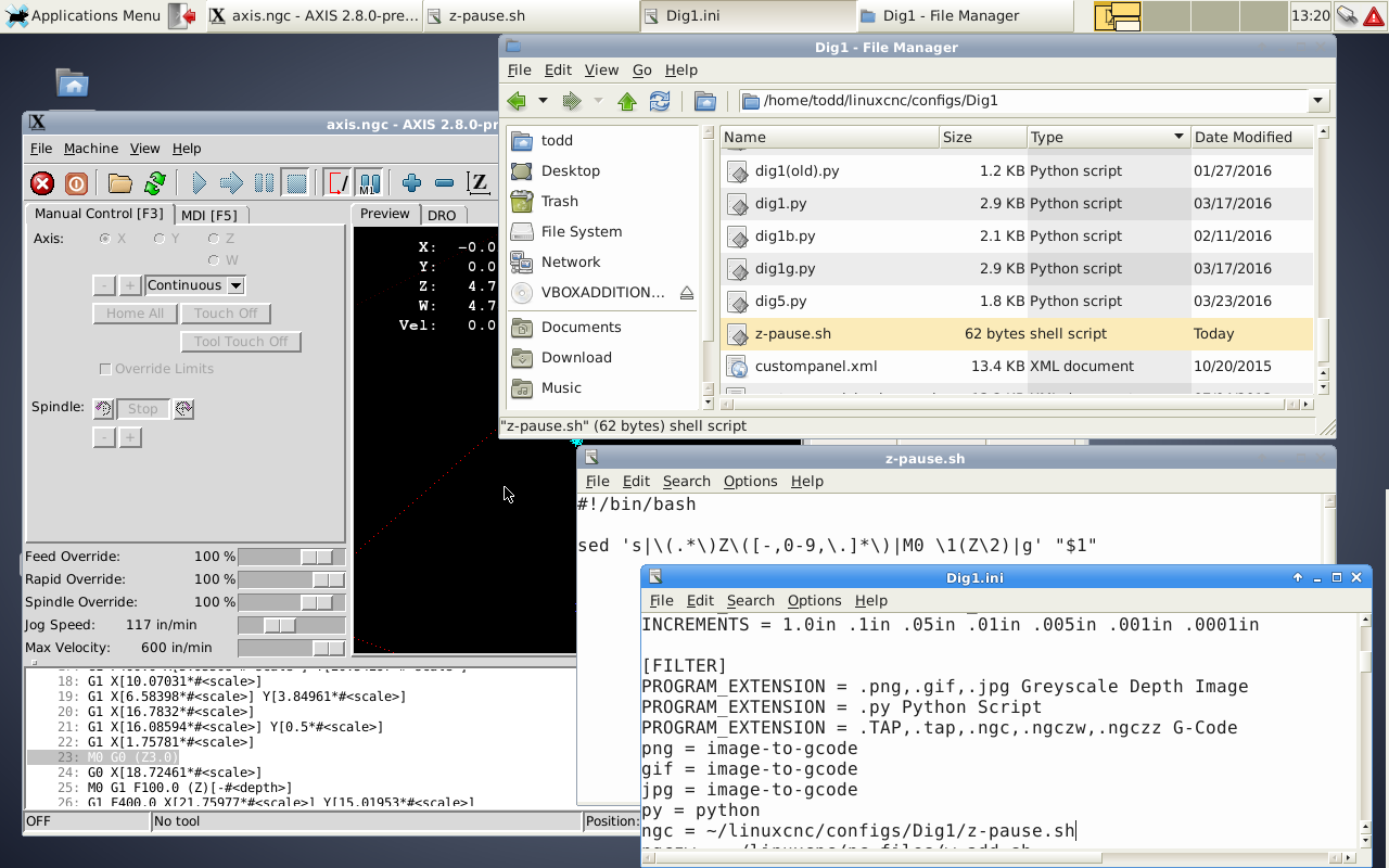

- Todd Zuercher
- Posts: 4785
15 Jun 2017 15:24 #94543
Copy the file I attached above, and rename it.
- new2linux
- Posts: 711
15 Jun 2017 16:08 - 15 Jun 2017 16:10 #94546
by new2linux
Todd, Many Thanks!!
I used your advise, to start with the file you attached, rename it, to sh, used "notepad" for new file. The screenshot is attached:
I have reviewed the .ini file, looks correct; reviewed the sid after copied to conf folder. looks ok. Not shore where to review/look.
Many Thanks!
Edit: after coping, I set permissions again.
Many Thanks!

- Todd Zuercher
- Posts: 4785
15 Jun 2017 17:29 #94548

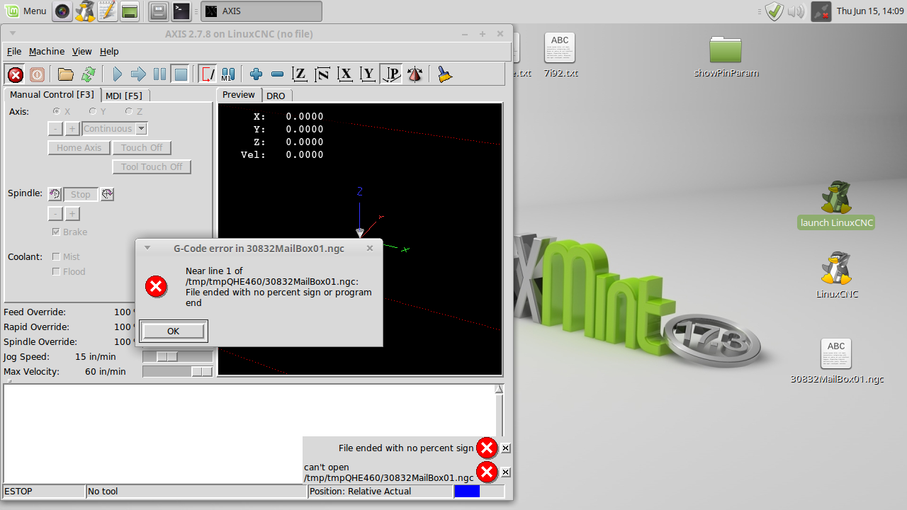

15 Jun 2017 17:40 - 15 Jun 2017 17:54 #94549
by new2linux
I did not show 62 bytes shell script, am looking in to now, and shows 1KB.
Edit: after looking to see it appears the attachment has maybe an issue, but it is probable just me. I am still working this, is it the same to cut & paste in a note pad type of software, vs. copy your original file with file management type of software and save that as the .sh file?
