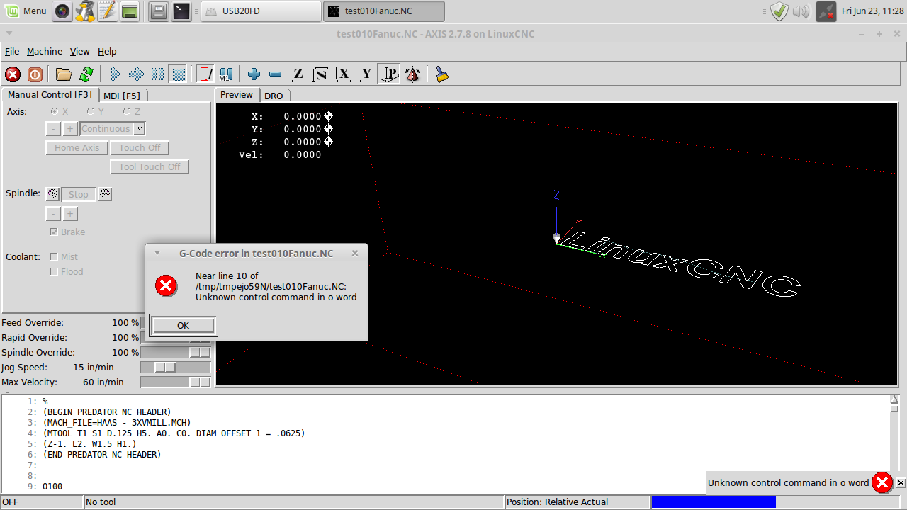

23 Jun 2017 15:53 #94853
by new2linux
Replied by new2linux on topic PostProcessor or ISO a script to insert M0 for "Z" (Linuxcnc & BobCad v23)
Thanks, Todd!!
I used the sed script you suggested. Attached is a screenshot of an error, the "o word" and the g code in question, a profile with 2 islands.
Will I need to tweak the code each time? What should I be looking for, is there any suggested reading?
Many, many, thanks! All comments, warmly welcomed!

23 Jun 2017 16:28 #94855
Replied by Todd Zuercher on topic PostProcessor or ISO a script to insert M0 for "Z" (Linuxcnc & BobCad v23)
I had tested it and it should have taken care of the bad "o word".
My guess is that the filter was not actually ran on that file as it loaded.
What was the file extension on the file you were opening?
Could I see what you have in the [FILTER] section of your ini file?

23 Jun 2017 17:45 #94860
by new2linux
Thanks, Todd!!
The ability to use .NC or ngc file extension seems to work. The "o word" error is still there.
Many Thanks!
Many Thanks!

23 Jun 2017 18:24 - 23 Jun 2017 18:25 #94862
This line in it should have deleted the o-wordMake sure it is there in it's entirety and that the "O"s and "0"s are correct.
It should find any line starting with a capital O followed by a string of one or more digits to the end of the line, and replace that with nothing.
s|^O[0-9]\+$||gIt should find any line starting with a capital O followed by a string of one or more digits to the end of the line, and replace that with nothing.
