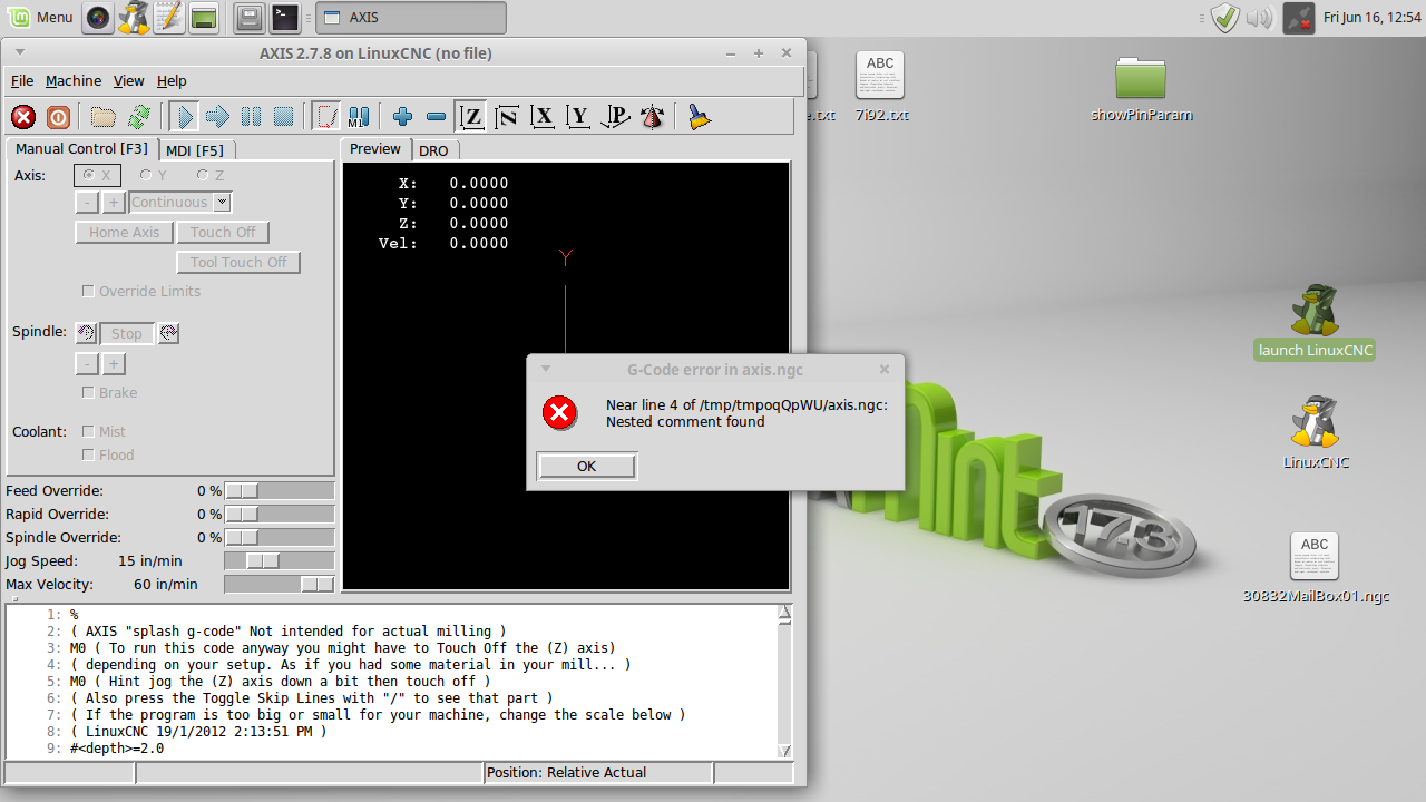

16 Jun 2017 17:15 #94603
by new2linux
Replied by new2linux on topic PostProcessor or ISO a script to insert M0 for "Z" (Linuxcnc & BobCad v23)
Todd, Many Thanks!
I keyed the raw data in to linux's text editor for the "sh" file, saved it to the correct conf folder. When I read your comment I went back to the file and edited with the (echo "%") 2 places as per your sample. Then saved and set permissions again, then restarted computer.
See the screenshot:
any suggestions
many thanks!!
See the screenshot:
any suggestions
many thanks!!

16 Jun 2017 17:37 #94606
Replied by andypugh on topic PostProcessor or ISO a script to insert M0 for "Z" (Linuxcnc & BobCad v23)
It looks like the system doesn't like nested comments
(this is a comment (and this is a nested comment))

16 Jun 2017 18:16 - 16 Jun 2017 18:21 #94614
Replied by Todd Zuercher on topic PostProcessor or ISO a script to insert M0 for "Z" (Linuxcnc & BobCad v23)
That will be expected behavior with the g-code from the Linuxcnc demo file. Because there are Zs in the comment section. .
The opening screen g-code is an anomaly with lots of commented text and parameter values used for moves. "Normal" g-code should not present a problem with the old scrip.
Here is a modified version that works on the opening screen.
#!/bin/bash
echo "%"
sed '
s|\(.*\)Z\(\[.*\]\)|M0 \1(Z\2)|g
s|\(.*\)Z\([-.0-9]\+\)|M0 \1(Z\2)|g
' "$1"
echo "%"
Last edit: 16 Jun 2017 18:21 by Todd Zuercher.
