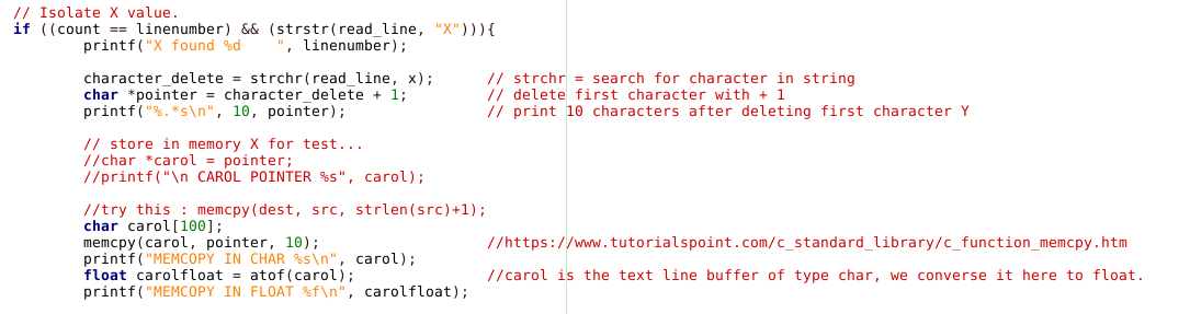

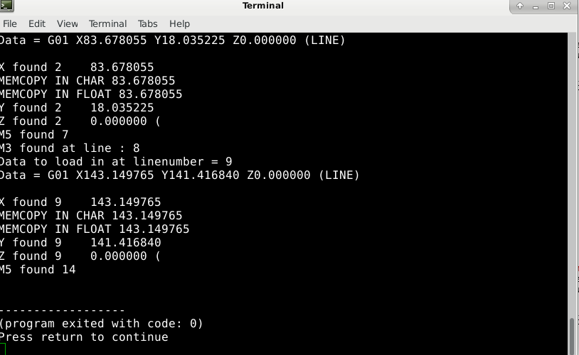

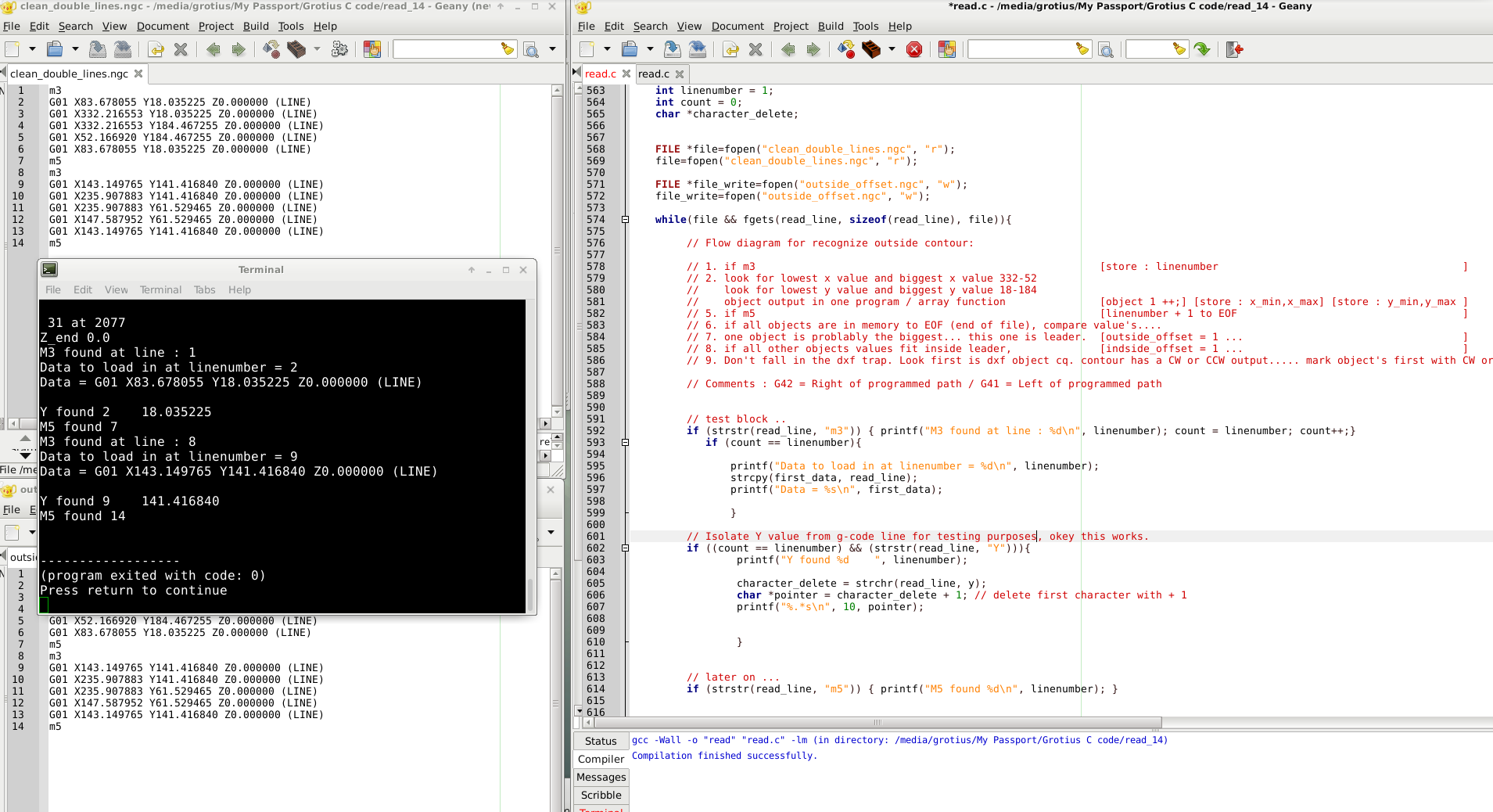

Okey i am little futher in proces.
Tonight i had to store an x,y or z value of a certain g-code line into memory to compare the biggest objects.
I had to converse a character to a float. This week i must make a compare function for comparing all the value's within one g-code file.
I have used a new funtion called memorycopy. memcpy.
This is handy for copy the first 10 characters after X.. instead of copy a whole line into the memory. I need only a X value of type float.
So the atof function converses the string into a float value.
Later on i must make a kind of array i think to compare all the value's inside the g-code file.
For now it works so far.

You probably do not need to copy stuff into the static buffer at all. If you use a pointer , you can point to any position in the string you are copying from so you can access it directly.
I'd probably consume each character in the line
while(pointer++){
switch(*pointer){
case 'x':
case 'X':
pointer++; // skip the letter
// convert the number into a structure
axis->x = atof(pointer);
break;
default:
