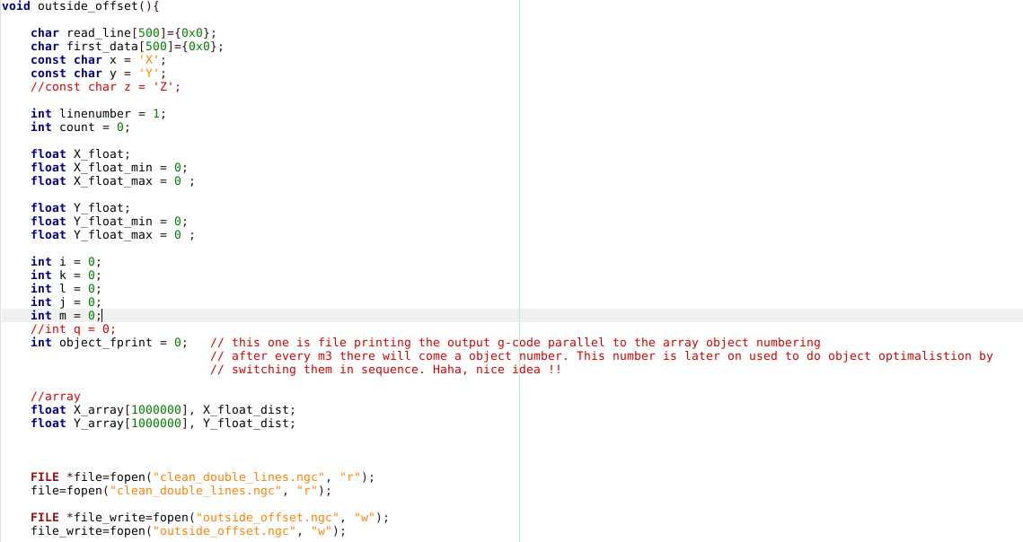

19 Feb 2019 18:09 - 19 Feb 2019 20:16 #126778 by Grotius
Rod,
Dvt is something i don't know. Problably because i never seen such a string.
The complete function an sich is quite easy to understand. Even a new member can imagine the flow of the function.
Today i made usage of pointers and array's to find the biggest object's in the drawing. Okey that works.
But i must work at a perfect algoritme to compare all the objects in the drawing. I think this is the hardest thing to think about.

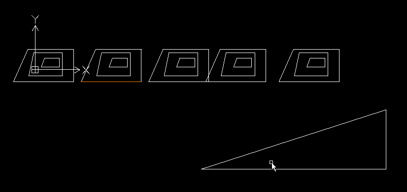

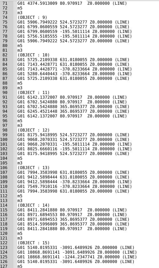

A sample drawing of objects.

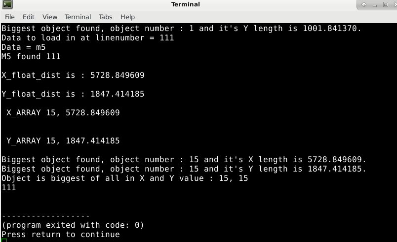

The output in terminal after the array's are calculated and compared to each other :
The drawing has 15 object's following the output ngc file. Following the Array calculation object 15 is the biggest object related
to x, y value.
I will first make a basic algoritme for the ngc file output. Let it work for simple drawings. KIS (keep it simple) first.
Anyone an idea in the mean time to add into the code?
If you think, i count 16 objects.... You are right. Counts start at object Zero. :silly:
That is something about computer code....
A picture is better to understand then a code preview at some cases.

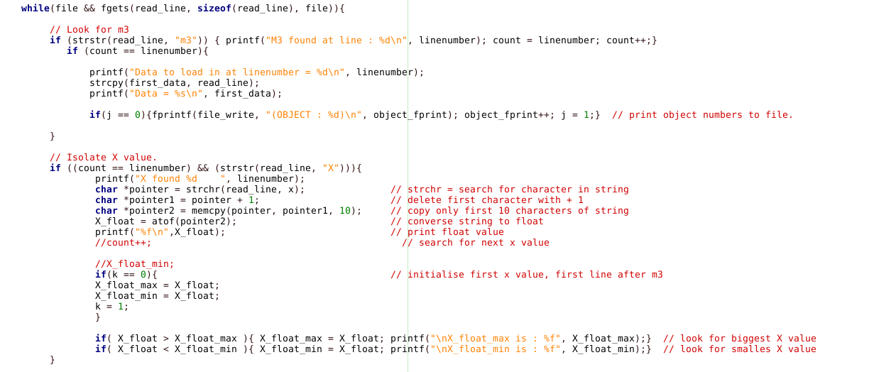

How i looked for the biggest object in dummy words :
1. Every ngc code has a m3 and m5. Beween this characters are g-code lines. M3 is tool on, M5 is tool off.
2. Between m3 and m5 is are multiple lines, they are spotted as object's, because their begin and end point correspondent's or
if they are open lines, they are also spotted by coding. You tell the c code what you want to do. And the c-code does what you want after trail and error. But how more you practice how easyer everyting becomes. Even writing a letter in English become's easy when you do it every day. So it's just a way of practicing and stay interested in what you are doing.
If i look what i did in 2 weeks, i think about military mainframes that need to be updated. But rewriting the old mainframes are a risk.
So the us and russia, they need good developers to guide a space missle coded in c. But it's all possible. We know our target and that is making a open source c coded dxfdecoder. I thank Rodw for thinking about the name. B) It's just a good name !!

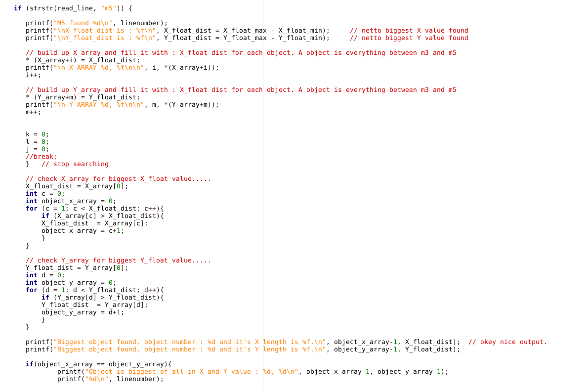

3. Every object is calculated seperately in lenght and width. Data is stored in array of 1 miljion lines for x and 1 miljion lines for y.
Making a dynamic growing array is something to do. But today i find that not important. Allocating memory is also something to do.
Allocating memory in the free zone, is something that atrract's me.

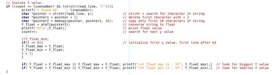

4. After the array's are made. We look at the array's and look for biggest x and biggest y value and look if it's correspondent's with the same object. If so, we say okey ... It's good.
But there are 100 way's to make an algoritme. So we must think about the best way simple way to declare inside and outside offsets.
Later on we can perfectonize this. For now a radical simple algoritme can fit 80% of typical cnc users.
Last edit: 19 Feb 2019 20:16 by Grotius.

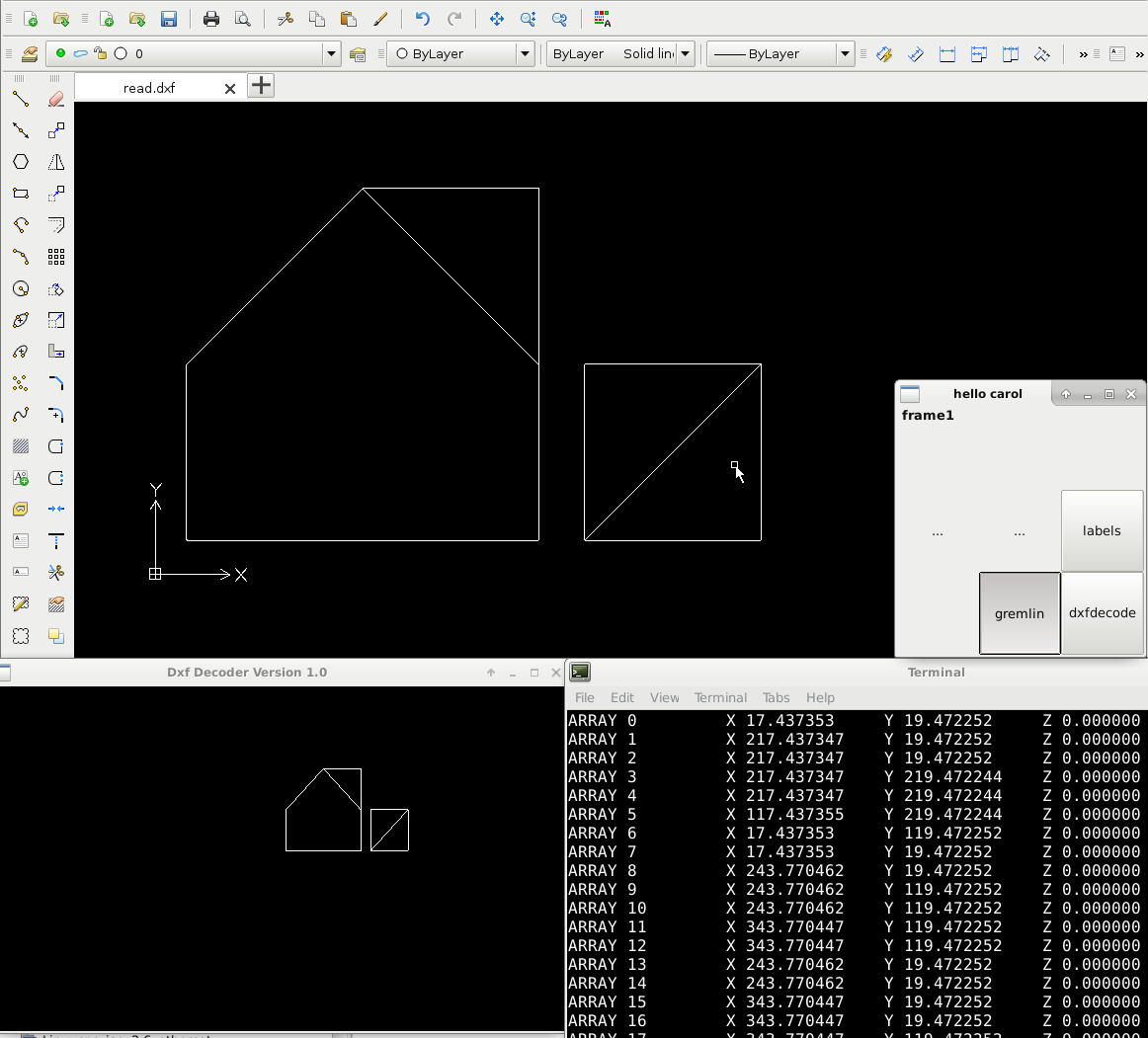

Hi, i have little project update.
At the moment i have coupled the c code to glade and to opengl
I saw some difficulties in the dxf i have to solve. The autodesk dxf is really set up as a mess.
So i have to sort everything, compare everything etc. But i have time.
I am short to develop a new cad program wich sort's all the object's before saving.
The Array's are fun to work with. We can do array's up to 9 axis, over millions of lines into the heap. :woohoo:

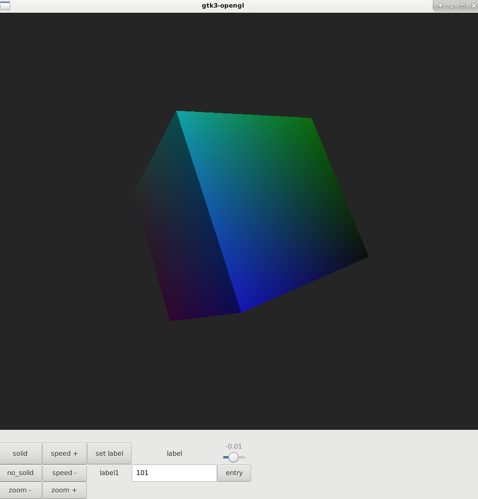

Hi, I have a project update. It's not much.
I had to study OpenGL in the past 2 weeks, because glut is a OpenGL pop up screen.
And we want integrated solution for the DxfDecode program.
It was hard to connect OpenGL to a c coded gui in glade.
But it works after trail and error. I am positive about the 3d functionality. Mouse function's and several button's are
interactive with the object rotation speed, zoom, etc.
In the mean time i tried QT for C coding instead of their integrated C++ coding.
In the first place. QT is very powerfull. Wtf. this is a huge program.
So maybe i will try to adapt my c code to QT and make a gui with .ui extension instead of .glade.
I realize the DxfDecode source code is still a very powerfull piece of code.
So soon is the moment to put everything to one program. But i have one issue to solve.
In the contour recognize it's very hard to declare cw or ccw. I made different patron's that are looking 5 corners forward to declare
if it's a cw or ccw object. It works for 90% of the objects. But i must find a way that it works for 100% of the object output.
I am positive about my adventure in linux. Linux is power to the max !
You can test the OpenGL cube application. Let me know if it works please. It's a test without source code, just like windows :laugh:
start commando in terminal : ./gtk3-opengl
or if it wont do the job paste in terminal : MESA_GL_VERSION_OVERRIDE=4.5 MESA_GLSL_VERSION_OVERRIDE=450 ./gtk3-opengl
File Attachment:
File Name: gtk3-openg...test.tar
File Size:60 KB
Last edit: 11 Mar 2019 22:11 by Grotius.

11 Mar 2019 23:20 #128402 by tommylight
It works! Nice.

Tommy, do you see the flickering of the screen? Did you start up with the short startup or the long one?
The way of programming this way is compatible with displaying a hologram. OpenGL don't use any measurement's like
inches or mm. It's all relative.

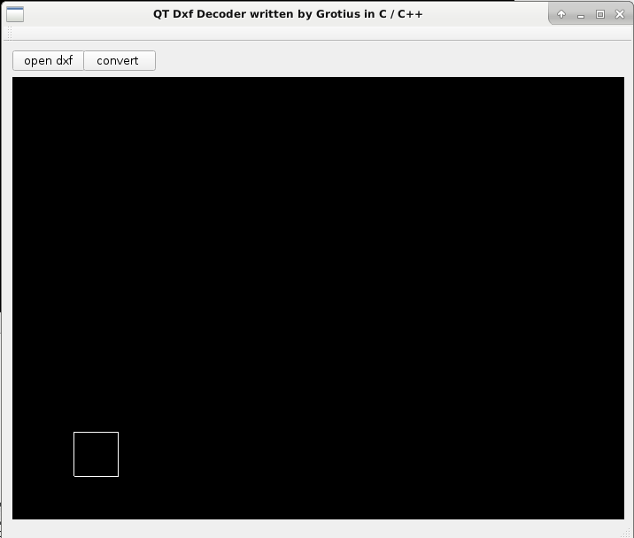

15 Mar 2019 22:31 - 15 Mar 2019 22:32 #128691 by Grotius
Question is there a support for G41/G42 CRC offsets into the CCode project
Yes, toolpath offsets G41/G42 is one of the key concepts.

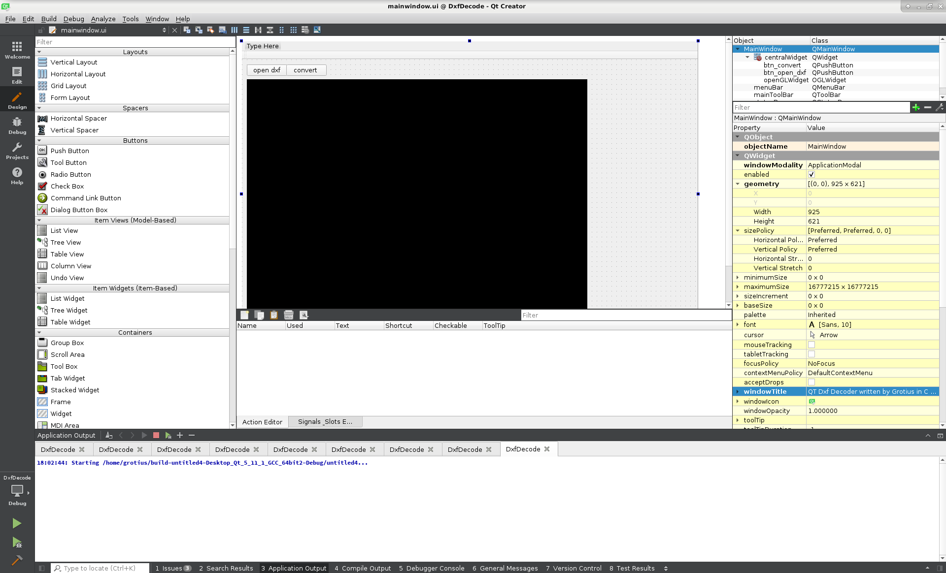

The difficulty is because there is no logic in the dxf available to see if it's a cw or a ccw contour, so you have to write your own logic.
But at the moment i started the project with QT designer intead of Glade. I had too much trouble with Glade to use Opengl function's. In fact i was busy for 2 weeks only to get OpenGL working in Glade. After some testing and compiling i realised this is not the way.
Glut with c works very good. But Glut is a pop up screen.
I realised a QT project written in C++ with OpenGL working to draw some lines.
My existing C code project is integrated in the project. So it seem's easy to combine C and C++ code.
At the moment i am busy to display the dxf array's to the screen display. This i have to find out in coming day's.
It look's easy, but OpenGL has many booby trap's.
The QT screen designer is nice, it makes your connection's to your code so easy...
And the project structure. You see the cpp (C++) files and the c files in the same project.
So i have to learn QT a little bit and stay on to make some progress !! :woohoo:
