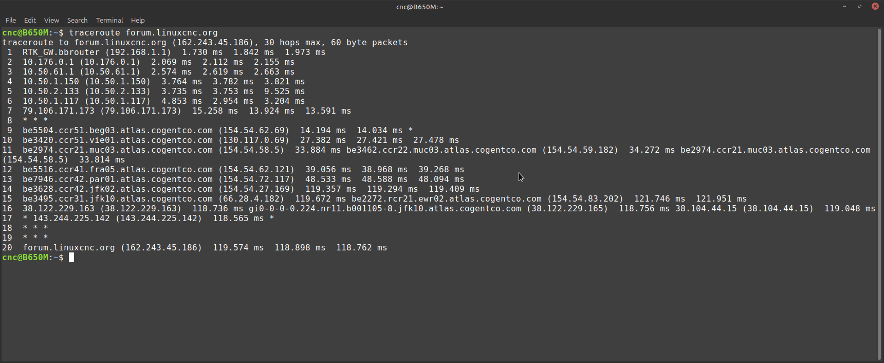

I looked at traceroute, ping time, DNS lookup and so on.
I don't think its a network issue, rather a server issue.
I see that I get contact with the web server pretty quickly, then it takes ages (sometimes) to get the data.
At this moment it is quick, no problems, but I guess that will change after I post this.

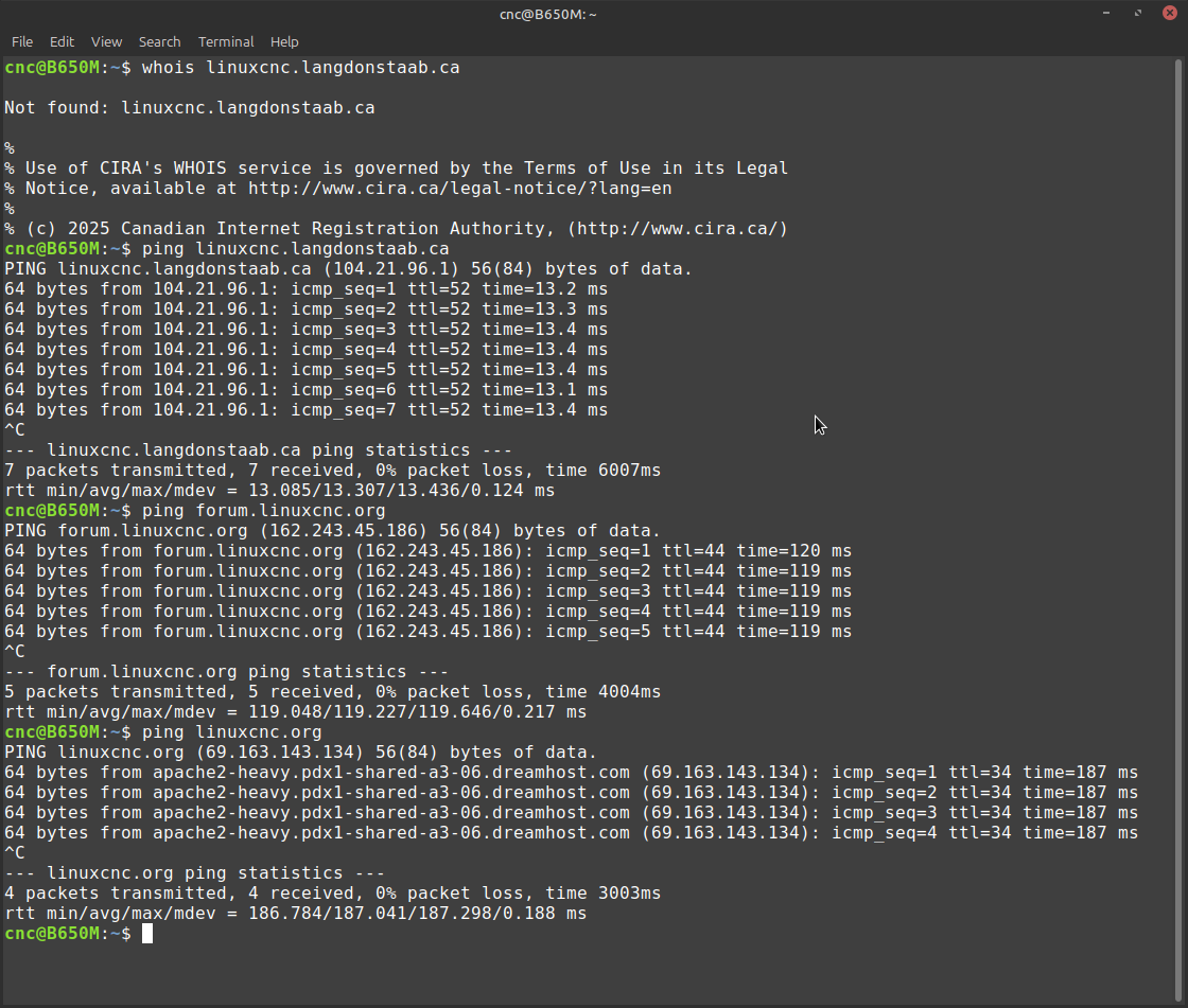

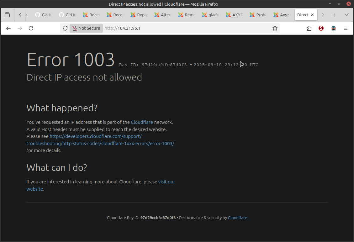

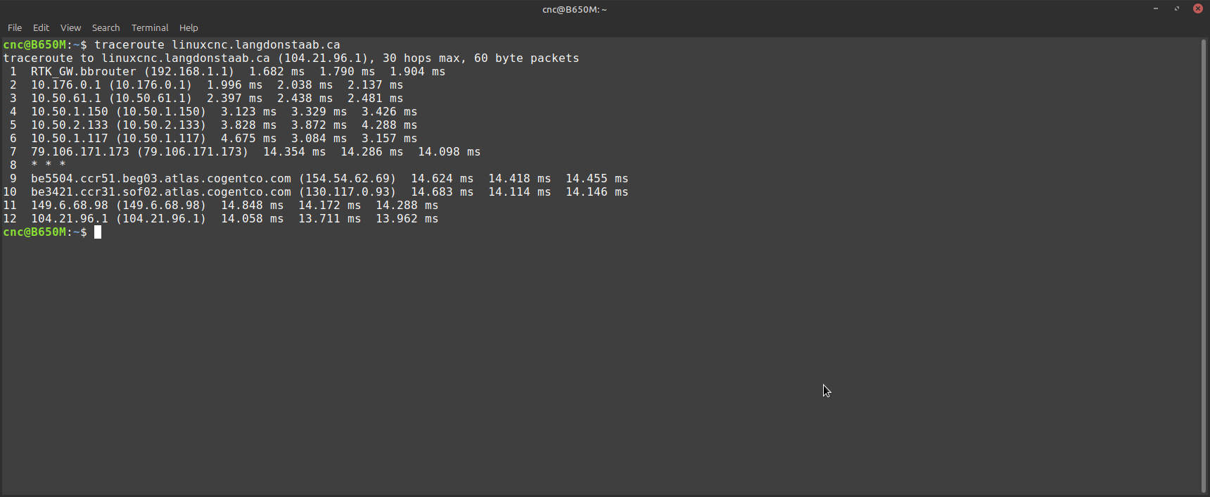

Been using LangdonS DNS today afternoon, it is much better than the normal route.
It is mostly DNS issue as can be seen in the screenshots:
Be aware that the ping result is most probably not from our server but from CloudFlare server that is the closest to our server, as seen above when trying to access that IP address.

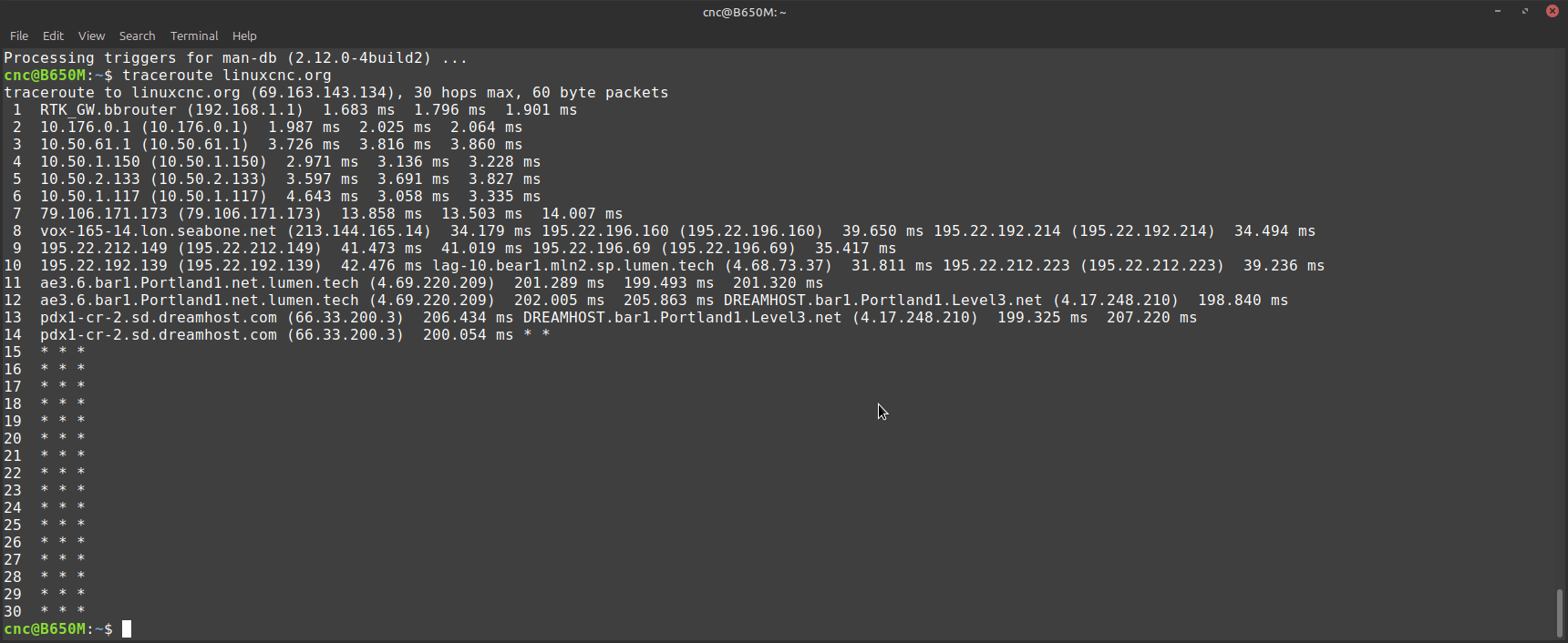

Pinging linuxcnc.org gives me thiss address:
PING linuxcnc.org (69.163.143.134) 56(84) bytes of data.
64 bytes from apache2-heavy.pdx1-shared-a3-06.dreamhost.com (69.163.143.134): icmp_seq=1 ttl=45 time=226 ms
And forum.linuxcnc.org
64 bytes from forum.linuxcnc.org (162.243.45.186): icmp_seq=1 ttl=49 time=284 ms
I would assume in my stupidness that they are 2 different servers,as per the IP addresses.
The wiki seems to be on the linuxcnc.org server
