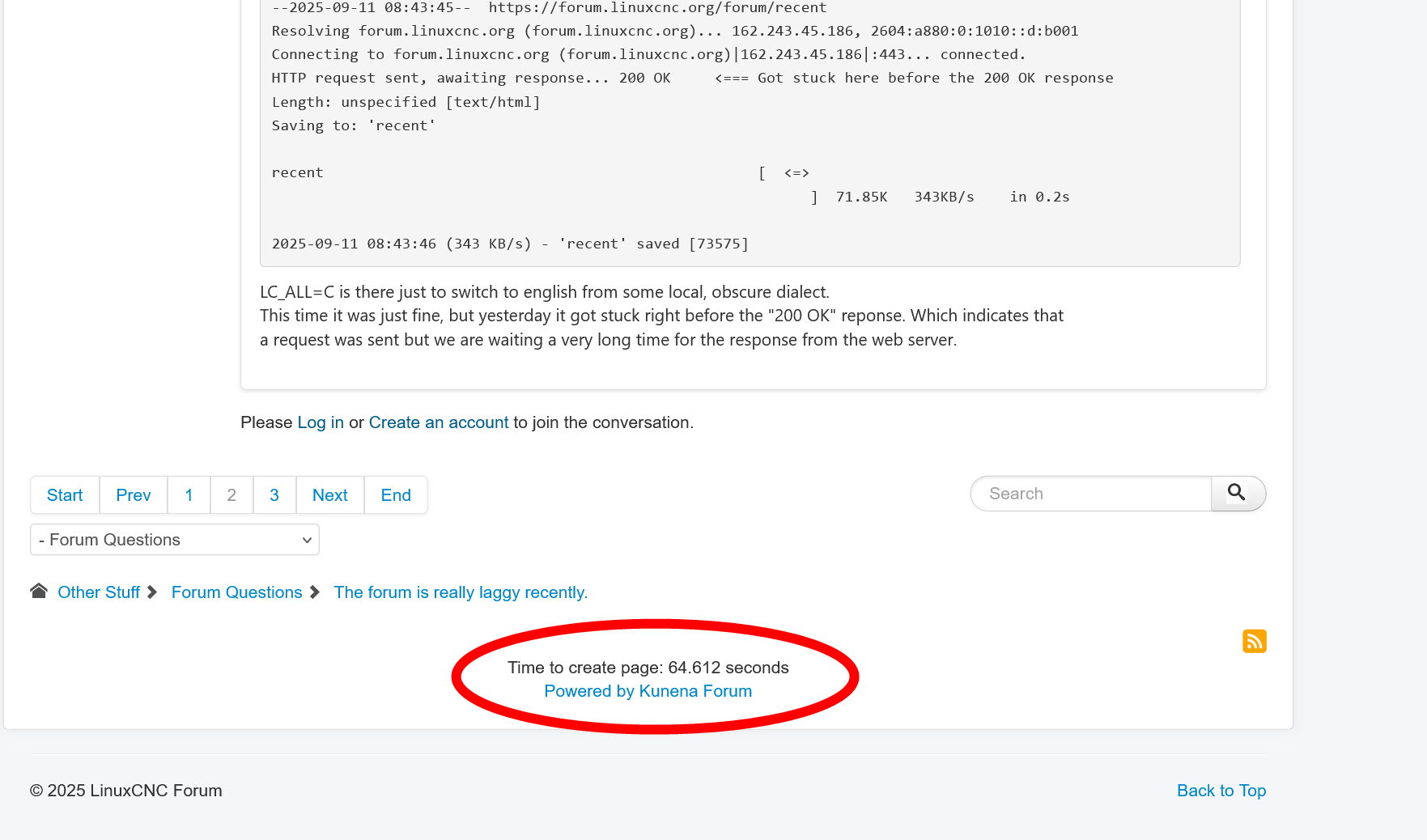

Yes it does.Always stuck at the same place when using wget.
A bit random speed though. Sometimes very slow, like a minute and sometimes fast.
Going langdons route to the forum follows the same overall speed, but as of now is always faster.
And fetching using http is always much faster than using https, however only some static stuff like logos
can be fetched using http.
That points to the TLS handshake being the cause of delays.
But, as fun as it is to try to diagnose this from remote and coming up with temporary solutions like langdons url redirect,
it must be possible to check the website hosting the forum.
Surely someone, somewhere, hopefully the admins, knows how to have the website checked.
Right?
