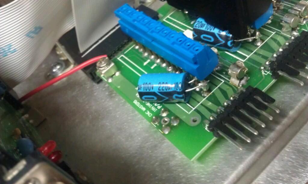

There are resistors mounted on the last 2 pins on each, marked 220uf 100v.
I've been thinking that the 201's would mount onto the new 7i76 daughter board. I guess that is incorrect? From what I'm understanding now, the 201's will mount flat on the aluminum plate, to act as a "heat sink". I will be running individual wires from the 7i76 to the 201's to control step/direction? Or is there a cable available for this? Does the wiring need to be "shielded" or only for servos, I have steppers?
20 Oct 2012 19:07 #25496 by BigJohnT
Replied by BigJohnT on topic Re:Complete newby needing help.
That sounds like a capacitor not a resistor. The resistor if it is an axial wire one will have color bands, dunno what a surface mount one looks like.
Yea you will run wires from the 7i77 to the 201's. I usually use old cables from proximity switches and things like that just to keep it neat and they usually have 3 or 4 22 gauge wires in them. The only thing that needs shielded wire that I know of is encoders.

A pic of the capacitor that I thought might be a resistor

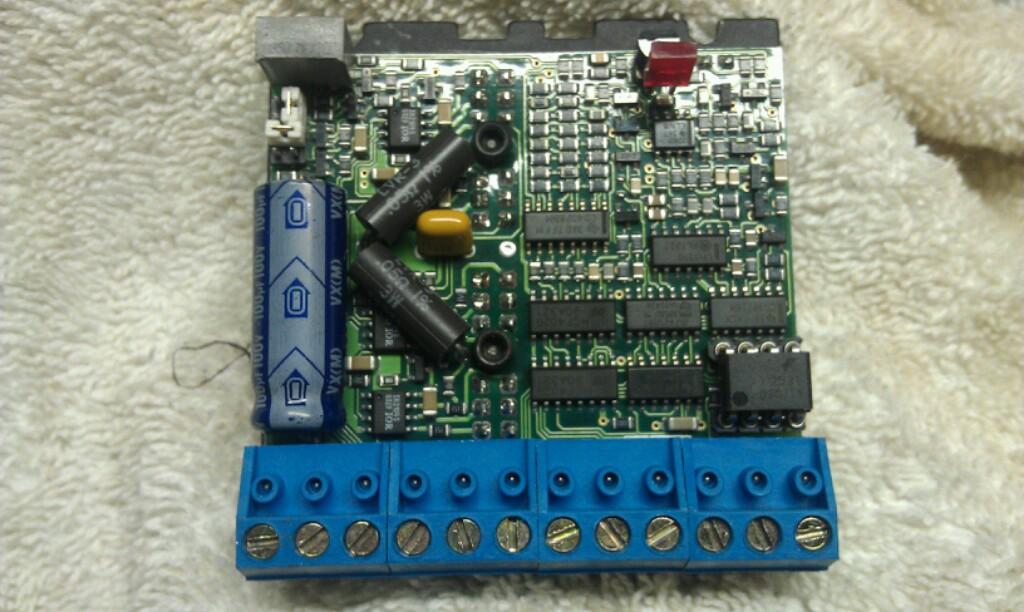

Pic of the 201 with the cover off. I've seen post on the net where cncmasters has denied that it is a 201. (probably just trying to protect their hardware/software, IMO)

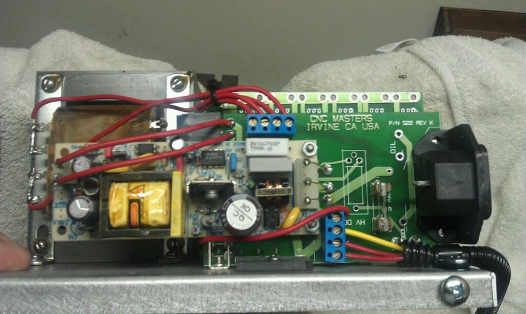

A better pic of the "power" board. There's another smaller transformer, probably to drop down to 12-24v. But I don't see a bridge rectifier anywhere to convert to DC.
Bridge rectifier is not really a problem. I'm sure I can pick one up if I don't have one around somewhere.

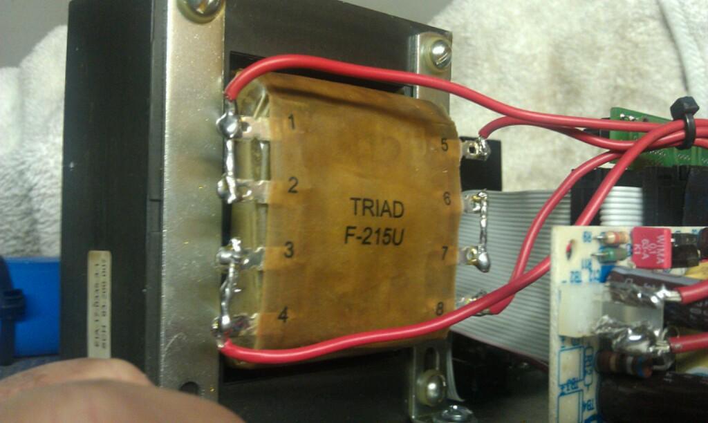

Pic of the transformer. When I looked it up it is 48v, 192va. Is this big enough to run 2-1500in/oz and 1 1200in/oz steppers, in a "hobby" situation?
I guess I can run it "temporarily" until it fails.

The 22-24 gauge wire is only for the step and direction wires.
The steppers have wires already correct?
I would use at least 16 gauge for the power wires.
That cap is on the power connectors not the current set which is on the other end of the connector. I wonder why they have that?
That is a 201 down to the last detail...
I have several power supplies like that laying around and they use some other method that I'm sure if Peter reads this he can explain. I'd use it till it dies. Looks like the terminal block with 3 reds and 1 yellow wire are the DC side.
