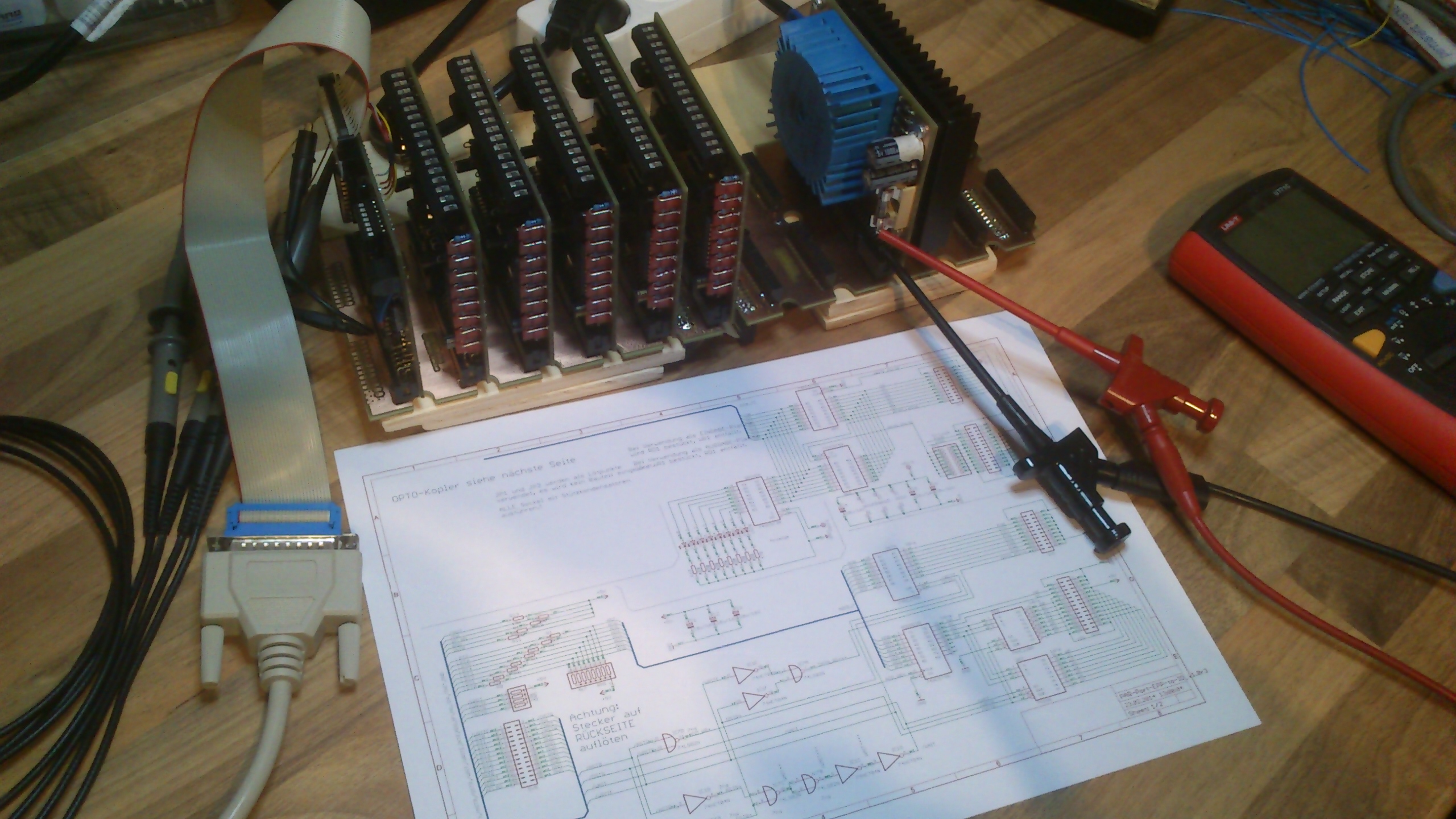

28 Feb 2014 05:14 #44243 by plasturo
Replied by plasturo on topic compiling new object-file for DIY glue logic
to see what I have done until now, here is a picture
from left to right
1.) LPT board, includes 74xx245 for data and 74xx574 for address latching
The addresses are decode with a 74xx138 for reading and a 74xx238 for writing
2. and 3.) Two output-boards with 8 bit each. A 74xx573 is used as a driver for the LED's.
4.,5. and 6.) Three input-boards with 8 bit each. A74xx573 is used for the LED's, too
7.) Power-Supply +5V
bottom:) The "EPP-Bus" with 8bit Data plus selection bus for read and write.
All Boards (2..6) contain own optocopler behind the Connectors.
bye,
Plasturo
