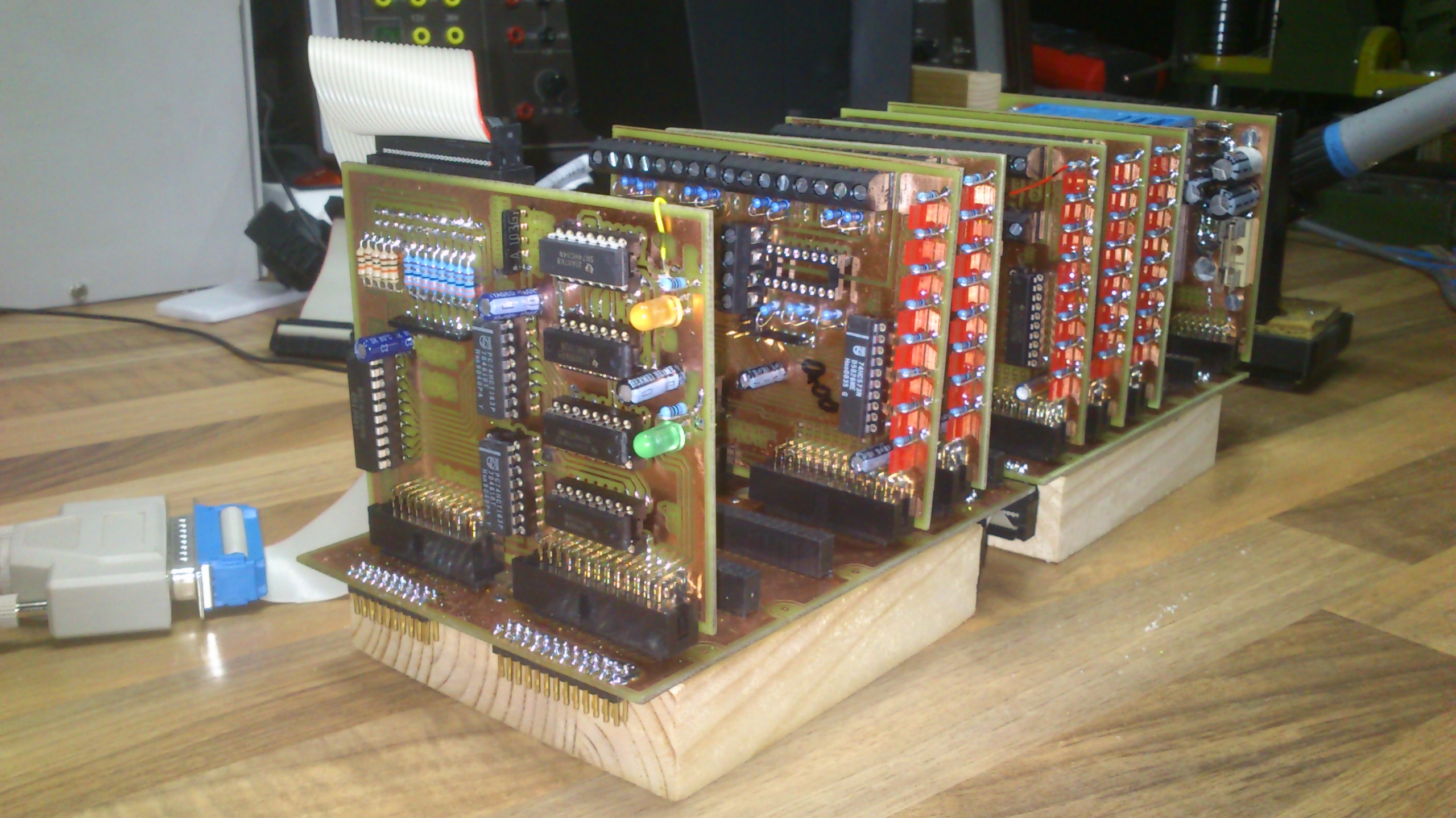

06 Apr 2014 23:26 - 06 Apr 2014 23:29 #45621 by plasturo
Replied by plasturo on topic compiling new object-file for DIY glue logic
Yeah, it works additionally with a small halrun-programm it is running now.
(siggen + thread + stepgen + own-driver)
I changed the Address Latch to two 74xx163. Now I can write addresses
plus counting the address up after every datawritecircle. That makes the
transfer quicker.
Here a picture of the hardware

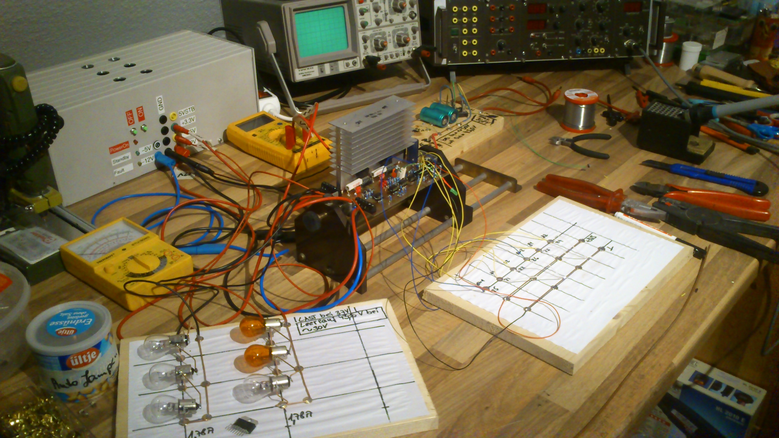

The next step is to programm and connect the amplifier of the stepper,
here a picture of one (I build four until now)
