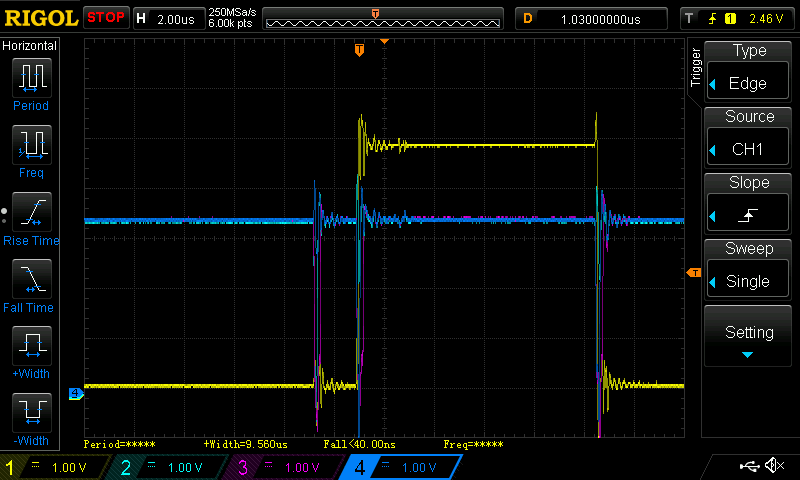

16 Mar 2014 18:23 - 16 Mar 2014 18:39 #44876 by plasturo
Replied by plasturo on topic compiling new object-file for DIY glue logic
Hi all,
I tried a little bit with the EPP-Mode of the parallel interface. in general it works for writing information to different addresses, so I am able to send the value 0x00 to 0xff for address 0x00, 0x04, ... to the hardware.
I used the pluto-step driver as basis to rewrite a new driver. The content of the part EXTRA_SETUP() I used to send some test scenarios:
EXTRA_SETUP() {
	rtapi_print_msg(RTAPI_MSG_ERR, "Performing EXTRA SETUP\n");
    return titan_setup();
One part of the titan_setup() is the following to check the READ function:
	rtapi_print_msg(RTAPI_MSG_ERR, "START OF TEST.\n");
	EPP_DIR_WRITE();
	EPP_ADDR(0);
	EPP_WRITE(0xf0);
	EPP_DIR_READ();
	input = EPP_READ();
	rtapi_print_msg(RTAPI_MSG_ERR, "read value is: 0x%x\n", input);
	EPP_DIR_WRITE();
	EPP_WRITE(0x0f);
	rtapi_print_msg(RTAPI_MSG_ERR, "END OF TEST.\n");
I make a picture of the signals. The yellow line (CH1)is one bit of the written signal. I use it to get the trigger point. The light blue line (CH2) is the /ASTR signal. The purple line (CH3) is /WRITE and the blue line (CH4) is /DSTR.
Now we can see that the event before the trigger point is the EPP_ADDR(0);
Then on the trigger point the bit is set with the command EPP_WRITE(0xf0);
In the space, there has to be the EPP_DIR_READ(); input = EPP_READ();, but it isn't.
And at the end we see EPP_DIR_WRITE(); EPP_WRITE(0x0f); because the bit is set to zero.
Why is there no /DSTR in the moment where I like to read the value from the hardware?
Do I need to add some code in the driver?
Additionally I can not understand why the EPP_DIR_xxx is empty:
static inline void EPP_DIR_WRITE(void) { }
static inline void EPP_DIR_READ(void) { }
Is it only a declaration? Where can I find the content?
Thanks for you ideas and help in advance,
bye,
Plasturo
Last edit: 16 Mar 2014 18:39 by plasturo.
16 Mar 2014 22:59 - 16 Mar 2014 23:01 #44882 by plasturo
I did it ....
... the solution is:
	outb(inb(ioaddr+2) & 0xdf, ioaddr+2); // set direction bit(5) to 0 (write)
	outb(inb(ioaddr+2) | 0x20, ioaddr+2); // set direction bit(5) to 1 (read)
bye,
Plasturo
PS.: I am suprised, that there is nothing in the pluto_step driver at this place ... how can the pluto_step driver read values from the hardware?
Last edit: 16 Mar 2014 23:01 by plasturo.

17 Mar 2014 02:36 #44888 by PCW
Actually I'm pretty sure that the pluto stepgen _does_ need readback but whats odd is
this idea that you need to change the EPP direction to read or write. This only makes sense
if you are emulating EPP port hardware on a normal (PS2) type parallel port, EPP hardware does
all direction control and handshaking in hardware so no explicit direction change is needed.
Data or address read or writes with a working EPP parallel port are simply
inb and outb instructions to the proper addresses (assuming 8 bit access)
The following user(s) said Thank You: plasturo
