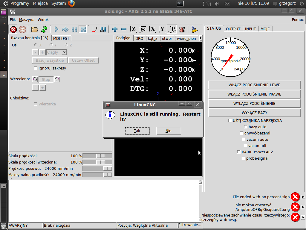

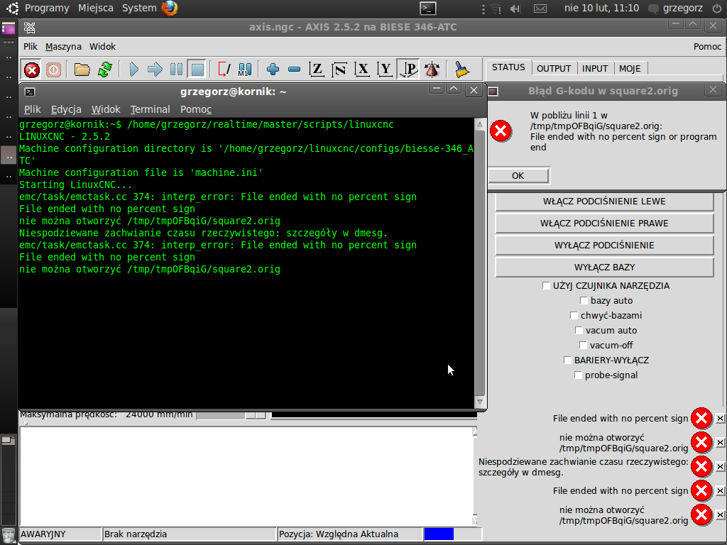

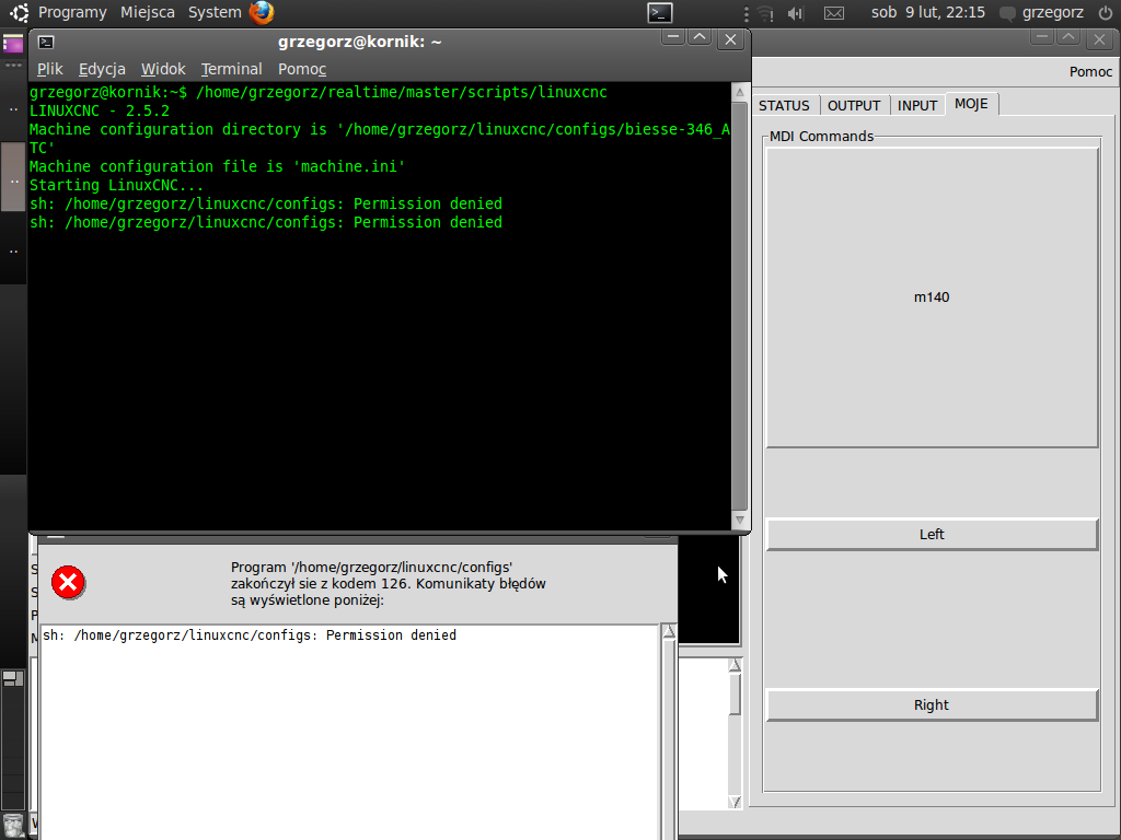

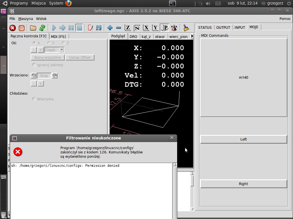

25 Nov 2014 04:56 #53360
by grzesiekzxr
Replied by grzesiekzxr on topic Script bash
Hallo,
I just checking flipcode and when trying to open sqare2.orig I have error info permision denied.
When I just open righimage or leftimage evrything is ok and buttons working properly .
In all files permission is checked.
Maybe it's not enought and I schould do it by terminal and chmod.?
I just attach screenshots.
Than
ks.
Than
ks.

25 Nov 2014 15:22 #53380
by ArcEye
Replied by ArcEye on topic Script bash
Hi
You have incorporated it partially into a working config by the look of things
I expect the problem with the origin filter is that you have not given a proper path to it
It would be a good idea to chmod everything anyway
$ sudo chmod -R grzegorz:grzegorz ~/linuxcnc/configs/flipcode
and then deploy files from there elsewhere
regards
orig = /home/grzegorz/linuxcnc/configs
regards

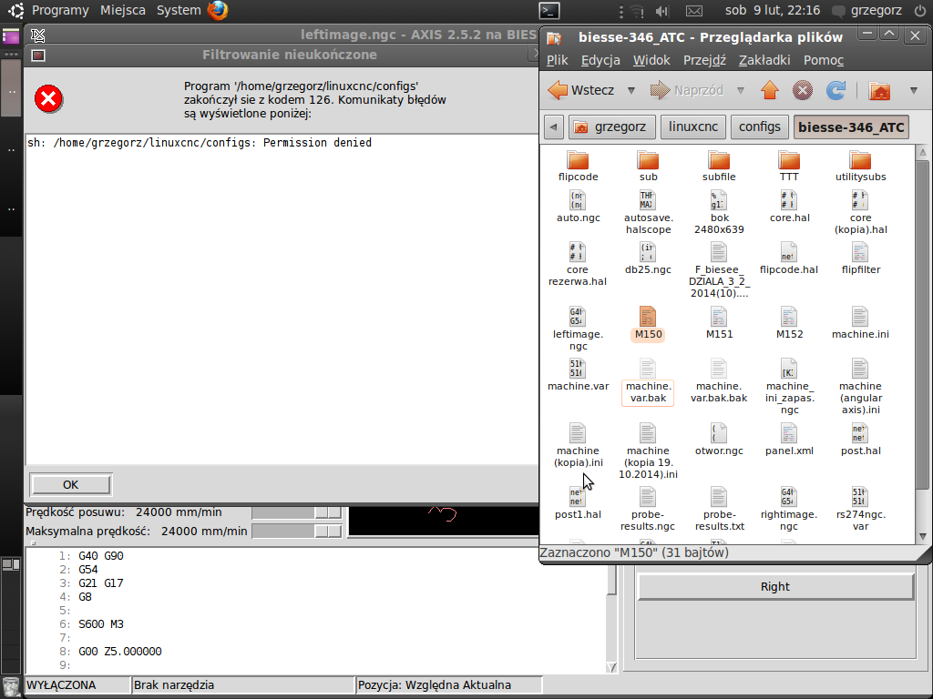

25 Nov 2014 16:11 #53381
by grzesiekzxr
Yes I tought the same and try many paths like blind man.
I'm sure that I can check what is exact path, maybe in attached file linuxcnc_print.txt.
But I wonder which path is right.
If not there then where ?
I will try more today.
Thanks.
Thanks.

25 Nov 2014 16:42 #53382
by ArcEye
The path for a filter must be a full one which names the script to be opened, where it is is irrelevant so long as it exists.
The alternative is to put the script in a directory already in the $PATH environmental variable like /local/bin for example
Then you could just have
orig = flipfilter
Look at the sample .ini file
regards
orig = flipfilter
regards
