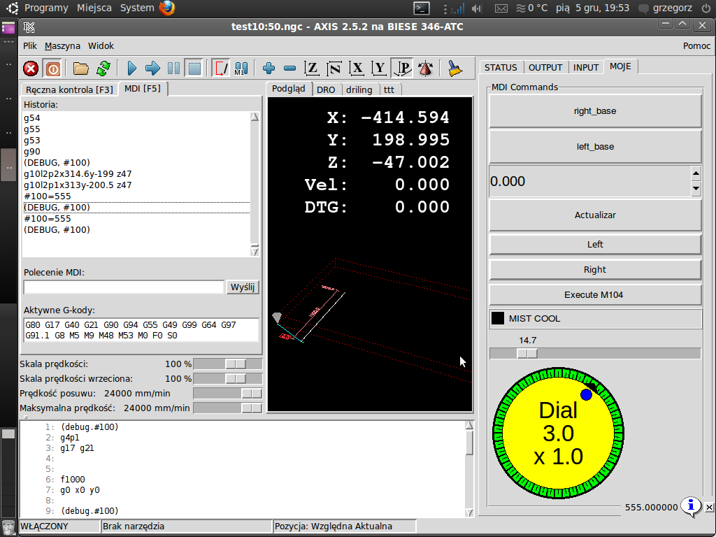

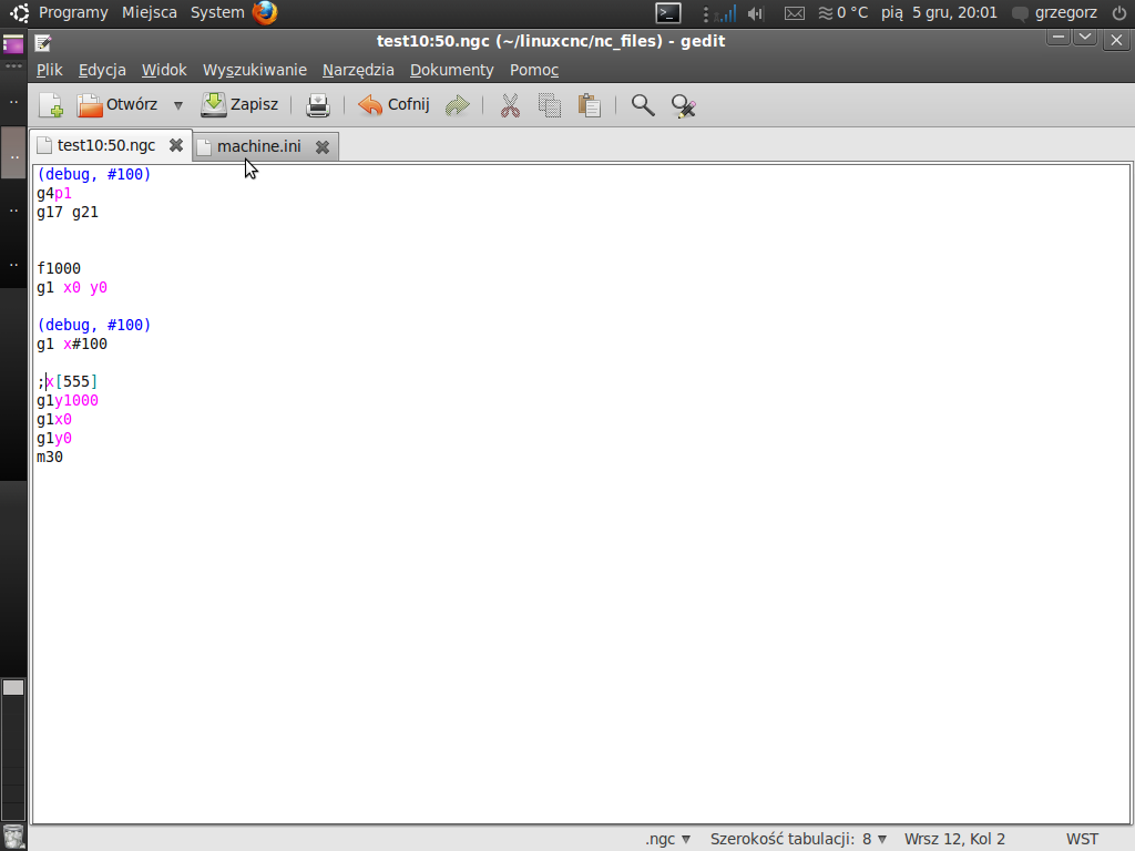

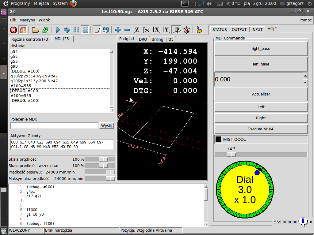

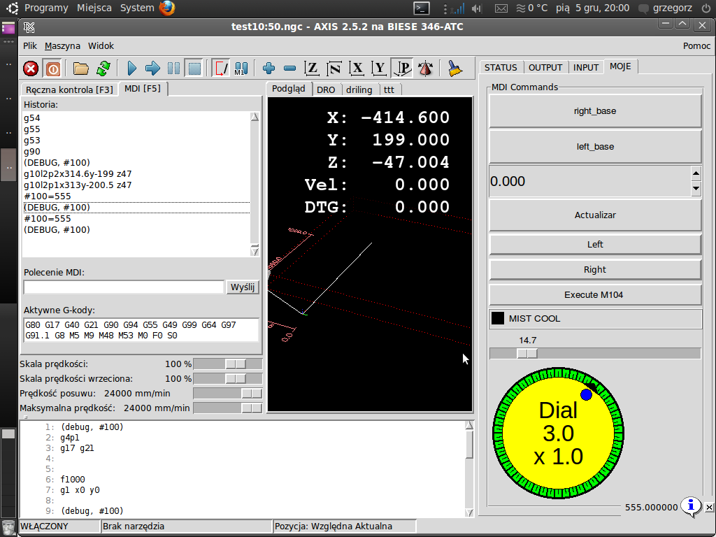

Hi
When I put in MDI #100=555
next write (debug,#100) and have info 555
Next run file like:
if parameter #100 is active have a square
if parameter #100 is not active have a straight line in Y axis
I have info about value parameter only by debug inside MDI or presing conected button .
I don't run program only watching previev Axis
''So the parameter is persistent between MDI and Auto.''
Is it posible to check it in different way?
What can by responsible for persistent parameter?
regards.

Hi ,
good news just run file machine travel by square so it's working
on the screen i see only straight line but physically work at first sight.
Sorry for the confusion,preview introduced me to the error.
I don't run physically evry program ,becouse my machine need preasure and compressor not always is on.
Will check more carefully and let you know
Many thanks

Yes it's working
What I observed when I moved trajectory from X0 to X300 preview appeared ,
I 'm not sure why earlier preview display only straight line but supose that becouse trajectory was behind limits.
Now I know that always I should run physically g-code/file.

06 Dec 2014 05:20 #53743
Oh! Of course
When you load the program you haven't set the variable.
Does "reload" update to the correct preview?
