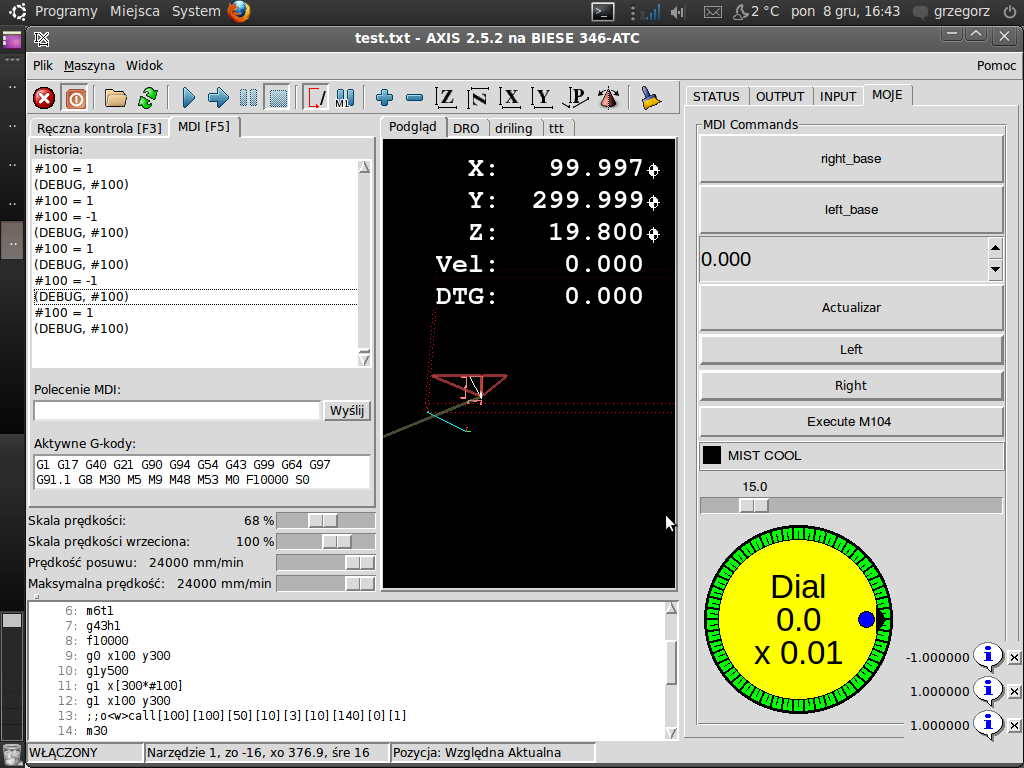

Hallo,
You were right.
''before you try the next thing and find that does not work either
Unfortunately, I was curious and checked more carefully the preview of axis still not refresch/reload parameters-no matter if #100 or #<_scale>, but refresch orgins if them put G54/G55.
Program work properly ,debug give proper parameter ones 1 a second time -1 ,only on the screen I don't see what happen.
Perhaps the problem is in my Ini or Axis.py files
I atached files.
What may be responsible for access to parameters?
Maybe it's time to upgrading to newer version2.6 , then problem disappear?
Thanks.
regards

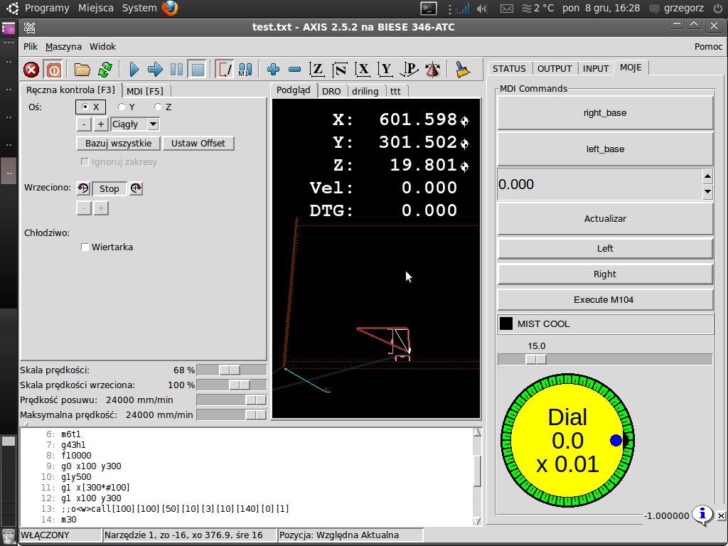

.....sory now understand why geometry differ (x100;x300)=>distance200, is different then (x100;x-300)=>distance400. I'm a little confused
This confirms that the machine travel well and see parameters but AXIS NOT (white line)
,in the end, my machine is called a BIESSE
I love this machine ,but sometimes hate
regards.
regards.

Hallo'
Today I was instaling Linuxcnc 2.5.0 on another computer and I have the same result.
I wonder IF checking parameters and refresh preview by axis is whatever posiblle in older version 2.5.0 or 2.5.2 ?
Another idea put M-files in aditional locattion .
regards.
regards.

Hi
You will have to explain what the problem is.
I didn't really understand your #53823 post but #53825 seemed to say you had sorted it.
I don't know if the gcode is wrong or if the display is not what you are expecting
regards
regards

''I didn't really understand your #53823 post but #53825 seemed to say you had sorted it.''
#53823=> firstly I was thinking that not only axis don't see parameters but interpreter too- I was wrong,what I wanted to correct in #53825 , pardon for the mess.
In my last post confirmed that PREVIEW AXIS don't see [refresh] parameters altough machine trawel well .
On fresh instalation on differ computer is the same result .
''if the display is not what you are expecting''
Yes
Should display triangle on the other side (white line).
Thanks for response ,
regards.
Yes
regards.
Last edit: 10 Dec 2014 01:14 by grzesiekzxr.

OK,
So the machine moves as it should but the plot is not updated
Try adding
axis-remote --clear;
to the top of the M1xx script to get rid of back plots already showing, should make things clearer
and try
axis-remote --reload ;
Instead of spawning the command with &, wonder if the forced wait for return will update better?
If not I will have a play with a sim tomorrow to try to replicate
regards
