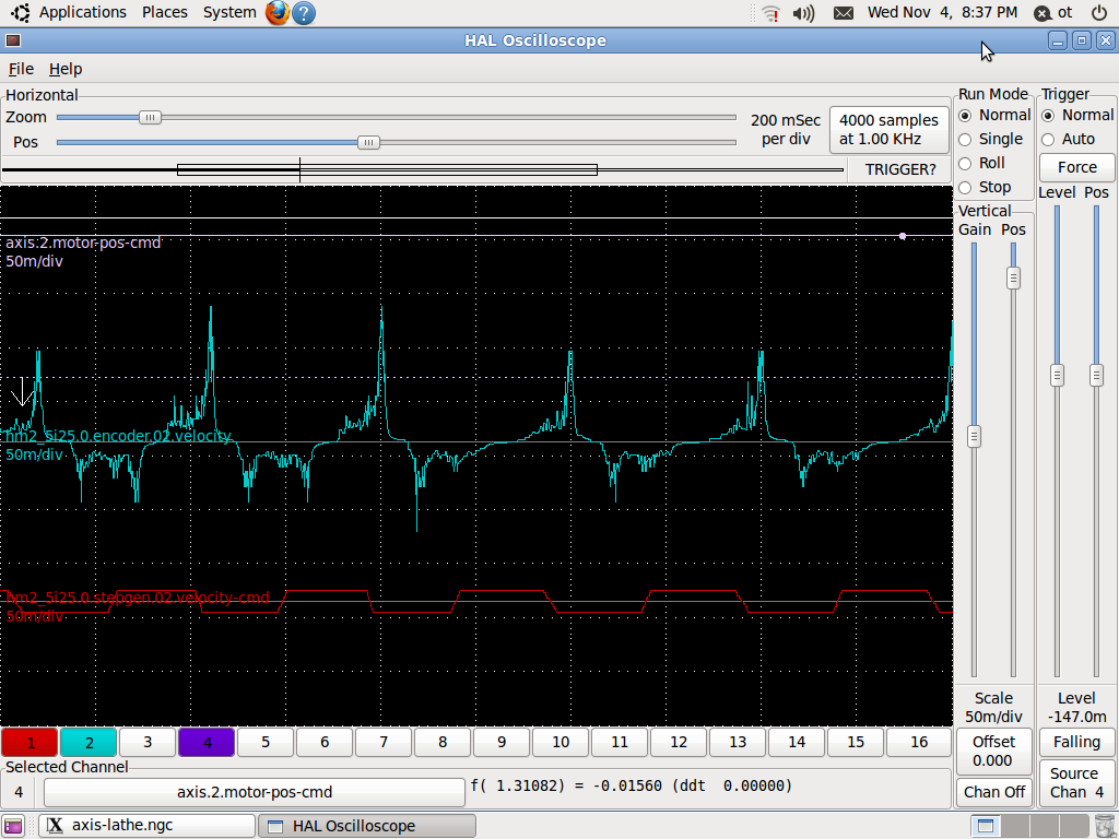

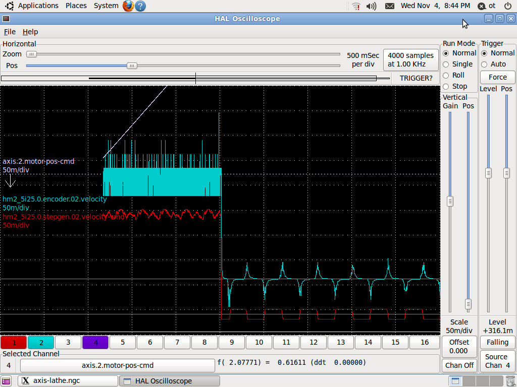

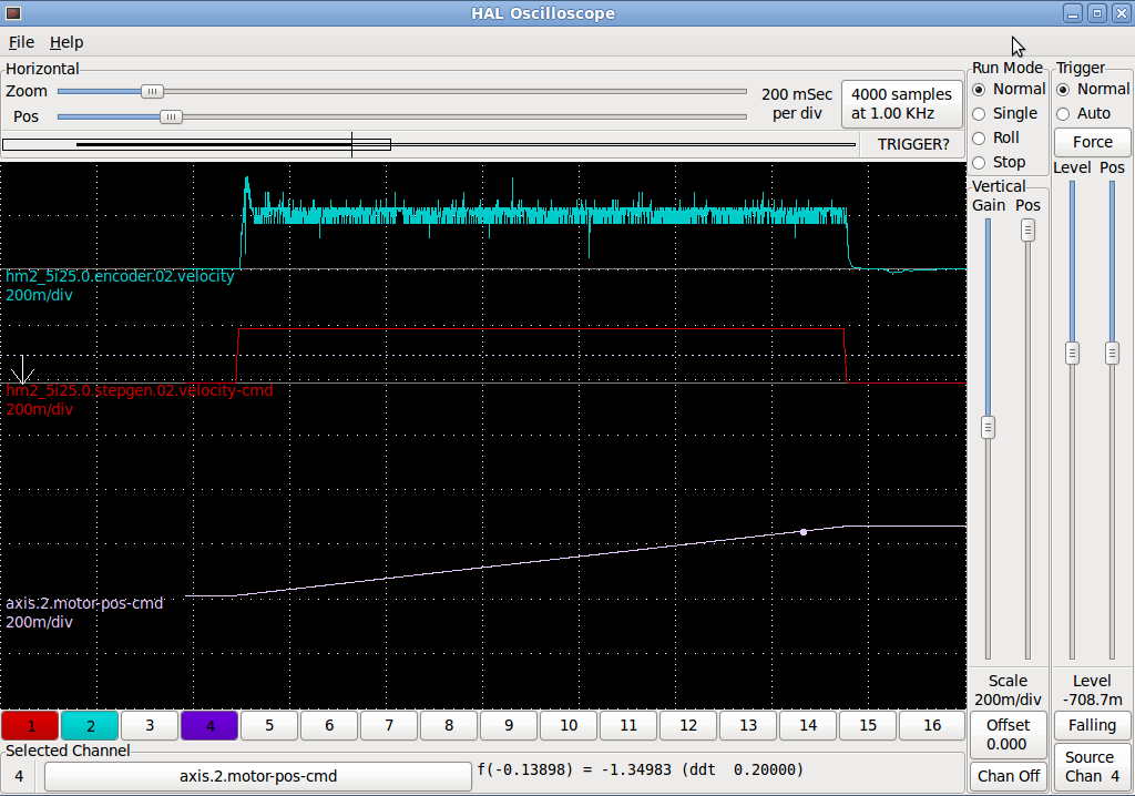

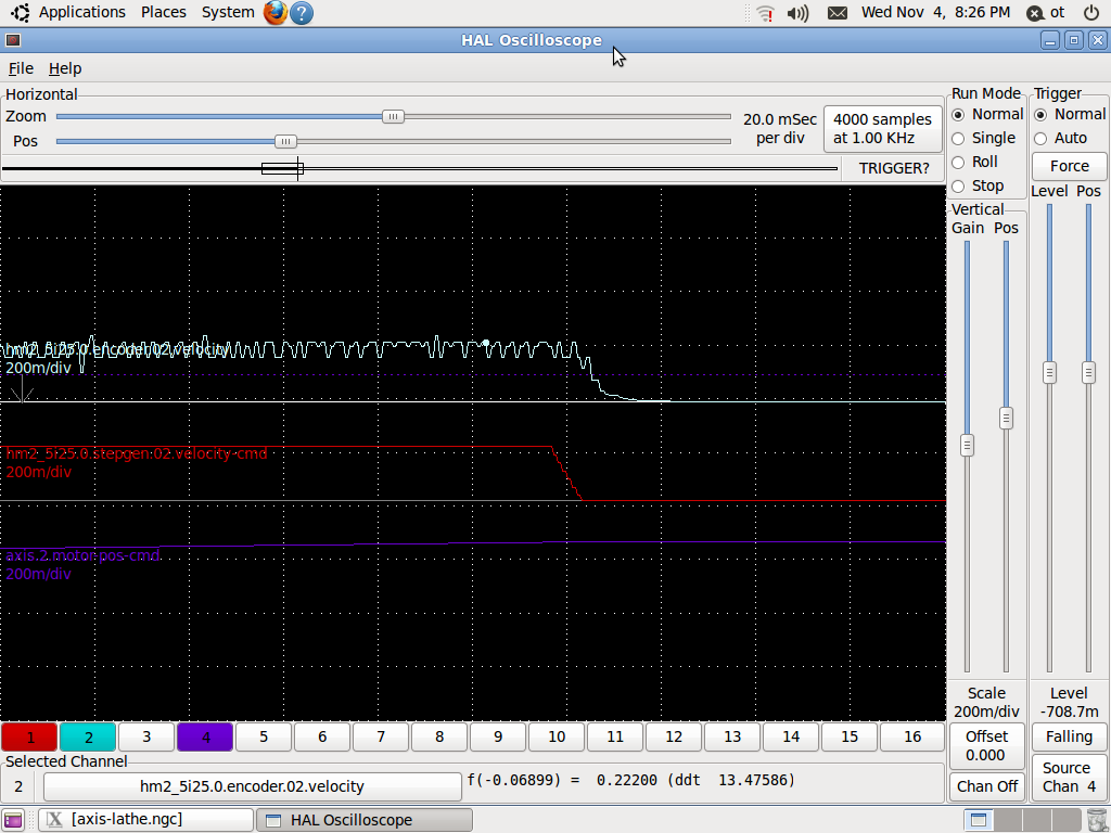

05 Nov 2015 08:58 #64783
by OT-CNC
Replied by OT-CNC on topic Index Homing odd offset
I'm starting to like halscope
The encoder signal looks messy
What do you think? The first two are of P0 at 12 ipm, the next are at P50 and the dithering at rest which is around .001" tir.
- Posts: 19896
- Thank you received: 4648
05 Nov 2015 18:17 #64804
Replied by andypugh on topic Index Homing odd offset
That seems to suggest that P=50 is much too much.
Try repeating the test at p=0.005, 0.05, 0.5 etc and see at which point the f-error starts to reduce.
- LearningLinuxCNC
- Posts: 226
- Thank you received: 39
05 Nov 2015 19:21 #64813
by LearningLinuxCNC
Replied by LearningLinuxCNC on topic Index Homing odd offset
You need to add ferror as a trace in halscope. You are tuning to minimize it so you need to see it. If ferror is close to zero all the time then the commanded and actual velocities will match.
