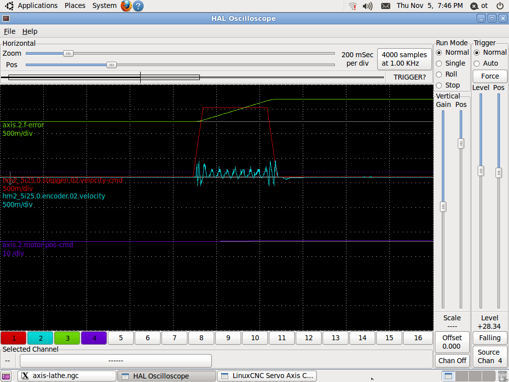

Replied by PCW on topic Index Homing odd offset
uggh, the plot when stopped indicates the drive doesnt move for about 100 ms of motion command from linuxcnc
is there a deadband in the drive? If so it needs to be turned off

06 Nov 2015 07:30 #64864
by OT-CNC
Replied by OT-CNC on topic Index Homing odd offset
For some reason I can't get motion when jogging with the arrows as I'm trying to hit the Force button on hal scope
This worked yesterday. What changed???

06 Nov 2015 18:25 #64881
Replied by andypugh on topic Index Homing odd offset
I have lost track of what is going on here.
You can set Halscope to trigger automatically when the velocity-cmd goes positive. No need to press buttons.
The axis doesn't seem to be moving at all. f-error rises linearly and the velocity hovers around zero.
If FF1 is set to 1.0 or thereabouts, why are you so convinced that that P needs to be 10x or 50x larger? I would expect it to be smaller.
What is the smallest non-zero PGain that you have tried?
How accurate is the tracking of velocity with P=0, I=0, D=0?

06 Nov 2015 22:02 #64897
by OT-CNC
Sorry Andy, I was trying to add the f-error trace and capture more data. The Screenshot is all I was able to get since hitting the force button stopped motion.
Thanks for the hint on automatic trigger.
I tried your suggestion of P=.050, P=.5 then moved my way up to P=10 and got frustrated with the force button and don't have any captured data.
I was able to find a range where the ballscrew didn't seem to dither and that was below P=10. PCW suggested to increase P and then back off at the point of oscillation.
T
To see how accurate tracking is, I will try again with PID all at 0.
T

07 Nov 2015 00:47 #64919
Replied by Todd Zuercher on topic Index Homing odd offset
In Halscope, change your trigger from position-cmd to velocity-cmd (channel 4 to channel 1). It is the button on the bottom right corner of the screen. Then it should trace automatically instead of you having to manually pressing the force button.
