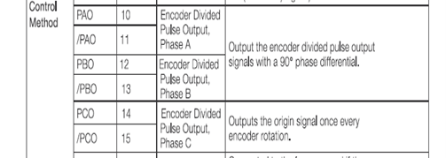

24 Mar 2021 07:34 - 24 Mar 2021 07:36 #203490 by CNCCustoms
Replied by CNCCustoms on topic Index Homing odd offset
If they are absolute encoders, and if LinuxCNC receives the absolute data, then this would be the best way to work.
How are you getting the encoder feedback back to LinuxCNC?
Im using a 7i77 Mesa card to input the encoder signals. See attached picture. PA, PB and PC. PC is the index signal. Not sure how to send the absolute data to Linux. There is a serial output for the encoder as well but not sure how this would work. I'm not sure how this will help anyway since apparently Linux doesn't track the absolute encoder anyway... I'm told it simply saves the current position in a position file and reloads that position on startup. If the encoder moved during shutdown (tracked by the drive and abs encoder) linux will not know. (or am I wrong?)

24 Mar 2021 15:43 #203516 by andypugh
Replied by andypugh on topic Index Homing odd offset
That is not correct. It was correct a couple of versions ago, but is not the case now.
If you can get the absolute data into LinuxCNC then you can use it by using HOME_ABSOLUTE_ENCODER.
linuxcnc.org/docs/2.8/html/config/ini-co...t__lt_num_gt_section
What format is the encoder data in? The Mesa firmware knows how to interpret a few formats, SSI, BISS and Fanuc:
linuxcnc.org/docs/2.8/html/man/man9/host...%20Interface%20(SSI)
There is even an example of someone who appears to be using SSI encoders here: forum.linuxcnc.org/38-general-linuxcnc-q...rking?start=0#203460
net x-index-enable    joint.0.index-enable  <=>  hm2_7i76e.0.encoder.01.index-enable
net x-pos-rawcounts        <=  hm2_7i76e.0.encoder.01.rawcounts
I assume that 7i76e.0.encoder.01 really is the X encoder?
If you open Halscope you should be able to check that the encoder.01.position goes to zero when the index is seen.
At that point the pin joint.0.motor-offset should update.
Index homing also seems to be working now that Ive changed my drive to use the encoder as an incremental encoder.
I am confused now. How could you use index homing without an incremental encoder? Were you using absolute + index?
Anyway, part of the problem seems to be that nothing is driving the x-pos-fb pin (or, if there is, it isn't in the HAL you showed)

I have absolute encoders on my drives and was attempting to use them in absolute encoder mode (outputting PA,PB and PC from the Drive to my 7i77 where Pc is supposed to be the index). That did not work.
How is that mode different from quadrature + index incremental? Is that a mode that sends serial data on the ABZ lines at power-up? (LinuxCNC doesn't understand that.)
Is there a "how to" on using the serial data to input to linux via Mesa cards?
Not that I know of. I don't think it is all that hard, but you would need the right firmware on your 7i76E and probably a 7i74 board to connect the encoders.
I wrote the LinuxCNC part of the drivers, but without any absolute encoder hardware to test with.
Do you have any documentation on the format (logical and electrical) of the absolute encoder data?
