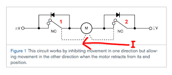

29 Aug 2016 14:52 #79663
Replied by tommylight on topic Starting big, making a SLS with Linux CNC
For moving the sand , you would need it to go from one side to the other, without stopping anywhere except the end points, right?
For that you can use that motor, and 2 switches, one at each end that would stop the motor, plus 2 diodes wired to those switches, so when it gets to one end point it wont move further even if you command it, but it can move in the opposite direction to the other end.
see attached image.
see attached image.
- wyattwic
- Posts: 20
29 Aug 2016 14:53 - 29 Aug 2016 14:54 #79664
by wyattwic
Replied by wyattwic on topic Starting big, making a SLS with Linux CNC
With that information Andy you just gave me an idea.
Currently the design is to have multiple pistons - work surface and powder feeds. I could have that work area much larger if I could have the powder provided by an auger assembly. Then with these motors I don't need direction, I just need to turn them on for a set amount of time while the laser is doing its part.
I realize this whole thread has been me rambling off ideas. As soon as I have the table, gantry and laser mounts finished I need to sit down and get the internals to a T.
Last edit: 29 Aug 2016 14:54 by wyattwic.
