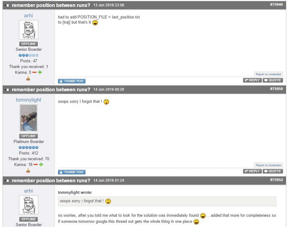

didn't get where to add this (see the attachment) ?
tired a little , guessed from your old post
forum.linuxcnc.org/forum/38-general-linu...rdinate-system#77930

07 Sep 2016 20:56 #80179
Replied by tommylight on topic add + sign with axes XYZ and runtime in program
You need to add that line in the .ini file.
