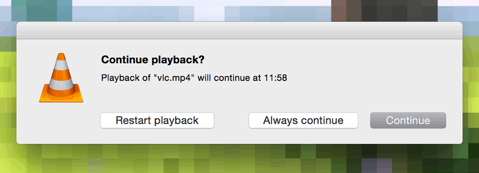

My idea is , there should be some temporary file attach with every program that run, if we stopped a program in middle or somewhere else due to any reason, it would ask about resume or start over option, in back it should save XYZ values and G codes line number with necessary starting lines of g-code file to run any program.
Image is attached for reference only
if we start a program again after being stopped, it would display the message , this file/program stopped at this point e.g.(X 10 , Y 20, Z -20). Do you want to continue or start again ?
Remember i don't know much , but i can do much
need your help

17 Sep 2016 11:31 #80517
That's actually slightly harder than it sounds, for interesting reasons.
The actual motion of the machine in LinuxCNC is done by code running in realtime. This is kernel-module code, and kernel modules have no access to the file system. So the only code that _really_ knows where the machine currently is can't write that data to a file.
It's not as terrible as it sounds, because user-space code can see the HAL pins and can query the state, but with some unknown delays (measured in a few tens of milliseconds normally, but can be longer).
It is interesting to wonder why (as far as I know) nobody has asked for this before. And I think it comes down to how most people view linuxCNC, as part of a machine tool and not as a computer application. If you want to come back to a job on a manual lathe or a mill, you leave the part in the machine. In the case of a classic CNC lathe or mill you would probably leave the part in the machine, and keep the machine powered up to retain the reference points.
How often do you intend to leave a job in the machine half-finished and to quit LinuxCNC? It can't work at all unless you have very accurate axis homing.

17 Sep 2016 12:26 #80522
Replied by tommylight on topic add + sign with axes XYZ and runtime in program
The way i do this is:
Add the "last position.txt." to the ini and a blank file with that same name in the config folder. That will remember the last position the machine was at shut down.
When starting the machine again, i scroll to that position in the AXIS screen where the gcode is and highlight the line corresponding to that position. After that i jog back to 0 on all axis , slowing the jog speed so i can set it to within 0.0xxxmm, home all axis and do a run from here from the highlighted line.
Not the best solution, but it sure gets the job done, always.
In your case, having backlash can pose some accuracy issues, but even that can be managed moving past zero and backing slowly to 0 again.
This method is usable where there is no need for extreme accuracy, as that is very dependent on the overall accuracy of the machine. I would not recommend using it on metal mills or lathes, as the tolerances for that kind of work are tight and a slight error in homing can produce unusable parts.

17 Sep 2016 13:00 #80524
I had forgotten about that. It is part of the way to what is being requested.
linuxcnc.org/docs/2.7/html/config/ini-config.html#_traj_section
POSITION_FILE
Though it is intended for slightly different purposes
