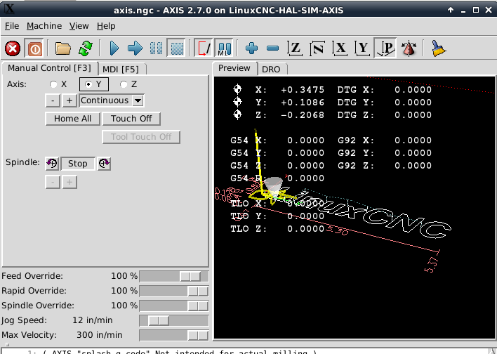

add + sign with axes XYZ and runtime in program
- boy777
- Posts: 23
08 Sep 2016 15:51 - 08 Sep 2016 16:03 #80230
by boy777
Replied by boy777 on topic add + sign with axes XYZ and runtime in program
did that,
but nothing happened,
are you sure that it really works ?
kindly show image containing + sign in linuxCNC
edited it with
nano path <file_name.file_type
Last edit: 08 Sep 2016 16:03 by boy777.

(self,s,spd,dtg,limit,homed,positions,axisdtg,g5x_offset,g92_offset,tlo_offset):
if self.get_show_metric():
format = "% 6s:%+9.3f"
droformat = " " + format + " DTG %1s:% 9.3f"
offsetformat = "% 5s %1s:% 9.3f G92 %1s:% 9.3f"
rotformat = "% 5s %1s:% 9.3f"
else:
format = "% 6s:%+9.4f"
droformat = " " + format + " DTG %1s:% 9.4f"
offsetformat = "% 5s %1s:% 9.4f G92 %1s:% 9.4f"
rotformat = "% 5s %1s:% 9.4f"
diaformat = " " + formatPlease Log in or Create an account to join the conversation.

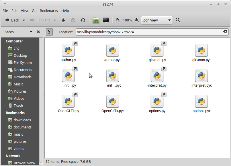

didnt found glcanon.py in EMc2.4 , also tired search for files
instead found glcanon.pyc in same folder.
but nothing writhen there except 2 smilyes sign.
sudo gedit /usr/lib/pymodules/python2.7/rs274/glcanon.pysudo mousepad /usr/lib/pymodules/python2.7/rs274/glcanon.pysudo cp ~/Desktop/glcanon.py /usr/lib/pymodules/python2.7/rs274/glcanon.py
10 Sep 2016 06:12 #80283
You should be able to find it now that you are on 2.7.6.
.pyc is a compiled glcanon.py file, you wouldn't be able to edit that. The uncompiled file really ought to be somewhere, though. Ppossibly glcanon.g

tried search for files : glcanon
found only glcanon.pyc
its shows nothing else glcanon.pyc
some one did it in EMc2.4, and didn't told me how to do,
if we can't find, its not a big issue . as solved in LinuxCNC 2.7.x

Have a look, there should be a symlink to glcanon.py and a file named glcanon.pyc
The following user(s) said Thank You: boy777

i changed it in LinuxCNC 2.7.x
leaving the old versions of EMC ...
thank you tommyHave a look, there should be a symlink to glcanon.py and a file named glcanon.pyc
