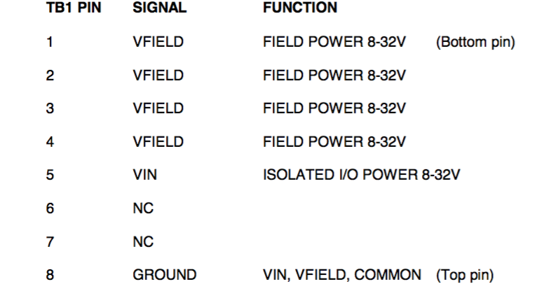

Hi guys,
I've finished putting all the electronic in the box and I got the motors and spindle encoder running.
Now I will have to work with I/O pins. I have a 12v power supply, but I don't know exactly on which of the power connector to link it.
Why are there 1 to 4 VFIELD pins? Can I supply different voltages on each of them?
I suppose I should wire the GND to pin 8.
What are the other pins for?
I will need to link an mpg pendant, and the encoder requires 5v power supply.
How do I get the 5v from field power? Do I need to use a dc to dc transformer?

Replied by PCW on topic Mesa 7i76e setup help!
The VFIELD pins are duplicated to limit the maximum current per pin to < 1 A for long term reliability.
If your total field output load is 1A or less you can just use one VFIELD pin.
DO NOT connect different voltages to the VFIELD pins as the pins are connected together on the 7I76E
The MPG encoder can be powered by any convenient 5V source
if you do not require isolation from the 7I76Es logic 5V you can use that
Otherwise a switching regulator or even a LM7805 running from field power will do
