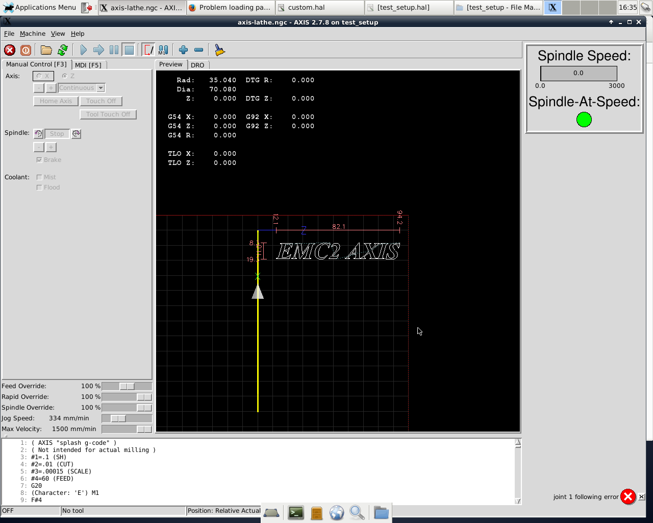

After a few trial and error attempts, I have managed to wire the pendant inspiring from this example:
linuxcnc.org/docs/html/examples/mpg.html
I can't say I actually know what I did, I've mostly used intuition to change the custom.hal file.
I can jog the X axis, the increments 0.1, 0.01 and 0.001 are working now (don't know why
However Z axis is not working, and after a few spins I get the error that can be seen in the attachment.
What do I have to change to update the axis selection in the UI as I select the knob on the pendant?
Right now, if the pendant is set to jog the X axis, turning the mpg wheel, will jog the X axis even if in the UI the selected axis is Z.
When trying to jog the Z axis, what does that error mean ?
I have also attached the hal files so that you guys can take a look.
Thanks in advance!

I think that the problem is that your custom.hal is trying to jog joint.1 and the Z-axis is joint.2.
In the next version of LinuxCNC a lathe will typically have just two joints (0 and 1) but in 2.7 (which is what you are using) the Z axis is still joint / axis 2.
Change the 1s to 2s in your custom.hal and it will probably work.

Yes it worked!
Thanks!
