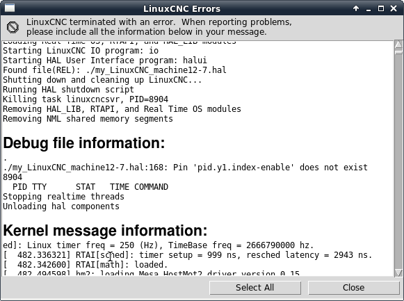

31 Jul 2017 09:48 #96736
Replied by andypugh on topic Gantry machine progres
./my_LinuxCNC_machine12-7.hal:168: "pid.y1.index-enable" does not exist.
This tells you that line 168 of the HAL file my_LinuxCNC_machine12-7.hal contains a reference to a pid.y1 pin that dos not exist.
So, why does that pin not exist? Have you changed the "loadrt" line to create a pid.y1 function?
Don't forget that you need a matching addf for the pid.y1 too.
If you make the edit I suggested then you will have pid.y0 and pid.y1 but _not_ pid.y. I think that this is a better idea as then you can't accidentally leave a pid.y in the wrong section of the HAL file without raising an error.
Don't worry about going through the files one error at a time. It is what I always end up doing with a new machine setup.

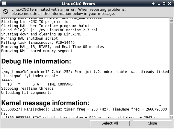

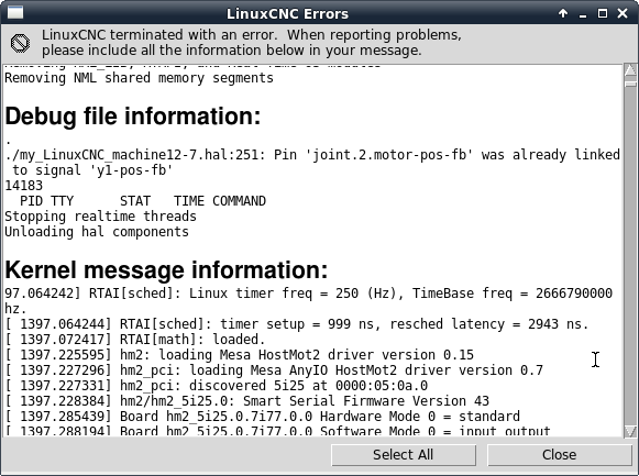

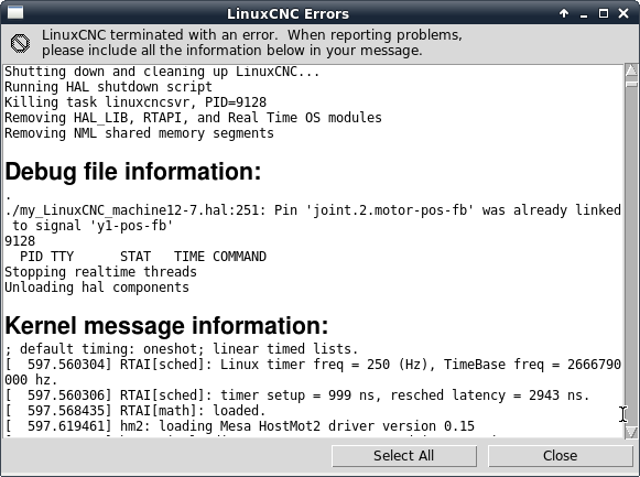

31 Jul 2017 11:50 #96752
You have both
net y1-pos-fb => joint.2.motor-pos-fb
and
net z-pos-fb => joint.2.motor-pos-fb
The rest of Z seems to be joint.3. so I think you need to make a couple of changes on lines 251 and 252.
and
