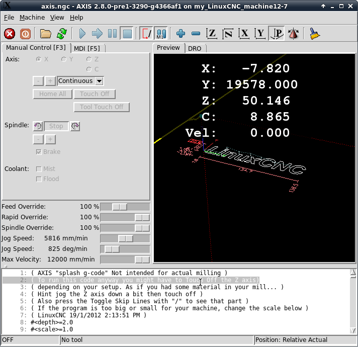

01 Aug 2017 05:48 - 01 Aug 2017 05:48 #96808
by Yannis

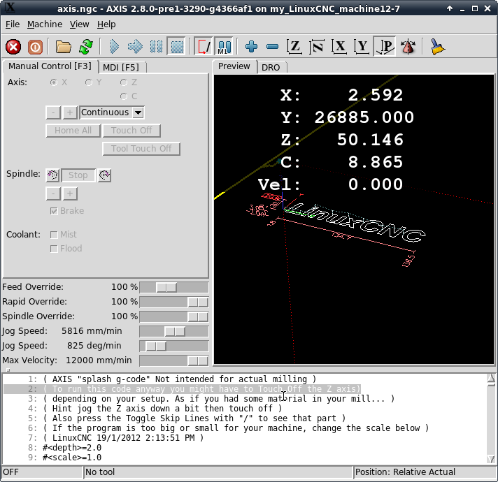

This is the latest INI ad HAL files i try to change the values from A to C.In the display is C now but when i try try to jog C axis Z axis is moving.
i notice and something else: in the y0 motor if i rotate 1 turn the axis i see in the display very large movement.I the manual i reed that the encoder of the motor is 2000 resolution
Replied by Yannis on topic Gantry machine progres

01 Aug 2017 09:56 #96816
It sounds like you have confused the mapping between joints and axes.
Maybe make a table of which joint is which axis, and which encoder and pwm/analog corresponds to each joint.
(It is entirely valid to have joint 0 control the Z axis using encoder 2 and PWM 1. Though somewhat confusing).
Replied by andypugh on topic Gantry machine progres
I rotate the joint 1 motor and the joint 0 motor 1 rotation and the values at the display was completely different even tho the settings for the encoder is the same

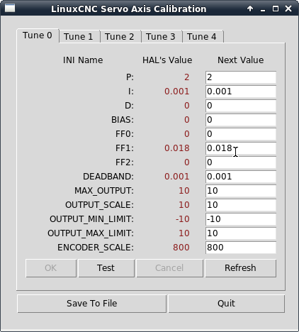

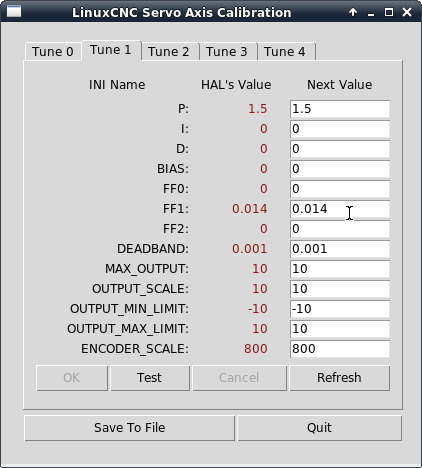

01 Aug 2017 11:01 #96826
by Yannis
i have the same encoder scale for the 2 motors(800encoder scale)
they sud count the same value per rotation
after one rotation of motor axis the one count 10mm(witch is the right value) and the other one is count 26885-19587=7298mm
01 Aug 2017 12:19 #96830
But which encoder counter is connected to which axis?
