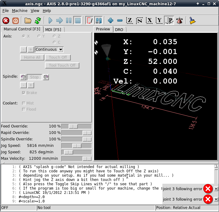

07 Aug 2017 20:17 #97126
Replied by andypugh on topic Gantry machine progres
Do the Z and C axes jog properly? The problem might be that the encoders and the PID disagree about which way is left and which is right.

11 Aug 2017 15:25 #97345
by Yannis
Replied by Yannis on topic Gantry machine progres
Hi
i will check that Monday morning
thanks
thanks

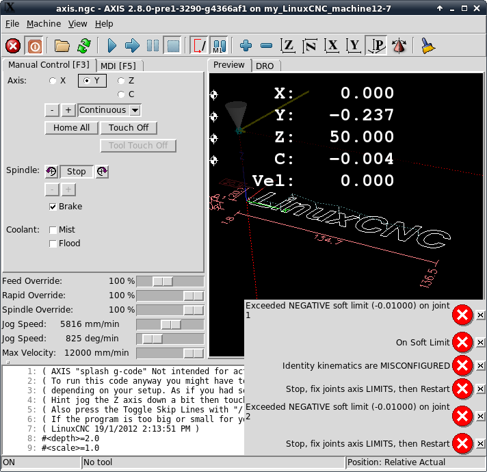

12 Aug 2017 09:34 - 12 Aug 2017 09:37 #97359
by Yannis
Hi
i manage to home the machine and after that thinks are going better but still have some problems
after i home the machine the x axis can jog until -0.10 and after that stops and that is great because it is the -x limit
and after that can jog only to the positive area:laugh:
Y axis is stop when it reach the -0.10 but after that pop up this error
i look in the INI file but i can not understand the problem
any suggestions??
thanks

12 Aug 2017 12:21 #97368
The misconfiguration may be that you have two [AXIS_Y] sections in the INI, and the first one (which is what the system will find) does not contain any limits.
The machine has definitely gone past the limits as far as LinuxCNC is concerned. Is this physically true?
It might be that the acceleration limits that LinuxCNC is using do not match the real limits, and so so the axis moved further than LinuxCNC commanded it to.

12 Aug 2017 16:52 #97387
by Yannis
Hi
i have check and the INI file of the Y and the are there
