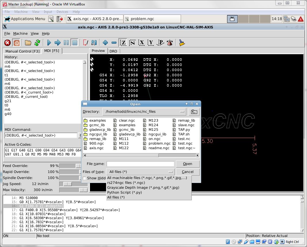

06 Sep 2017 18:08 #98592
by Yannis
Replied by Yannis on topic Gantry machine progress
Hi
as i understand the files that the linux cnc look is in the FILTER SECTION
what sud i write so it look for all files?
[FILTER]
PROGRAM_EXTENSION = .png,.gif,.jpg Greyscale Depth Image,
png = image-to-gcode
gif = image-to-gcode
jpg = image-to-gcode
py = python
[FILTER]
py = python

06 Sep 2017 18:23 - 06 Sep 2017 18:24 #98594
Replied by Todd Zuercher on topic Gantry machine progress
Last edit: 06 Sep 2017 18:24 by Todd Zuercher.
The following user(s) said Thank You: Yannis
