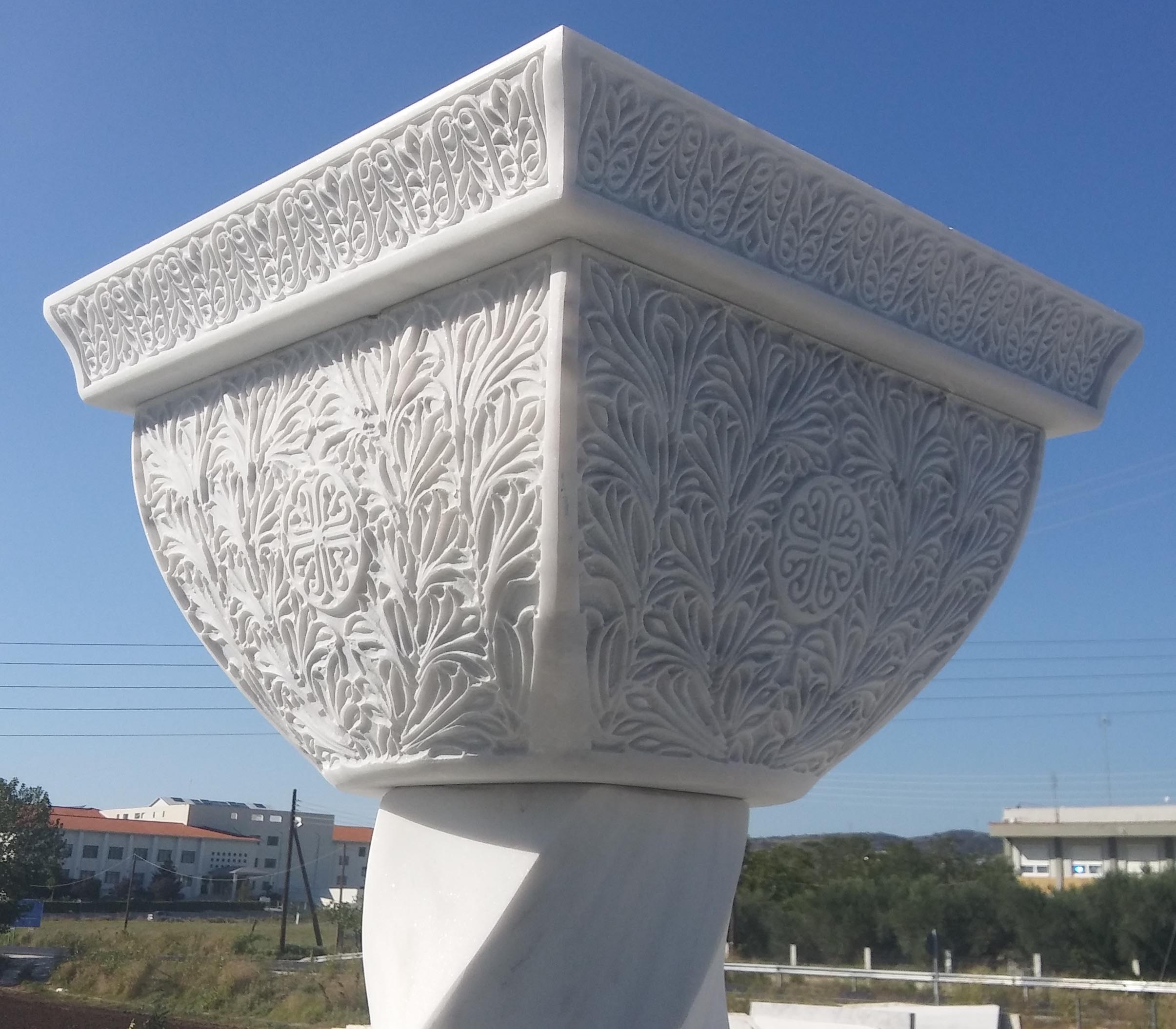

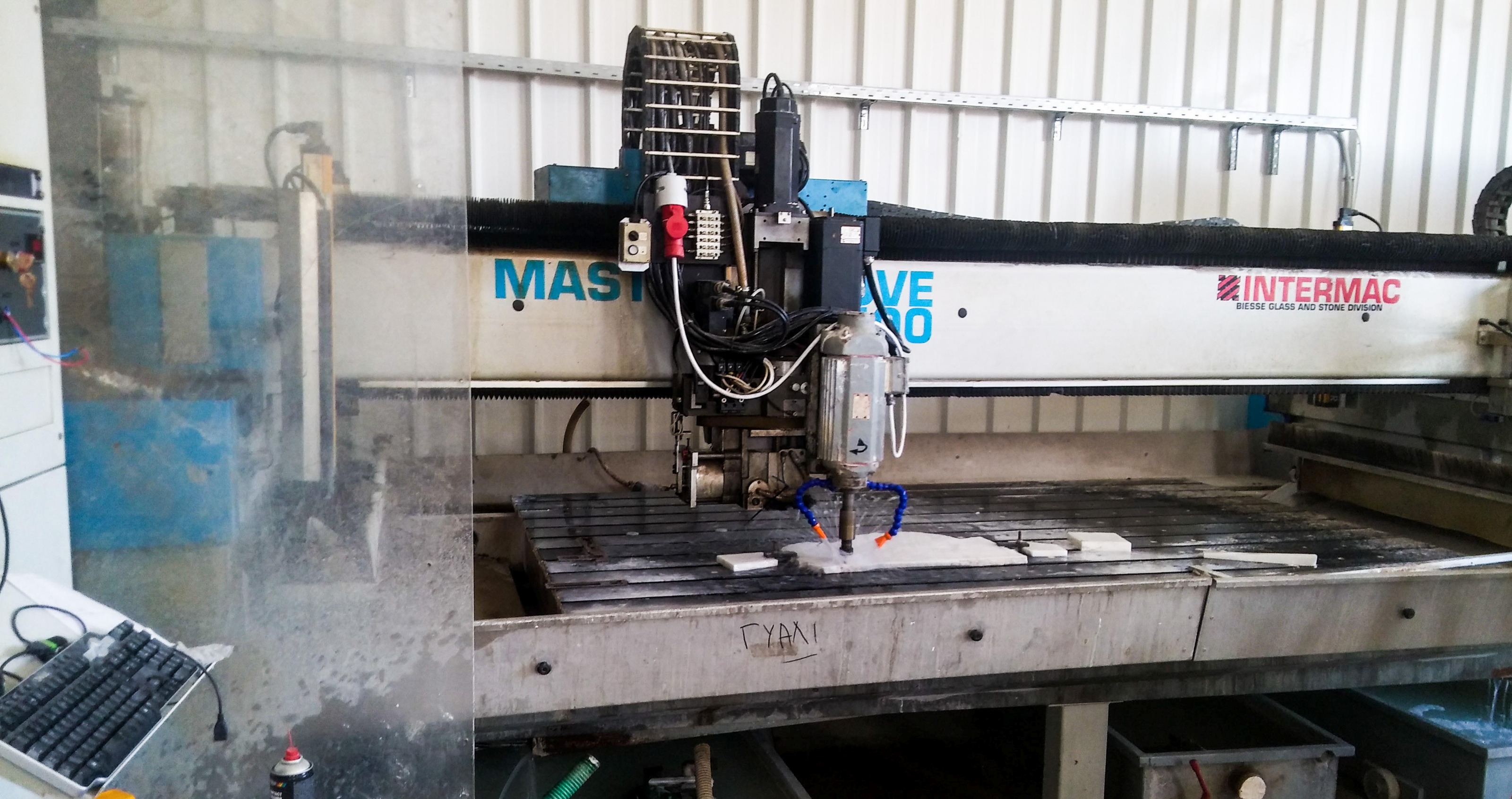

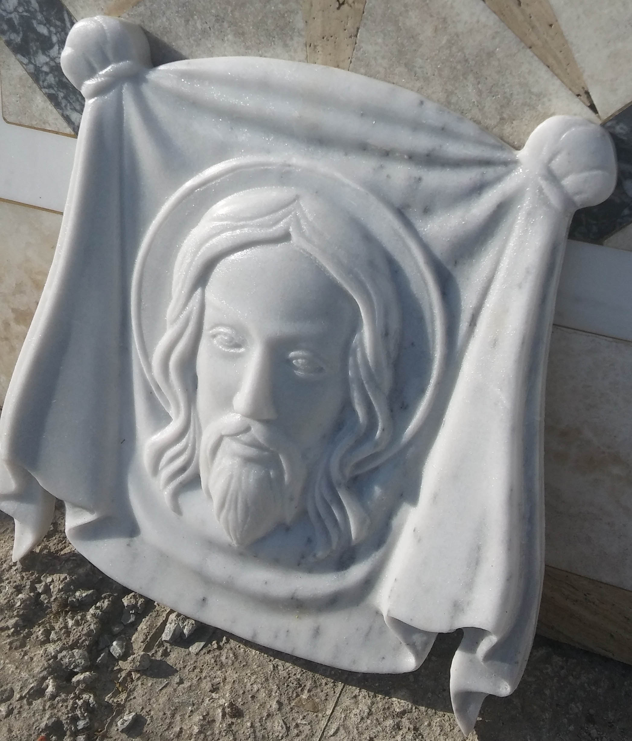

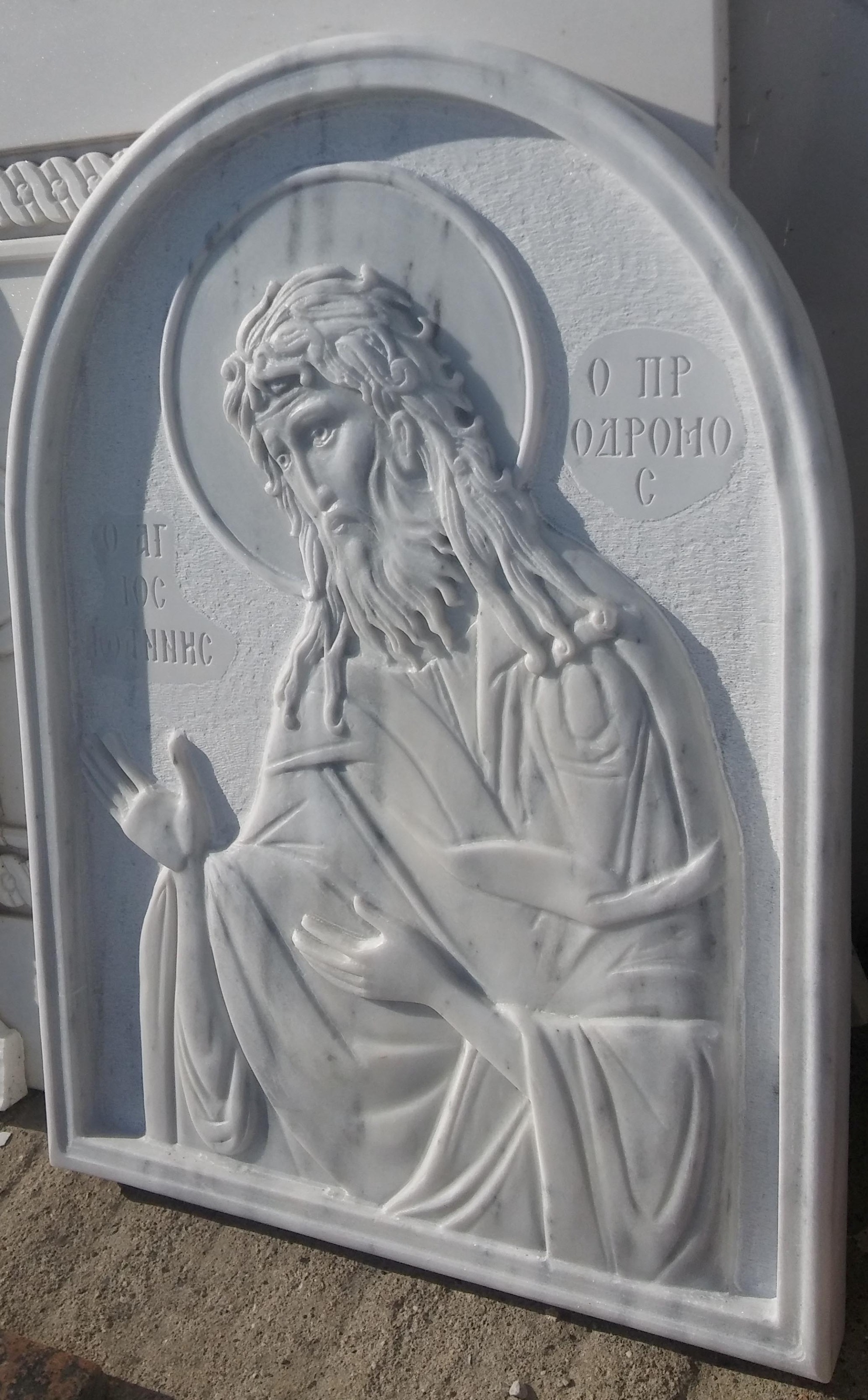

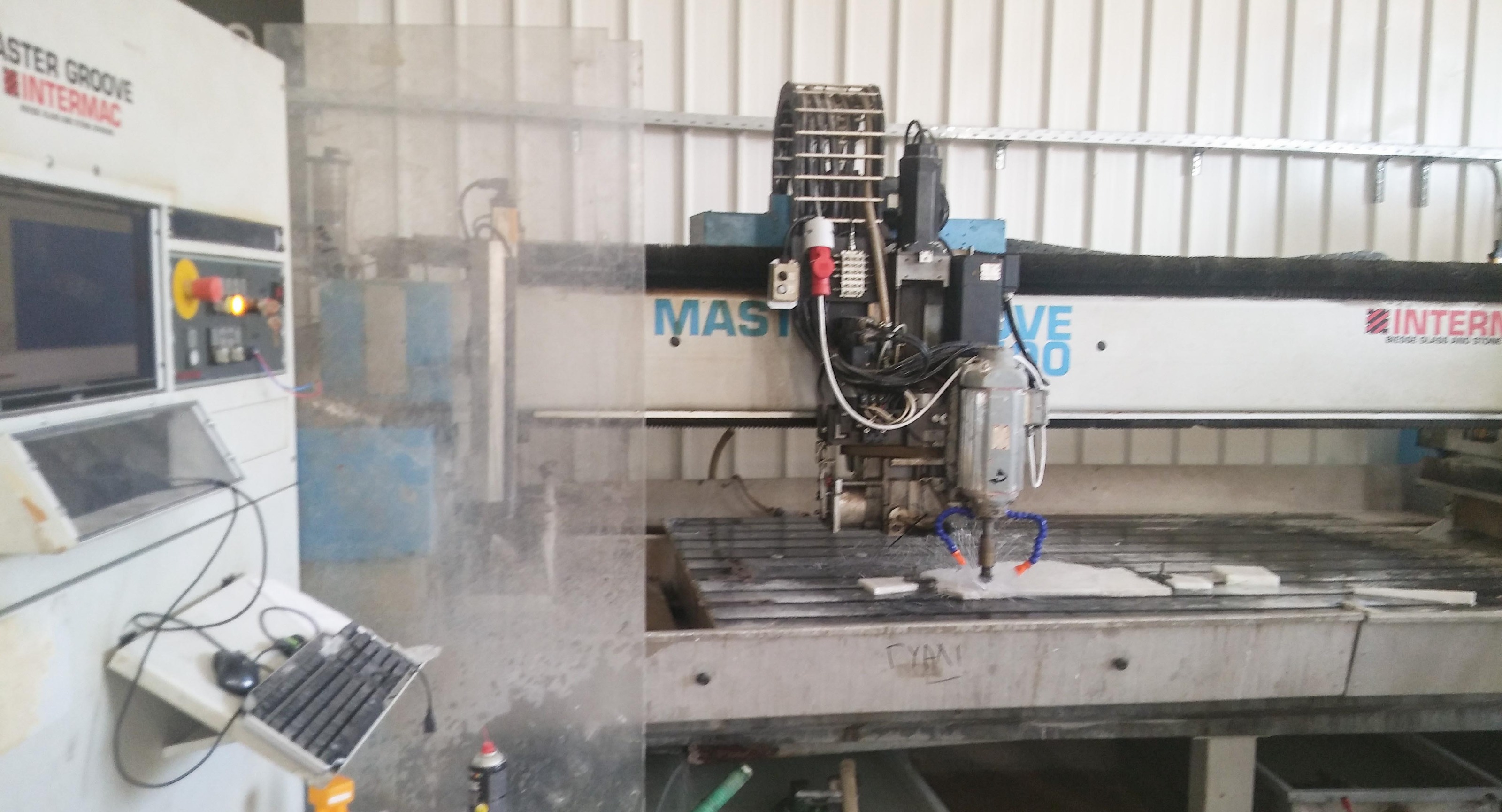

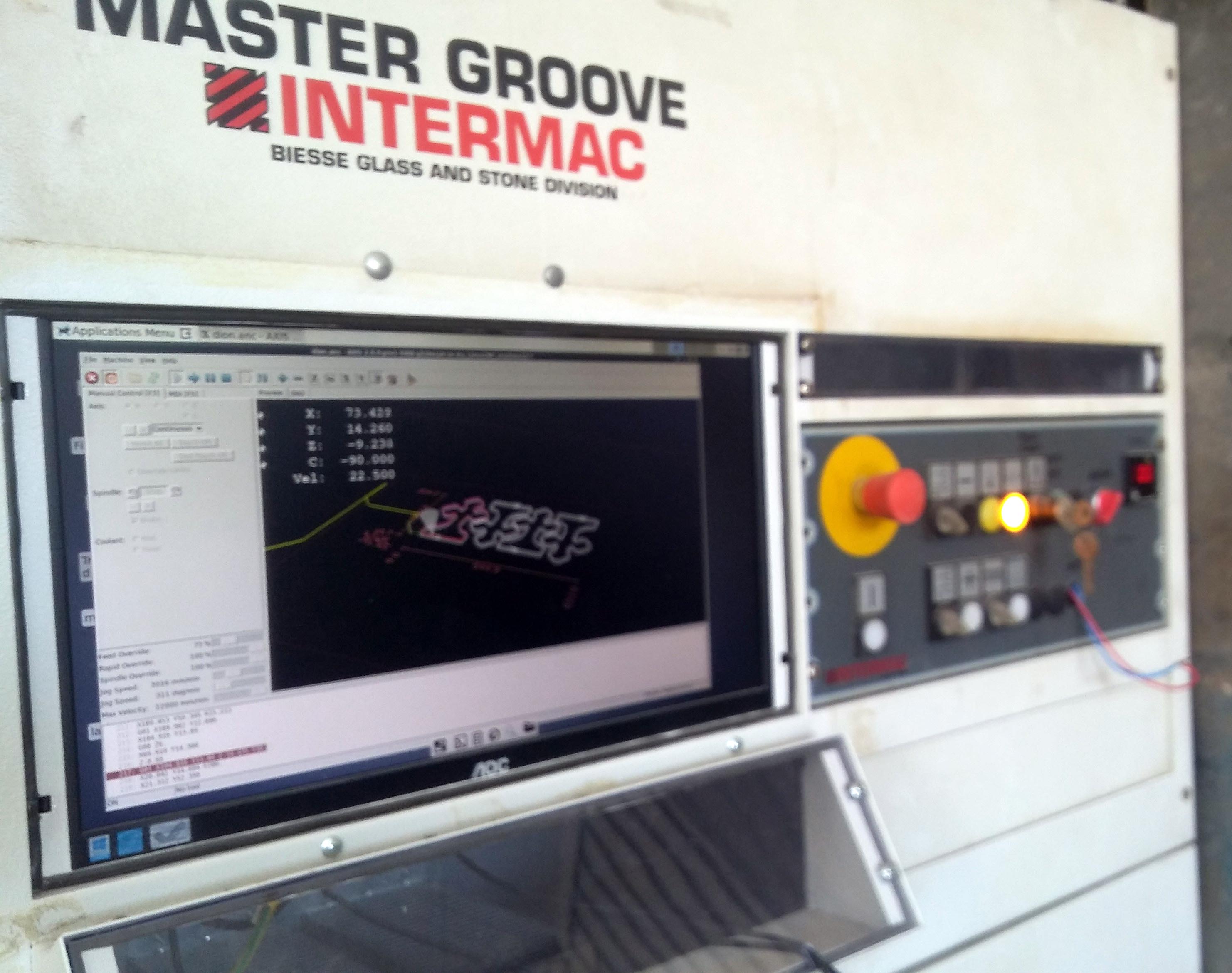

Suggestions for updates
after 3 months of questions and answers i finally start to work the machine:woohoo:
so my next question is since the machine is working sud i connect to the internet and update the linux gantry
or leave it as it is since it is working nice:whistle:
and move on
